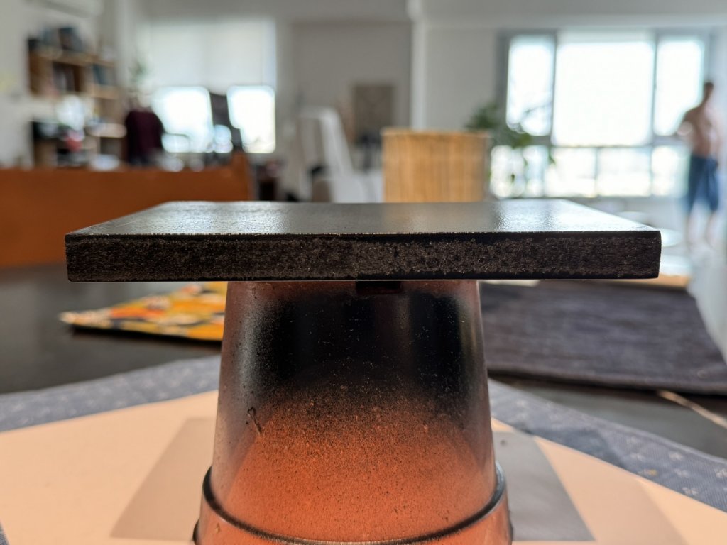

Hello @sonicjoy! Thank you so much for this amazing thread. I just placed my order for an NX-Studio kit and flat pack. But before I build it, I'm going to build a much cheaper kit from Parts Express to get a little bit of practice.
What sealer did you use on the MDF surfaces? I've tried a Krylon clear polyurethane spray can, https://www.krylon.com/en/products/specialty/clear-polyurethane-coating?bvstate=pg:2/ct:r, but it doesn't seem to be very effective on the edges (photo below) :(
Also, am curious, why do you seal all MDF surfaces inside and out?
