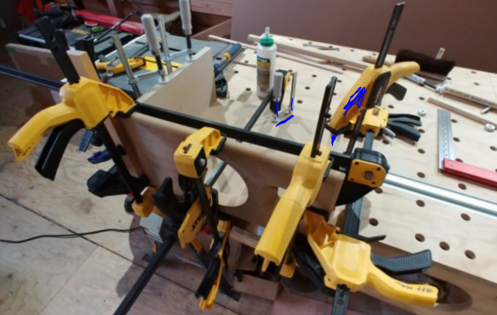

« Reply #288 on: 22 Apr 2021, 06:33 pm »
@ Sonicjoy
Thanks for the sharing of the build process. I am taking notes. :)
There is however one thing in regards to the gluing in particular clamping the pieces together. In one of your pictures there are 2 clamps that I cannot find the reason for them to be there. A grey clamp and the other is yellow (with a piece of wood not sure what purposes it has there).
Would you please explain that bit in more detail?
Thank you
Sonicjoy
  • Posts: 366
Re: Sonicjoy's NX Studio build. With photos.
« Reply #289 on: 23 Apr 2021, 12:38 am »
Sure. The gray clamp on the left that you marked is just holding the whole assembly to the table, so it doesn't move. The one on the right is clamping the angled top plate down. You always want all mating joints to be clamped together thats why so many clamps as I was gluing up several parts at once. Hope that clears things up.
Good luck and have fun!
gringo117
  • Posts: 15
  • Keep on keeping on
« Reply #290 on: 23 Apr 2021, 07:00 am »
About the yellow clamp: That is what I thought also for the first time, that it had to be the angled top plate, but then: in this picture and also the other picture where the back is also glued on, the angled plate is not angled, but 90 degrees to the front baffle and also it is above the tweeter and not between the woofer and tweeter. So is it there just to have the front baffle exactly at 90 degrees to the side wall (that is on the bottom)? As a support and not glued, just fixed with the clamp?
I am not a woodworker nor is it my profession working with wood, it is just I want to get it right and for that there is one chance to get it right. So the saying "measure twice, cut once" applies for me very much, even if in this case "measure twice, glue once".
Sonicjoy
  • Posts: 366
« Reply #291 on: 23 Apr 2021, 01:35 pm »
You are correct. It's been awhile since I built these. Had to study the photo to jog the memory. Yes that is a temporary brace to keep the side and front square while the glue sets up.

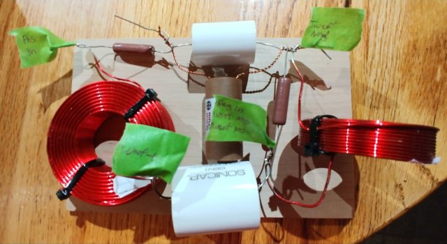

Hi Sonicjoy, and anyone who could verify for me.
The wiring for the crossover layout below.
The upper left is for positive input.
The upper right is for tweeter negative
Lower left is woofer positive.
Lower right is negative input/ woofer negative/ tweeter positive
Hobbsmeerkat
  • Posts: 2741
« Reply #294 on: 12 Jun 2021, 01:41 am »
That is correct!
« Reply #295 on: 12 Jun 2021, 01:46 am »
Sonicjoy
  • Posts: 366
« Reply #296 on: 12 Jun 2021, 02:12 am »
Thanks Hobbs, you beat me to it. I also posted this in the sticky thread "Crossover Assembly 101" on page 10. Maybe some more info there.
