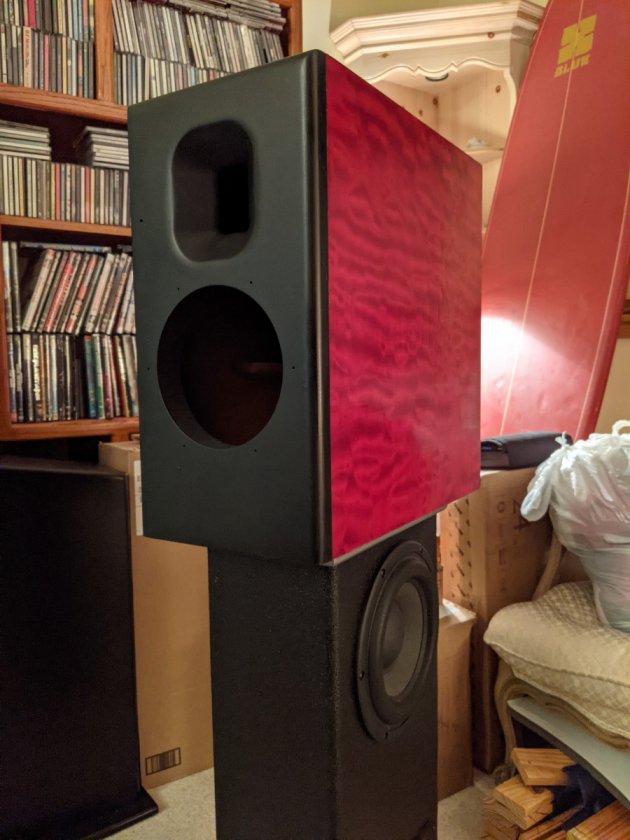

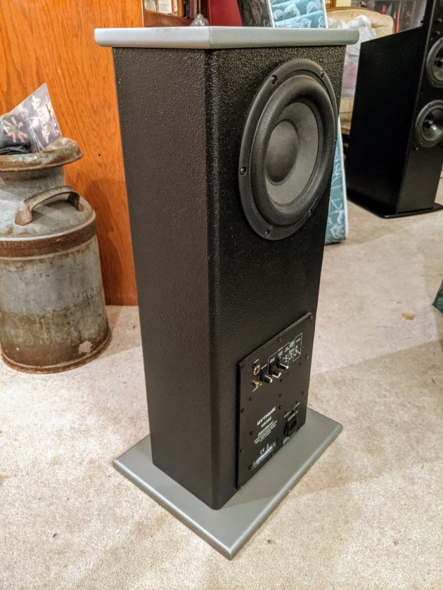

If you mean sub stands like these:
They aren't available anymore unless Danny decides to restock the 8" subs & the HX300 amp (which iirc is currently being replaced with a newer model) i got mine already assembled from Danny.
However, I'm my experience with them so far, they work best in small/medium size rooms. In large rooms they tend to fall a bit short.. but they are incredibly fast and detailed! The Dual 12" H-Frame towers will have MUCH more bass authority and presence in larger rooms. Tho not as easy to hide as a setup like mine.
I think someone *did* build something similar to mine with the 12" drivers, but it was intended for the Wedgies, using a Neo3 & 4 LGK drivers, making for a very narrow naffle.
Alternatively, the Rythmik L12 is a great sub, and since its sealed should have no issues blending in with the Studios.
I, like many others, am still waiting for availability on the NQ drivers, but I'm excited to get this build finished by April if all goes well.
Ill also be getting back to my build thread once the kit arrives so others can follow along. :thumb:

I run a pair of these http://www.rythmikaudio.com/FM8.html.  They provide output equivalent to a single 12” but go higher.
They sit at 20” high.  I use them as 68 lb speaker stands with an Isoacoustics L8R200.  They only have line level inputs, but it is simple to knock together a voltage divider to run them from speaker level.
