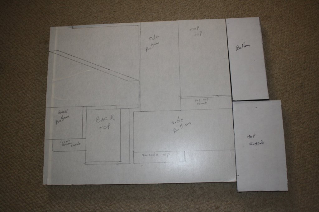

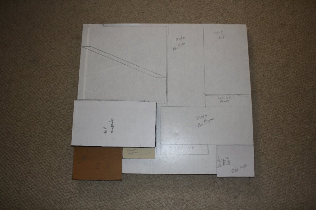

I just did dry run on the no-rez and Sonicjoys lay out might work for him but they didn't work with the flat pack.
mikeeastman
Re: Sonicjoy's NX Studio build. With photos.
« Reply #241 on: 5 Sep 2020, 12:53 am »
Here is the way I laid it out the No-rez, I had the luxury of 2 extra 12"x12" pieces of no-rez so I didn't have to piece any of it together. I also did a layout with out the extra pieces, you will have to piece the 2 back pieces in this layout with just enough left over to fill in around x-over.

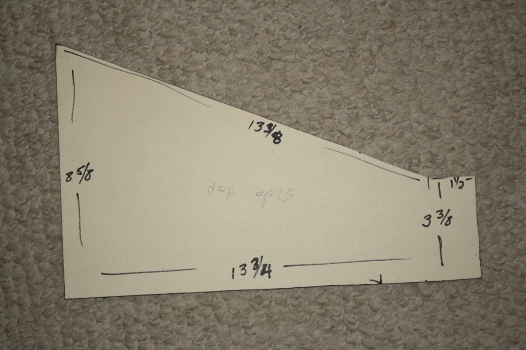

 Here is a pic of the template for the top sides I used, I added the little bump out to fill the space in front of the brace on the final layout.

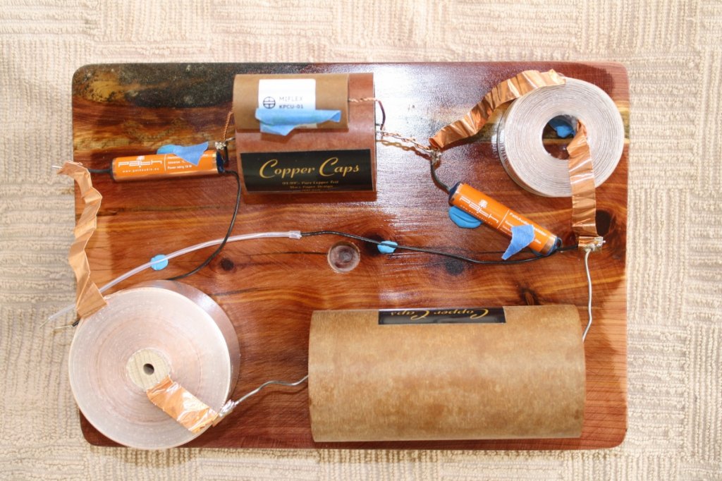

Started on cross-overs first one soldered but not glue to board yet, though I'd check make sure all looks good.
Boy this is a heavy cross-over nearly 11lb with the wood plank it's mounted on.

I cant get over the size of that copper cap...  :lol:
Im guessing this is going to be an external crossover?
Gloriously over the top!  :lol:
Thanks for sharing the process with us, looking forward to seeing the results and reading about how they sound.

So, no one spotted that the big cap was backwards, realized it when I assembled second cross-over.  :duh:
Argoncat
  • Posts: 73
« Reply #247 on: 22 Sep 2020, 04:41 pm »
Backwards??  I only thought electrolytic capacitors had polarity.
