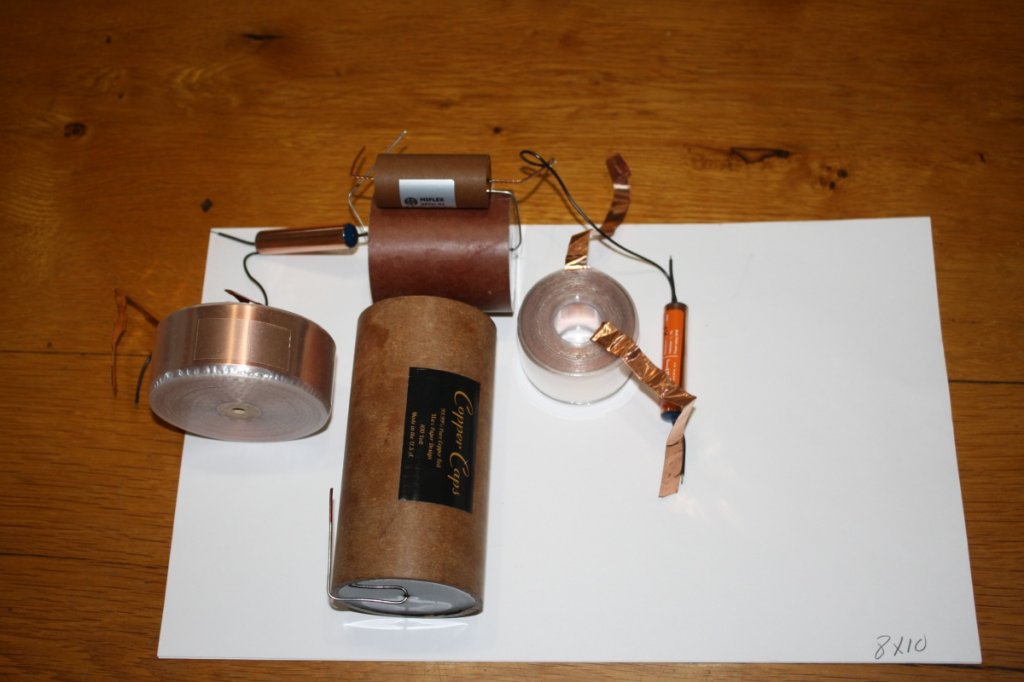

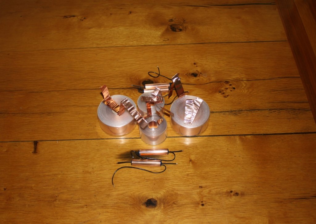

Received the upgraded resistors and foil inductors for the NX Studios, between them and  the copper caps this is going be a heavy and big X-over. Glad I'm not going to have to put these in the speakers.

Foil inductors & path resistors, I'm guessing? That's probably the way I'm planning on going with my kit as well. I would love to go with all Miflex Copper caps, but they're too far outside of my price range & physically too large IMO, so they'll just be for bypass duty & use Sonicaps instead.

mikeeastman
Re: Sonicjoy's NX Studio build. With photos.
« Reply #230 on: 3 Sep 2020, 12:36 am »
Danny said he was going to send out my kit last week, I heard nothing so figured he got busy. Surprise UPS show up with my kit. :angel: Thanks Danny.
I did a dry run on the X-over. with all the parts as close as I could get them they required 8"x10" space at best with the no-rez you have 6"x 11" maybe.
On the second dry run with the spacing I like it was 8.5"x 12.5"
Early B. I'd say no way.

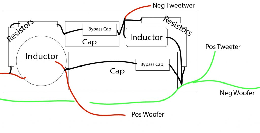

Argoncat
  • Posts: 73
« Reply #233 on: 3 Sep 2020, 07:21 pm »
Just so I'm clear -- will a fully tricked out crossover (Danny's copper caps, foil inductors, Path resistors, etc.) fit inside the cabinet or will an external crossover be necessary?
It will fit..  I built it over the weekend, all installed on a 5"x12" mounting board and fit nicely (albeit snug) in the NoRez lined cabinet of the NX Studio..
mikeeastman
« Reply #234 on: 3 Sep 2020, 07:58 pm »
Argoncat you were Houdini in your last life. :thumb:   Thanks for the X-over diagram very helpful.
