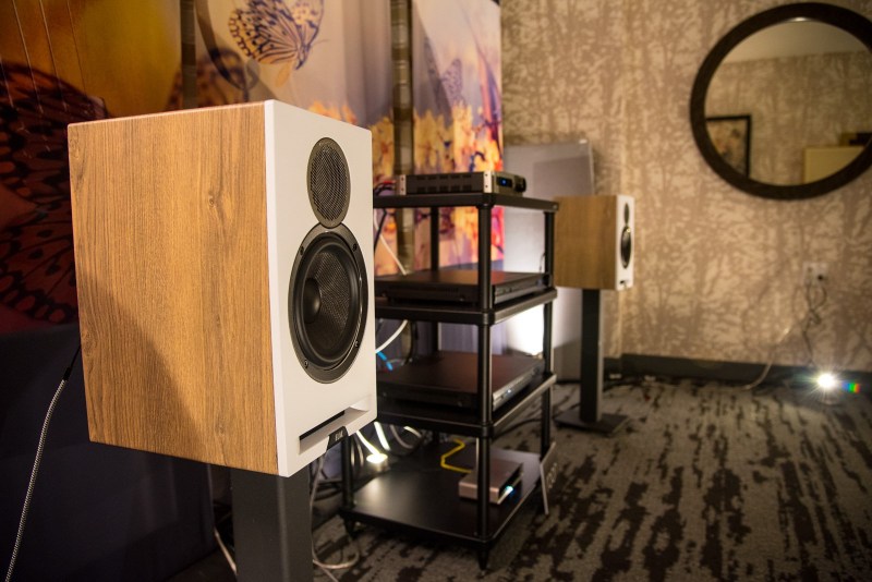

Tomy2Tone
Re: Sonicjoy's NX Studio build. With photos.
« Reply #153 on: 17 Apr 2020, 06:30 pm »
The new Elac Debut Reference cabinets is the look I kinda have in mind depending on what wood I go with. I will have the rest of the cabinet walls the same height as the baffle.
