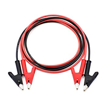

Yep, you build your crossover with alligator jumper wires.  Get a pack from Amazon, because you'll need several.
Take some time to get used to taking measurements- there's a learning curve.  Danny Richie of GR-Research
may have a video on his approach to measurements.  If so, watch it and learn.
Like Rich, I've built or supervised lots of speakers--- 50+ pairs.  It's begins to follow a pattern after a while.  You may find some designs using the same woofer.  If so, you might be able to use their crossover as a starting point.

I have bundles of alligator clips dangling off of my audio rack and other places.  :lol:
