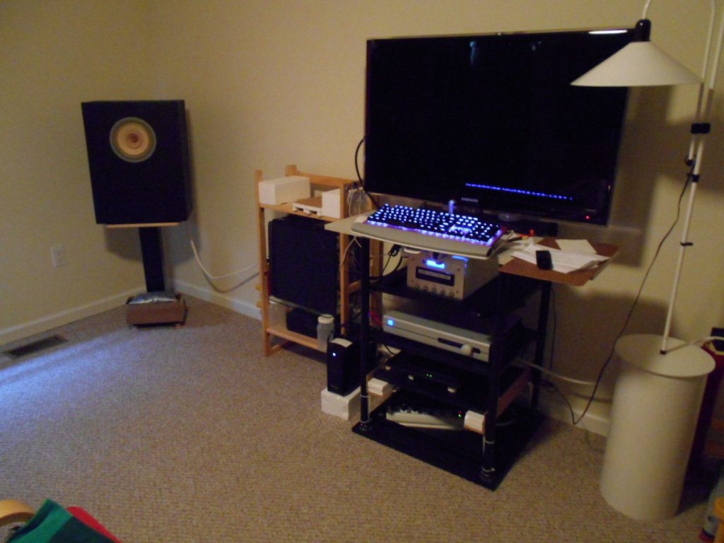

I have 50 hours on these so far.   Soundstage started as excellent, and has improved.   Tonality and dynamics started as very good, and are now approaching excellent.  The photograph shows the speakers in a temporary setup for burn-in purposes.   I only occasionally have a desire for a bit more bass.   The speakers will eventually go in to a smaller room, on taller stands, and with a placement close to corners; I expect ultimate low frequency response to be less of an issue here.

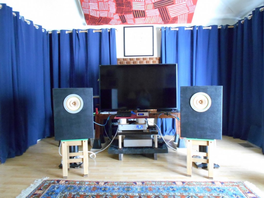

The speakers have more than 200 hours on them now.   There were minimal changes over the past 80 hours.   Tonality and imaging remain excellent.   A no-fatigue sound.   The speakers are now on taller stands, in a smaller room, placed at 45 degrees  in the corners of a long wall.   A bit more perceived bass in this location.   I could position myself to include only one of the speakers in this photo.   Probable future updates will be about amplifiers used, and possibly also addition of a pair of powered subs.   Stay tuned.

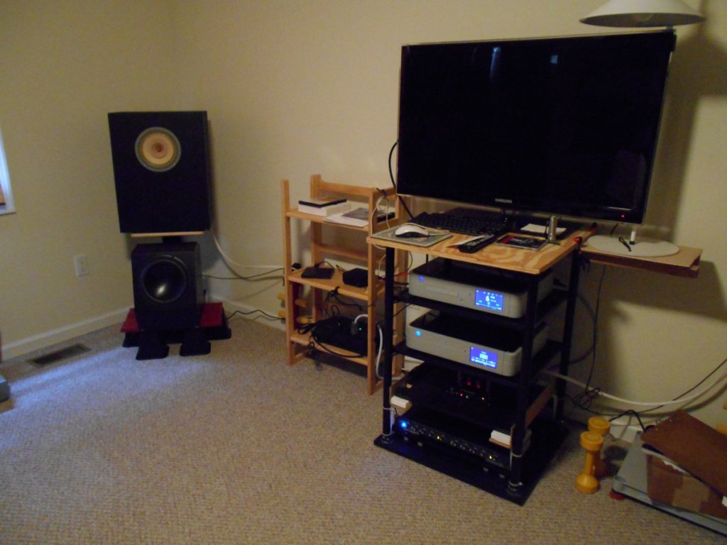

Those of you who have played around with audio for any length of time know this to be true: equipment accumulates.  Some of this accumulation will now be unboxed for experimentation.
These speakers were, from the start, powered from a Parasound Zamp v.3, at 45 wpc. within the rating of the drivers, giving a clean and fast sound.  The overall performance  of the system was obviously limited by the limitations of the Fast 8 in a sealed box.   The first addition was a pair of Gallo Classico CLS-10 powered subs.  The Zamp has jacks for signal passthrough, and this is where I connected the subs.  The Fast 8 still run full range, and the subs are set for a 110 Hz crossover frequency.    On the plus side, this filled out the frequency spectrum nicely.   On the minus side, integration was not the best, as these subs were not up to the speed of the mains.   Next out of it's box was an Ashly  XR-1001 stereo 2-way analog crossover.   I could now use balanced interconnects out from the DAC to this crossover.  XLR to RCA adapters at the outputs were used for the interconnects from the crossover to the Zamp and to the powered subs.   Crossover frequency was set to 110 Hz, and the sub amps were set to bypass the internal networks.   This is now much better.   The Fast 8 no longer see very low frequencies, and the remaining range is more clear and effortless.   There remains the problem of the synergy of the mains and the subs.
