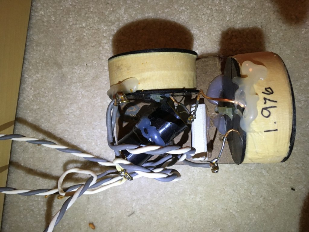

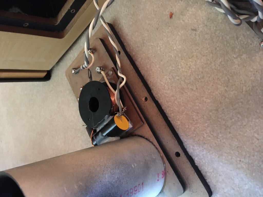

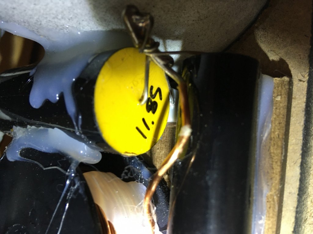

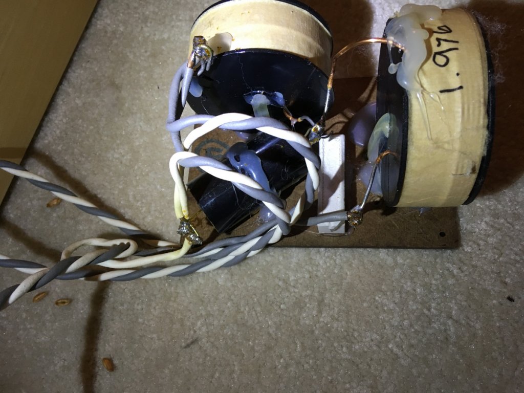

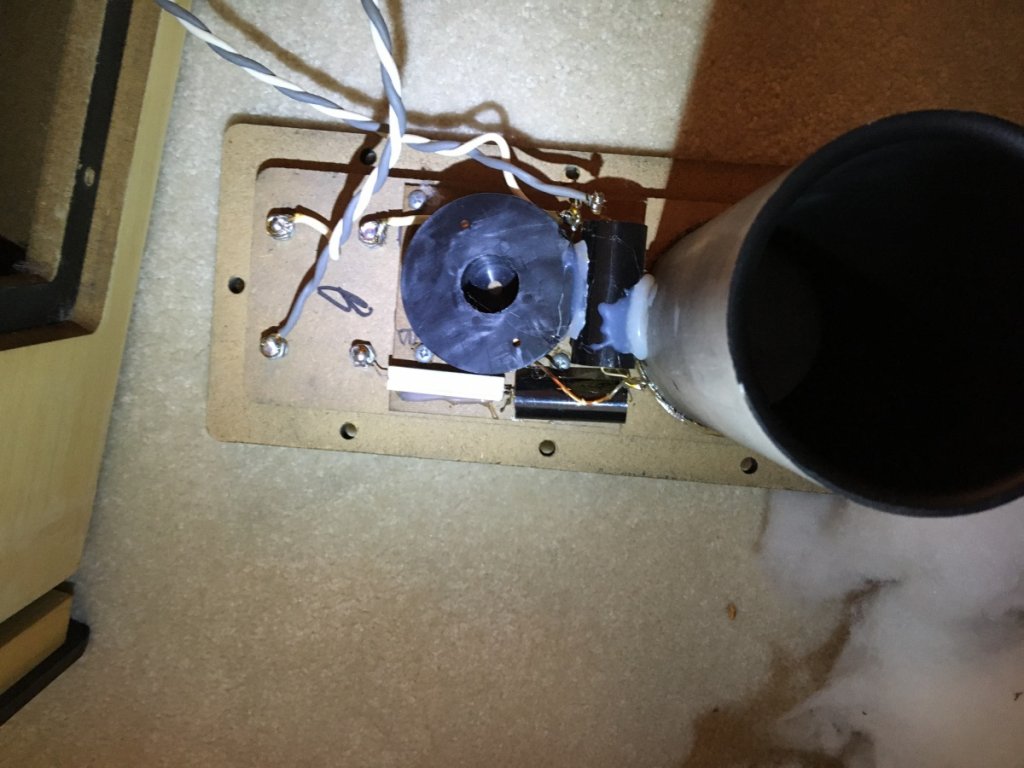

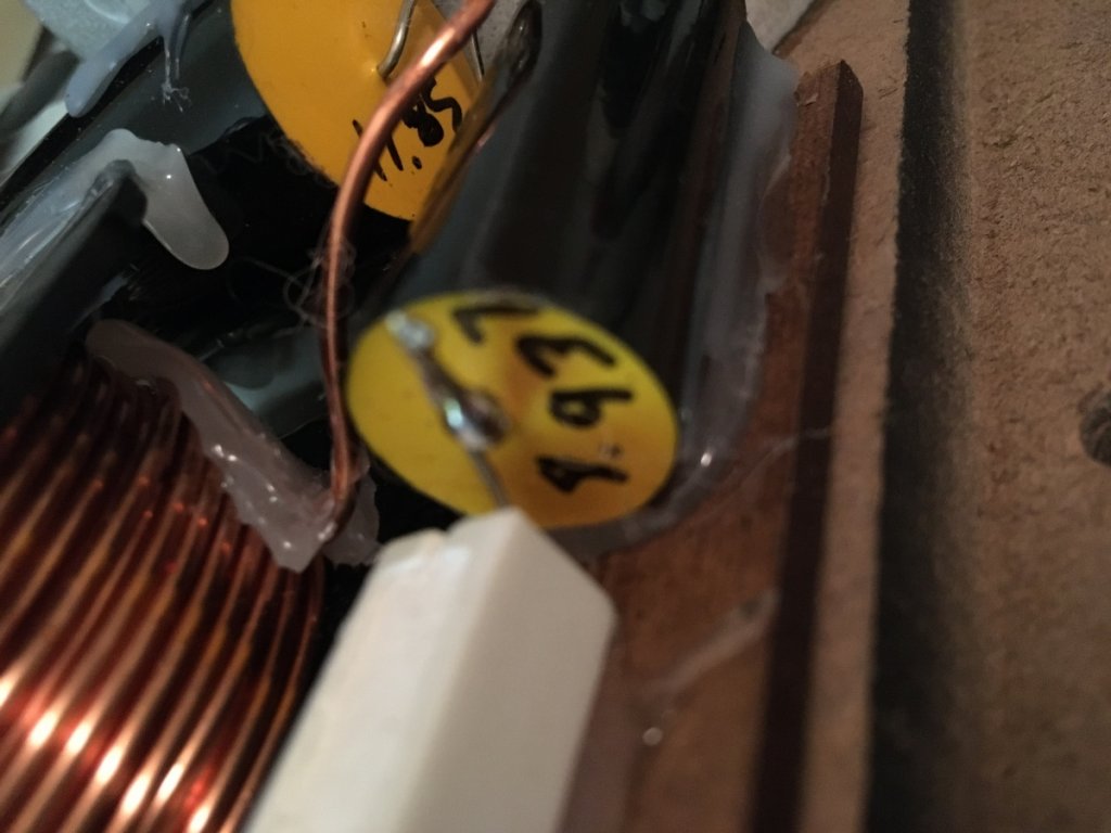

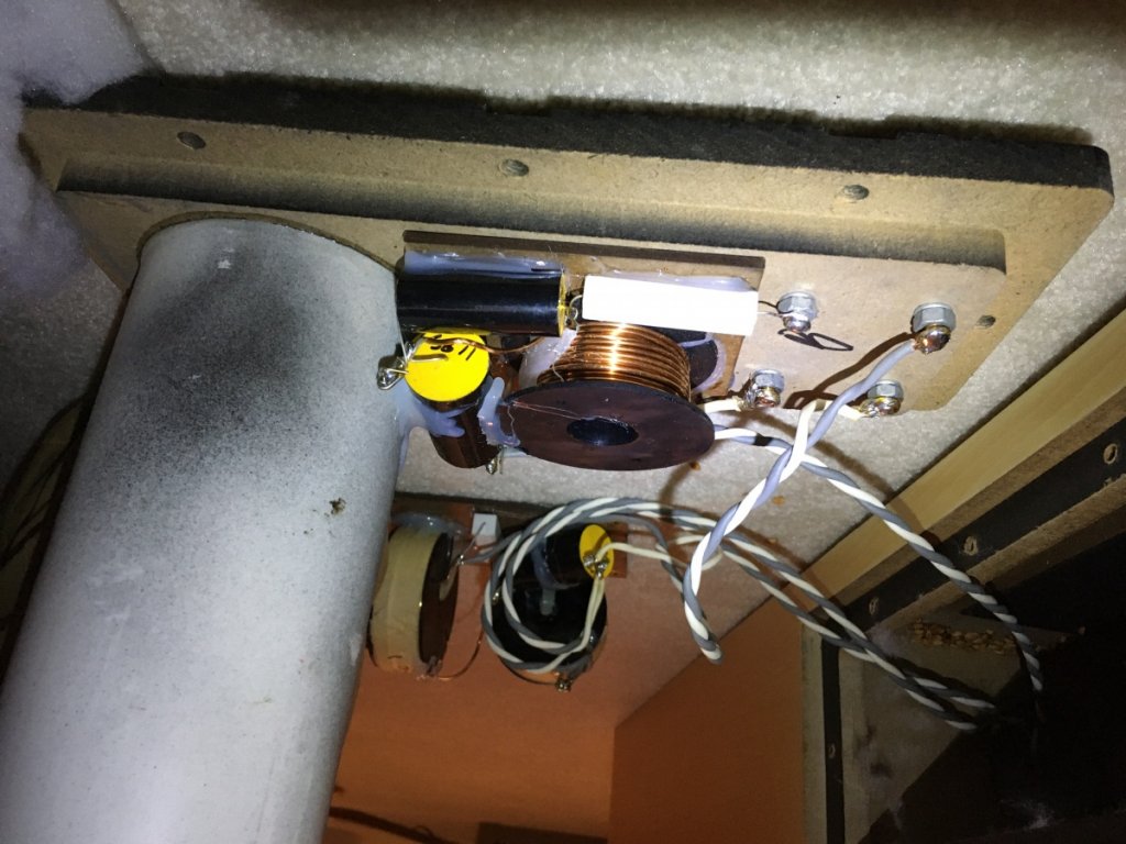

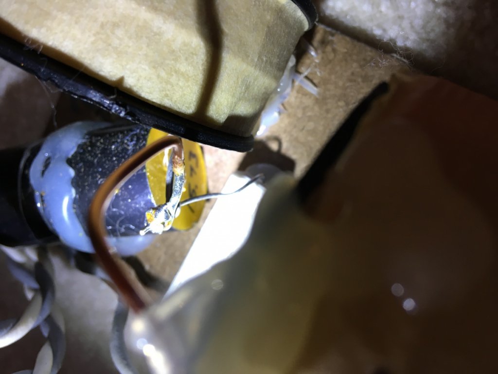

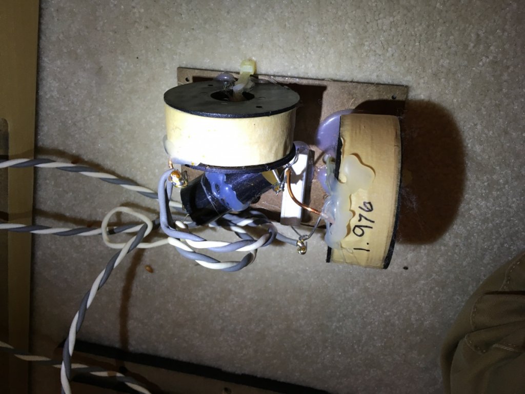

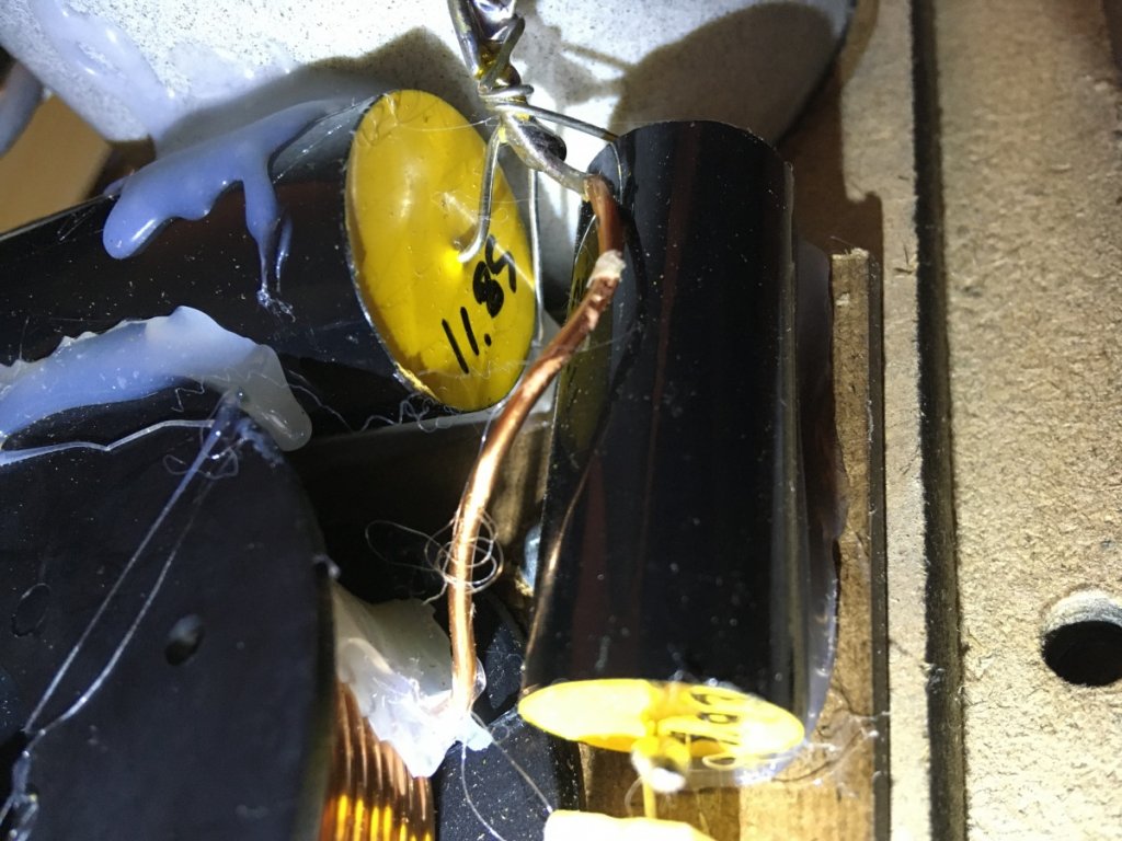

Thought I'd put up some photos to illustrate.

Those all look like film caps to me and while they could vary a little, are probably okay. The black numbers on the yellow ends looks like the actual measurement of each cap before they were installed. You could disconnect one end of a cap to take it out of circuit and measure the capacitance across it with a meter to see if it has fluctuated from the original. For instance, the cap that says 11.85 was probably a 12uF cap.
Good luck.
