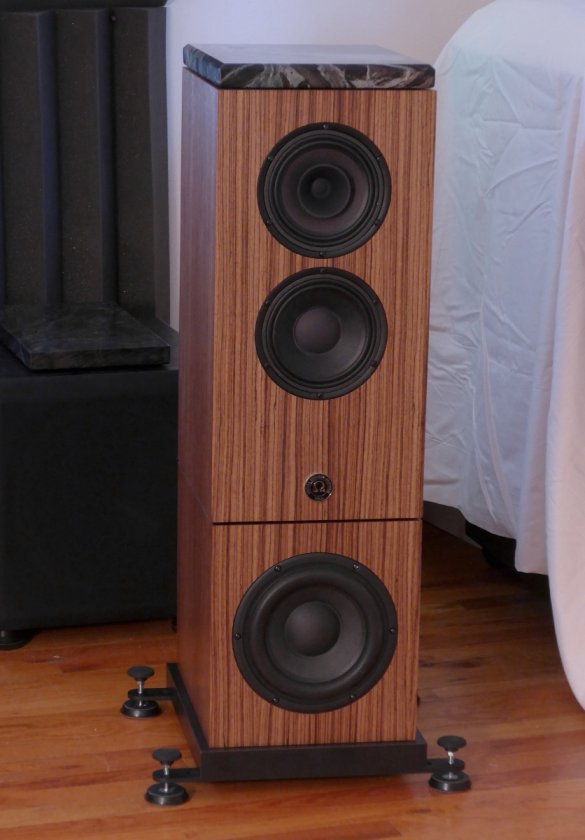

Voila! (SAM HO's with Rythmik F8 mid-woofers and plate amps in custom boxes Louis artfully made to match the SAMHO's)
Probably considered poor practice, but working fine for me:  Inspire amp from one pair of preamp outputs.  The other output pair split and sending signals to mid-woof and sub-woof.  All is doing fine.
However, I am thinking of returning to have the mids and subs fed by my DAC in preamp mode and the Inspire pre only feeding the main amp.  That would give more flexibility in the relative levels between the three elements.  I will set the levels separately in sub amps, mid amps and preamp while controlling overall volume with the DAC.

Pete, it looks absolutely fantastic! Thanks for the picture. The current model F8 appears to have two drivers and is 20" tall, perfect height for SAM. I'll need to reach out to Louis and ask about the cost if were to order a pair of passive units and see how far I need to extend my budget.  My brother in law lives 10 minutes away from Norwalk and about hour and half drive from where we live. I could stop by Louis's shop on the way to their house.  :green:

Sorry, but those aren't subs below the mains.

@pstrisik. Not subs????

No, Rythmik F8 mid-woofers in Louis' custom cabinet.  I have a pair of Rythmik F12 subs behind them - you can kind of see in the photo.
