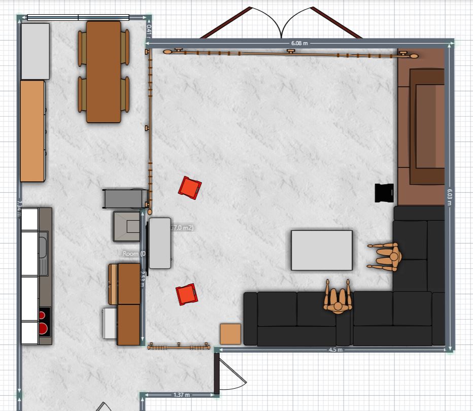

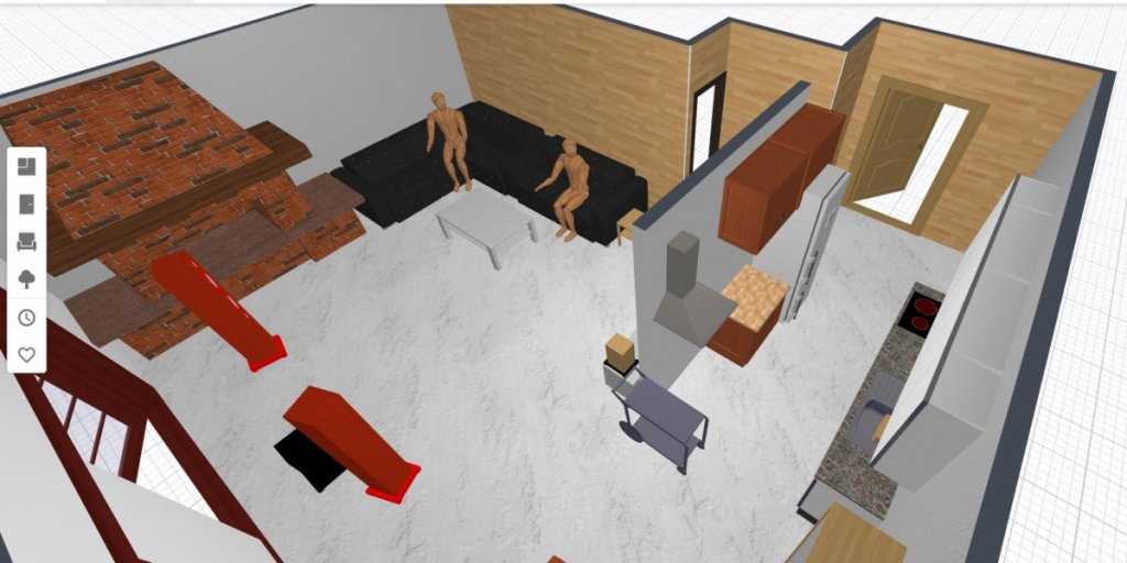

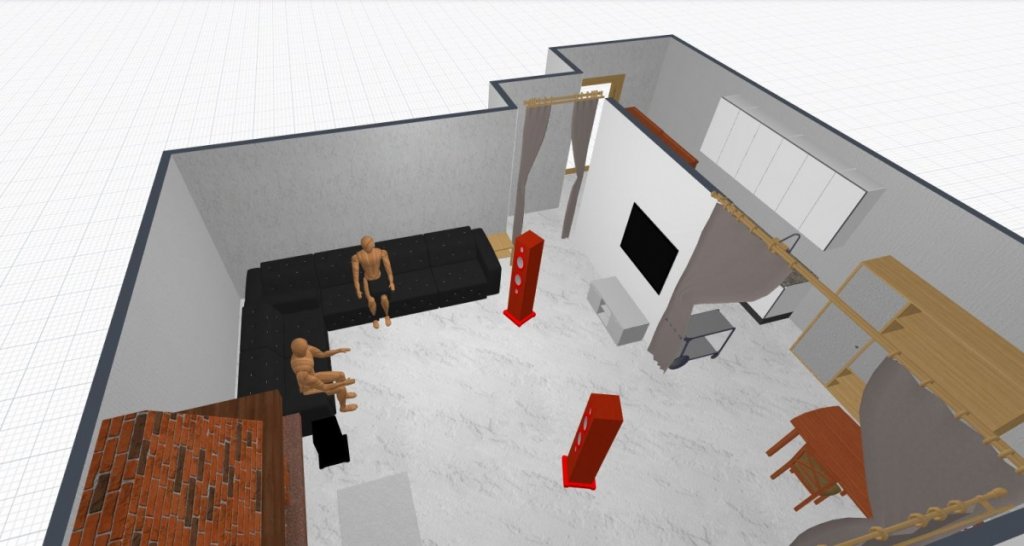

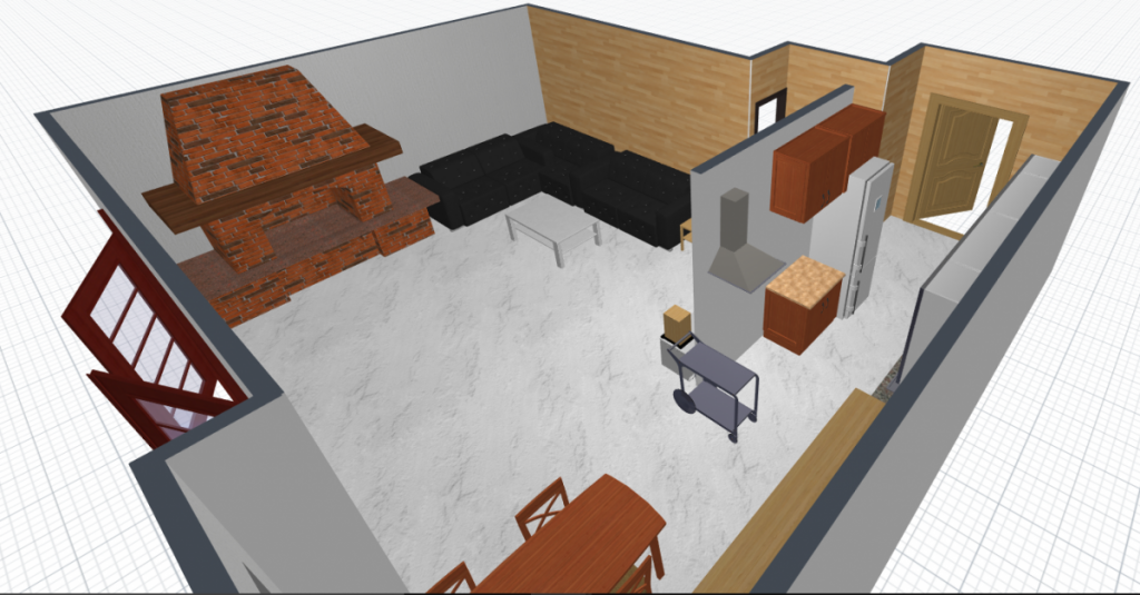

Hello,
I'd like to get some advice on the new layout I am designing as I am going to upgrade my old system.
Here is the current room configuration:
My hardware is quiet rudimentary but I do like it for the price it cost me.
- PS Audio GCHA DAC + Headphone Amp
- Integrated Amp Cambridge Topaz Sr20
- BW Bookshelf  speakers (686) mounted on laptop stand
I use it mainly for TV, Electronic music, Soul, Hip Hop
I like the speed of the bass, the sharp detail in the high frequencies.
It's a good system but the caveats are they are not giving any soundstage, lack of mids at low levels, that sounds boxy, it's difficult to listen for a long period of time, that becomes fatiguing as they are quiet bright, and the speakers need to be pushed at a high volume to be able to listen to all frequencies properly, which ends up by turning it down after 5mn.
On the room conifguration, the speakers sounds like they are 2 km away when on the sofa, so we have to push the volume, but then it's too loud, and overload the room.
My intention is to have a different setup for music listening because I can't move the furnitures.
I did prepare the living room by selling some furniture and getting some more room near the sliding glass door.
I will be adding some velvet curtain soon to attenuate the effect of the glass on the sound, and then find some good tower speakers that can spark some magic in the room even at low volume.
I went to a couple of shops, got some demo of 4 / 6000 $ high end system, but I was really disapointed, I thought that it does not worth it for the money you spend, I'd better pay for a trip in a festival and get acces to 10 concerts. the systems they had was just not that far from my BW 686, it didn't really make me feel anything special.
Same thing with Headphones, I got a Focal Elear on Sale, that is a very good pair, but to get a 10% improvement you are looking at 4000$ for headphones... seriously... not a really good way to invest money !
My conclusion was that in order to get to a system where you can say ''Oaw... this is really amazing'', you have to invest 20k or you have to know exactly in what you are investing to maximize the returns, including the room.
Long story short, the option I am reviewing right now (but not limited to) are:
- Tekton DI
- Magnapan (open baffle)
- NX-Otica (open baffle)
Let me know what you think about this project and from your experience what couldd possibly be the cheapest way to improve the system (including the room) to a level where you can enter the living room with your family, turn on the stereo and make everybody dance and/or listen to appreciate the emotion filling the room.
Note: I can't move the Sofa from the rear wall.
« Last Edit: 28 Jan 2020, 02:17 pm by Zitoun »

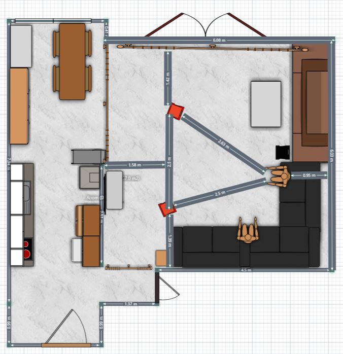

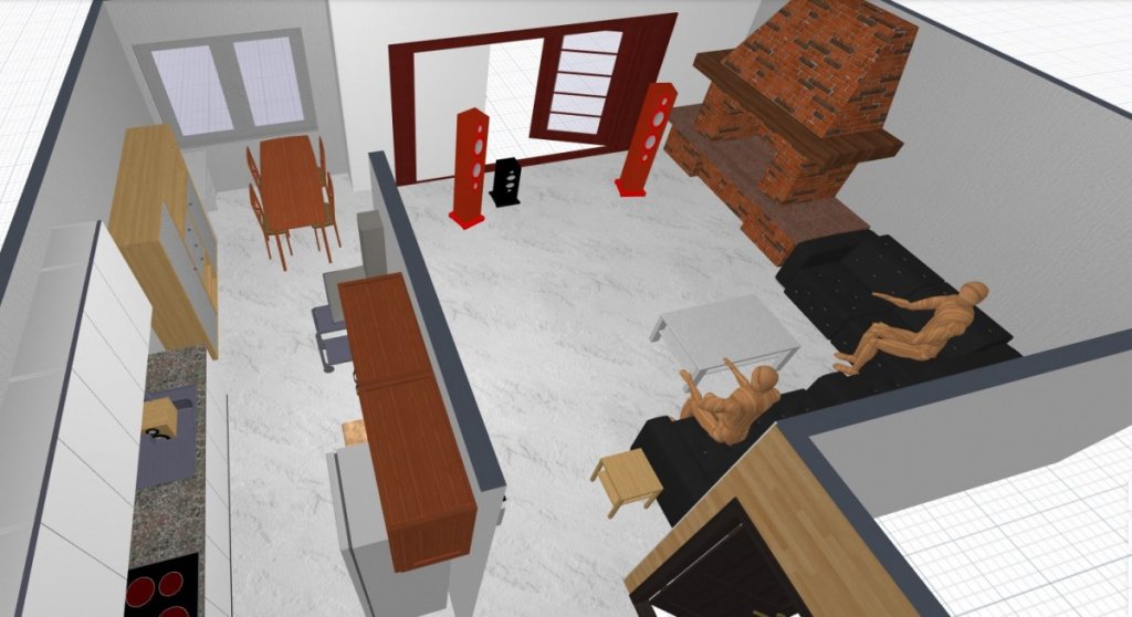

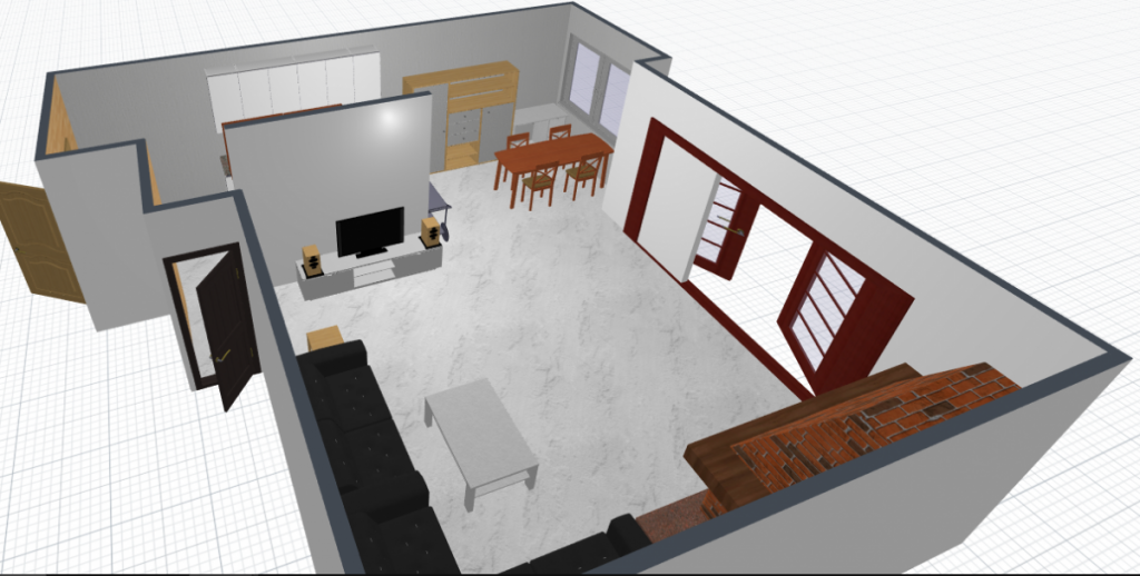

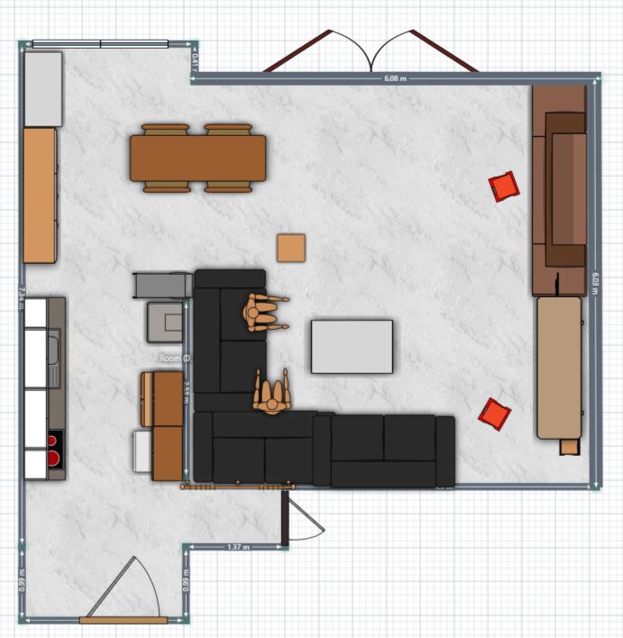

Hello thanks for the questions Anand
here are some answers:
Current BW placement: on the side of the TV
Listening position on the sofa see below (may have more than 1 listenener)
In red the location of future new speakers
Measurements
Construcyion of wall: plaster
Contrustion of floor: wood
Consstruction of ceiling:wood

« Reply #4 on: 28 Jan 2020, 03:16 pm »

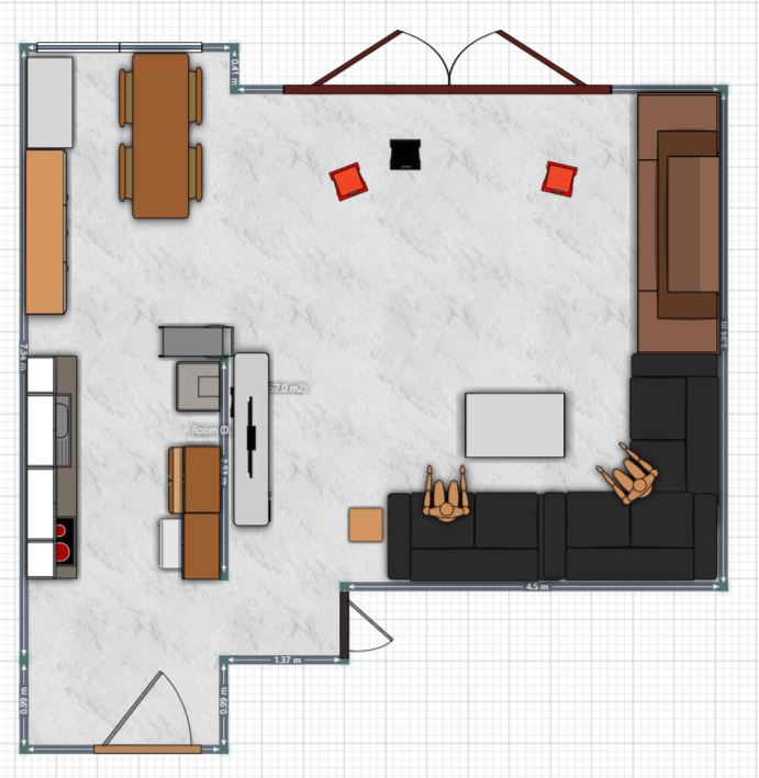

Have you tried moving your speakers to the proposed locations?  It would help open up the sound stage.  Note that the ideal location under this concept would be to pull them roughly 1.5 meters away from the French doors.  And regardless the coffee table is bad for floor bounce.  But I envision several problems with the proposed locations:
1.)  Very low spousal acceptance;
2.)  Would block access to the French doors;
3.)  Would block the view out of the French doors;
4.)  Would be very disconcerting for listening through them to the TV;
5.)  No apparent good way to run the wires to the speakers;
6.)  Placing speakers in front of large amounts of glass is not recommended (glass being extremely reflective).
Is that a subwoofer you're showing between the proposed speaker locations?  If so that's perhaps the worst possible place acoustically to put it.  Suggest putting the (wireless) sub behind the end table at the end of the couch.
Did you mean drywall versus plaster?  Believe it or not plaster is much harder/more reflective than drywall.
No because it will require speaker stands and the sound direction won't fit with the TV. I will basically need a new pair for the TV anyway. So that will be a waste of time and money.
I know but I'd rather keep it as a living space to share with family and friends. Maybe I'll investigate on the table material later
Already negociated  :icon_lol:
2.Only the door in the middle can open, I couldn't find the exact model in the 3d tool (for free)
3.I could simply put them aside whenever I feel like watching the neighboors would be my occupation of the day :).
4. Except if it's a dedicated pair used for music only(can setup a second pair of speaker on my amplifier with the A/B buton and output.
5. Already did that in the past sucessfully, this is not the best to have 5-10 meters of speaker wires, but I am not at the level of arguing on cables and snake oil by any mean.
6. I wil add these curtains to limit the sound reflection soon
That's a great proposition, I'll probably have to test different positions, but that will make it easier to have it there.
Not 100% sure it sounds like thicker and more solid than drywall, it's an old building, so I wouldn't be surprised these walls are filled with bricks and covered with plaster.
Thank you.
« Last Edit: 28 Jan 2020, 07:56 pm by Zitoun »

You can easily experiment with the proposed speaker locations with your existing speakers using chairs/stools for stands and buying 16 gauge bulk wire to use as speaker cable (like we routinely did 40 years ago before Monster "convinced" audiophiles that something better was needed).
Whatever you do it'll be a compromise in that room.  The speakers you listed above are large, awkward to move, and block a lot of the view.  You need to decide what kind of sound you want as the speakers you listed have completely different presentations.  Personally not sold on the Tekton midrange array or the dipole sound from your other choices, but any of your options are designed for far-field listening which your room can't really provide.  Would also suggest a whole new system to support speakers of that caliber.  Your proposed layout doesn't afford enough room behind or in front of these speakers.  Would you run that tube under the floor slab/joists?  If so, what's the point of the tube?  If running on top of the floor there are better solutions (like hollow raceway thresholds).
Again precious few effective options exist to acoustically treat the French doors, the only available acoustic drapes are heavy, ugly, expensive, and minimally effective.  The best solution would be fabric wrapped framed panels of Roxul or Owens Corning 703 that you'd move in front of the French doors when listening.  Then you'd be moving panels and speakers every time you wanted to listen and have lots of clutter the rest of the time.
It's your call, but I still like my suggestion of Amphion Argon 3S sitting on either side of the TV.  Other alternatives are the JBL 705P ($2000/pair) or 708P ($4000/pair) reference (professional) studio monitors also use controlled directivity and are active (built-in amps, one per driver).  I owned the 708P and they are some of the very best speakers money can buy.  Very dynamic, room filling, detailed, meant for mid-field listening, even have built-in DACs and room correction.  But they only accept AES/EBU digital or XLR analog inputs.  Either would pair well with the afore mentioned NAD C658 and would suggest putting them on either side of the TV.

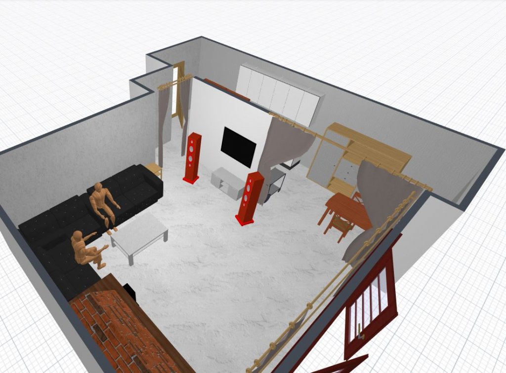

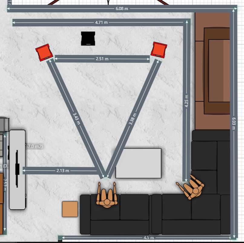

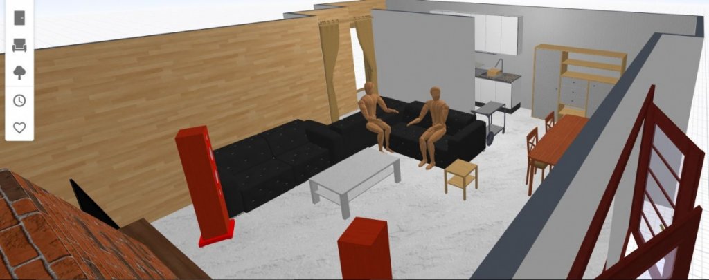

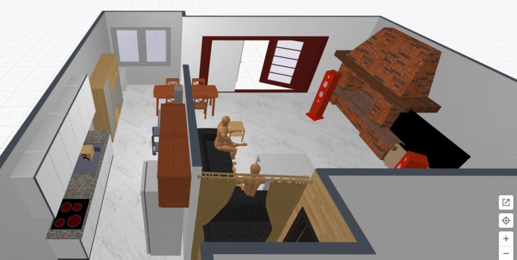

There are a lot of thoughts here,
Thanks for all of this Anand, JLM, youngho.
To summarize everything and quote JLM, the elephant is in the room, so I have to solve this problem first, as this will always be my biggest limiting factor.
Here is a new approach that must go trough the WACPA (Wife Acceptance Criteria Approval Process).
I think it solves all of the biggest issues you highlighted (symetry, Recess issues, reflection on glass, people circulation, cables, directivity of sound with TV)
- Benefits I see:
  - Less investment in treating the room
  - Can resell my bookshelves speakers (free-up some more room)
  - May not need a subwoofer in this configuration
  - Less investment in long cables/raceway
- Caveats I see:
  - block 2nd access to the corridor, but can be covered with a velvet curtain
  - the left speaker rear will face the chimney directly (that will probaly need to be treated as oungho mentioned.
Let me know if this is a good idea or not at all, before I go to the WACPA Executive Comitee !
@Anan I'll ask for the wall construction material, I'll get back to you.

I would try a diagonal setup.  In acoustically difficult or odd shaped rooms, this is often a VG way to go.
In your first pic above (reply #9) I would use the lower right corner as the speaker anchor point.  I would place the speakers across that corner and fire them towards the dining table.  In other words, the L speaker would be approx where the fireplace ends and the R speaker would be roughly where the lower person is sitting in that diagram.
You can place your gear in that corner, and cable runs would be short and not underfoot.  Also, you could still use the entryway (lower left corner) that is now blocked by the sofa, as it will be behind the speakers.
I would then place the L shaped sofa against the double doors -- forward of them so access to the doors is not blocked.   This seating setup actually makes the fireplace more useable and less awkward when relaxing in the room.
I don't know if this setup leaves enough room for your dining table....or if the sofa would block your kitchen access.  I'll leave that to you and your tape measure to figure out.  But it's worth considering.   My instincts and eyes tell me it gives you the best sonic chance in that room.  And assuming all your furniture fits, I also think it's the most liveable.
I have used diagonal setups in the past and they worked well when nothing else did.
(Sorry for the rotated image, don't know how to fix it.)
So is this case (copied from your 1st post)?
It seems it’s a variable that you are freely manipulating in your pretty 3D plots  :thumb:
I would be surprised if the couch is allowed to block one of the egresses into the kitchen even with a peekaboo curtain  :wink:
Best,
Anand.
Zitoun
Re: New Layout - New System
« Reply #12 on: 29 Jan 2020, 10:12 pm »
I meant it's a sectrionnal sofa, so you omve it as a block, and it's still on the rear wall, but a different one.
That's a very good point, and it might be a fire hazard that could potenitaly block the passage to my son's bedroom from a firefighter perspective.
You just convinved me that this was not a good idea.
.... You think audio gear is complicated ... try acoustic right !   :wink:
I will definitely forget about blocking access for security reasons, but your idea makes me think about a very simple solution as JLM mentionned, just move the speakers as you wish depending on what you are doing.
So I can keep my current layout add curtains, that I can double/triple and find nice one on the front to fit with the decoration.
Then I keep the speakers close to the wall when watching you tube or tv shows on netflix,
 and whenever I need to listen to music/movies seriously, close the curtains, and move them forward.
Simple, Economic, Realistic
With the measures I took I can also move slightly the sofa from the rear wall to have the 3 feet required.
That way I can also adress diffusion and absorption as required.
Make sense ?

Look, I think you're going to have to reconsider your assumptions, priorities, and goals. Given that your listening preferences are "TV, Electronic music, Soul, Hip Hop," you should keep in mind that there is relatively little soundstage and imaging in the recording for the speakers to reproduce. I don't mean this to sound pejorative about that, but the overwhelming majority of content should be expected to have been recorded in a studio setting or manipulated on a computer, compared to chamber or orchestral classical music, a fair amount of jazz (especially unamplified live). When it comes to electronic music or hip hop, I don't know what "the feeling of being there" means, since there is no "there" there (sorry, Gertrude Stein), but it sounds like you're looking for a different approach than most so-called audiophiles, so it may not be surprising that you haven't been impressed with your visits to local shops. For studio recordings electronic, soul, and hip hop music to sound even a little like what you've heard in in colosseums or old factories, you're going to want a surround system with subwoofers, as well as DSP and up-mixing.
Not to be pedantic, but to criticize your simple, economic, realistic approach: speakers close to the wall will sound bass-heavy if not designed for that position (or in this case, the left will sound different than the right), curtains are not full-range absorption, pulling the out as you propose will have the TV off-center and the right speaker will still sound different than the left, sitting close to the wall will still have significant acoustic issues so you should still consider 4"+ of absorption behind the listening position. Think about four subwoofers in your room, similar to http://www.audiokinesis.com/the-swarm-subwoofer-system-1.html

Is the TV location "sacred"?  Have you considered moving it out into the room diagonally opposite the corner of the couch with speakers flanking it?  That would nicely (not perfectly) center the sound across the entire couch for whole family enjoyment.  And it would preserve French door access and some of the view and leave all the openings untouched.  That portion of the room is empty space anyway.  This scheme would be workable with a wide array of speakers but would give the room a very TV/audio focus.  And the wall where the TV currently is located could "anchor" another chair to view the fireplace, which is pretty much neglected in the current layout.
Selecting speakers is a very personal decision.  But seems like your opinions regarding sound are quite confused (churches for instance have extremely long reverb times and headphones greatly exaggerate soundstage).  Suggest further educating yourself on musical/audio attributes before spending money and wearing out your wife's patience.  As your room is marginal at best recommend as Early B. suggests, keeping expectations (and budget) low.  As youngho mentioned, sitting so close to walls is not ideal but you could add decorative wall treatments later (see GIK circle for attractive/effective options).  A nice pair of monitors, Fs = 40 Hz, should be an ideal solution.

You haven't commented much on the diagonal suggestion, which for me is the only solution here.  Put both the TV and the speakers in the corner of the far wall, next to the fireplace.  The sectional will not be against any wall or block any egress, but rather float in the room opposite from the corner with the TV in front of both the French doors and dining room access with a couple feet between.  In all of the other configs you can't sit in all locations on the couch and watch TV or listen to music, and nowhere on the couch can anyone see the fireplace.  In the diagonal you can sit almost anywhere on the sectional and do all three.  And it's the only config that the room looks balanced from a design perspective, everything else is lopsided.  Lastly, your best acoustics will come from the diagonal placement of the speakers, no hard early reflections.
sunnydaze
« Reply #19 on: 30 Jan 2020, 01:35 pm »
Bingo!   You nailed perfectly what I said, but in much more articulate manner.    :thumb:
Everything just seems more "balanced" and functional with this setup: viewing TV, listening to stereo, enjoying the fireplace, and optically from a visual /design perspective.  You don't get all this with any other setup, and my experience and instincts say it's likely to yield the best SQ.
