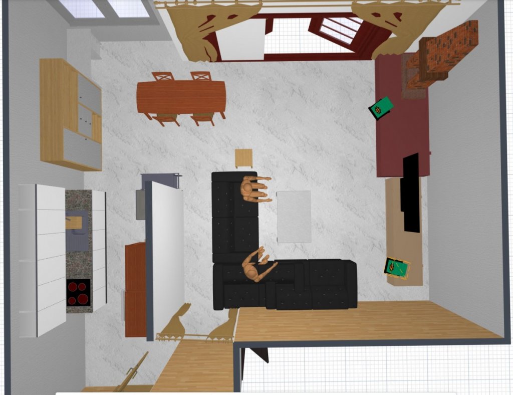

« Reply #20 on: 30 Jan 2020, 02:47 pm »
Note: I can't move the Sofa from the rear wall.
This is why the diagonal option won't work for the OP.

Re: New Layout - New System
« Reply #21 on: 30 Jan 2020, 03:22 pm »
I meant it's a sectional sofa, so you move it as a block, and it's still on the rear wall, but a different one.
As Early B just said and I had reverified a few posts before, the OP will not move the sectional away from a wall.

Zitoun
« Reply #22 on: 30 Jan 2020, 03:33 pm »
To all last comments, that will be a huge negociation with my wife, but not impossible if there is a huge benefit.
So I will try it with my current system and see if that works well. I do have to reset up the dining area too, so at least 2-3 hours of work, but I am curious to hear the result.

youngho
« Reply #24 on: 30 Jan 2020, 07:37 pm »
An example worth a thousand word, so tell me if there are no soundstage, Imaging in these songs. I feel they have soundstage when I listen to a good pair of headphones and amp:  (sorry for the YT
I am not saying that there isn't soundstage or imaging, but what would "the feeling of being there" mean in the context of Squarepusher, where the impression of depth is created through reverb? Or in the Roots, where the soundstage was created by the studio engineer, as each instrument and the vocalists were likely recorded as individual channels and then mixed?
I also like electronic music, so to give you several older examples: Thievery Corporation and much of pop and rock tends to have a very left, right, middle soundstage (or in the case of The XX, left, just left of middle, just right of middle, and right); Bajofondo has a number of musicians whom they tend to spread out from left to right, making for a more interesting soundstage experience; Orbital does a lot of pan-pot imaging, while Radiohead also uses phase to create interesting imaging effects on OK Computer. In none of these recordings can I possibly have a "feeling of being there," so I just enjoy them as studio creations without trying to imagine the acoustic space. To give a few non-classical and non-jazz counter examples, the Cowboy Junkies' Trinity sessions convey a sense of the space in which the recording was done, and even some of the tracks on the Lumineers' first album was engineered to simulate such a sense (https://www.soundonsound.com/people/inside-track-lumineers and https://www.soundonsound.com/people/mix-review-32). Classical and jazz music is also engineered, so I have solo violin recordings where I can very clearly hear breathing and jazz recordings where the drum kit seems to occupy the entire space from left to right, and in neither case do I really have a "feeling of being there," since that would mean that I would be sitting absurdly close to the performers.
The biggest problems with your room are the asymmetry and the listening position. I would recommend trying the absorption (in front of fireplace and along the wall behind your head) that I mentioned before with your existing speakers in your original proposed stereo setup. This should enhance imaging and soundstaging, but the resulting acoustic may seem a little "dry" to you.
If you think these type of music does not fit with audiophile type of gears, then you are right I will stop looking for it.
It's not the type of music that's the issue but what you seem to be seeking.
On Subwoofer, yes that's a good observation, I like the JL Audio I auditioned, and I just finished reading the thread on mono/stereo subs, that will be a good investment for me, but I will love  first a richer enveloping sound.

Zitoun
« Reply #27 on: 31 Jan 2020, 01:31 pm »

Zitoun
« Reply #31 on: 4 Feb 2020, 06:00 am »
Yes, it was "impossible" to move my son's sectional in their new house.  Until it was moved to where I suggested.  Whatever you decide you did the right thing eliciting opinions, it gives you a larger menu to choose from.
Hello everybody, before I jump straight to the conclusion, I'd like to thank every contributor on this thread, because to put this simply, I have never ever heard my sytem performing that well, I feel that I have bought new speakers, and a sub... . even when I auditioned my system 8 years ago, it was far from what I got today.
Here is the final ssetup, I know you'll tell me that the sofa is not on the rear wall, and believe me that was a very hard sell !.
But after 2 days of listening and watching movies... the difference was such that the new setup has been Wife approved !  :thumb:
I tried all variations and orientation, but only this setup gave sonic satisfaction. I can now hear clearly the soundstage, a lot more definition, and my god the Bass is so deep now ... I do not even recognize my speakers. The dynamic is huge but I can also  hear the mids at low level
I now understand when people say that Acoustic was their best investment. I am glad that I followed your recommendation and the Audiophile Mantra.

sunnydaze
« Reply #32 on: 4 Feb 2020, 07:19 am »
Looks like the left speaker is in or on the fireplace.  What am I missing?    :scratch:
poseidonsvoice
  • Posts: 4031
    • 2 channel/7 channel setup
« Reply #33 on: 4 Feb 2020, 12:05 pm »
Sunny D ;-)
Here is a link to his updated layout:
https://www.audiocircle.com/index.php?topic=158550.msg1781001#msg1781001

sunnydaze
« Reply #34 on: 4 Feb 2020, 02:10 pm »
Gotcha.    :thumb:
Right in front of the fireplace.  Careful you don't fry a driver.     8)
