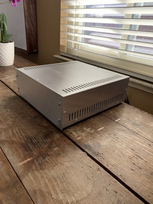

Picked this up from VTA audio (tubes4hifi.com) and gotta say this thing is dead sexy:
Sound is shockingly good for an amp under $1k.  It reminds me of the see-through clarity of my Korneff Type 45 SET amp, but with more punch and power.  Clear, smooth, beautiful, punchy.  That pretty much sums it up.  Paired with my hotrodded Klipsch Forte III speakers, it's the kind of sound that makes me want to go through ALL my recordings to see how they sound.  Because everything sounds so goooooooooood.

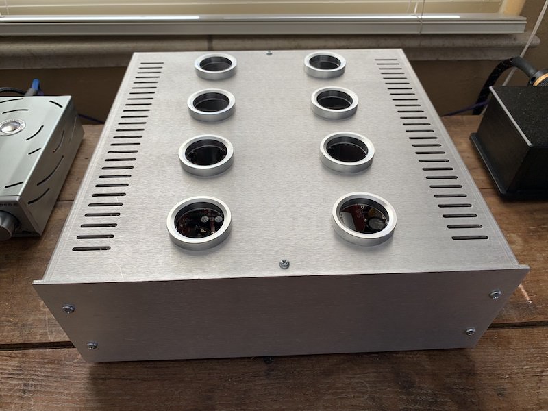

With the smaller case that the prototype used, I had to punch some holes in the top to vent the tubes properly.  A buddy of mine has a metal shop, and this is what we came up with:

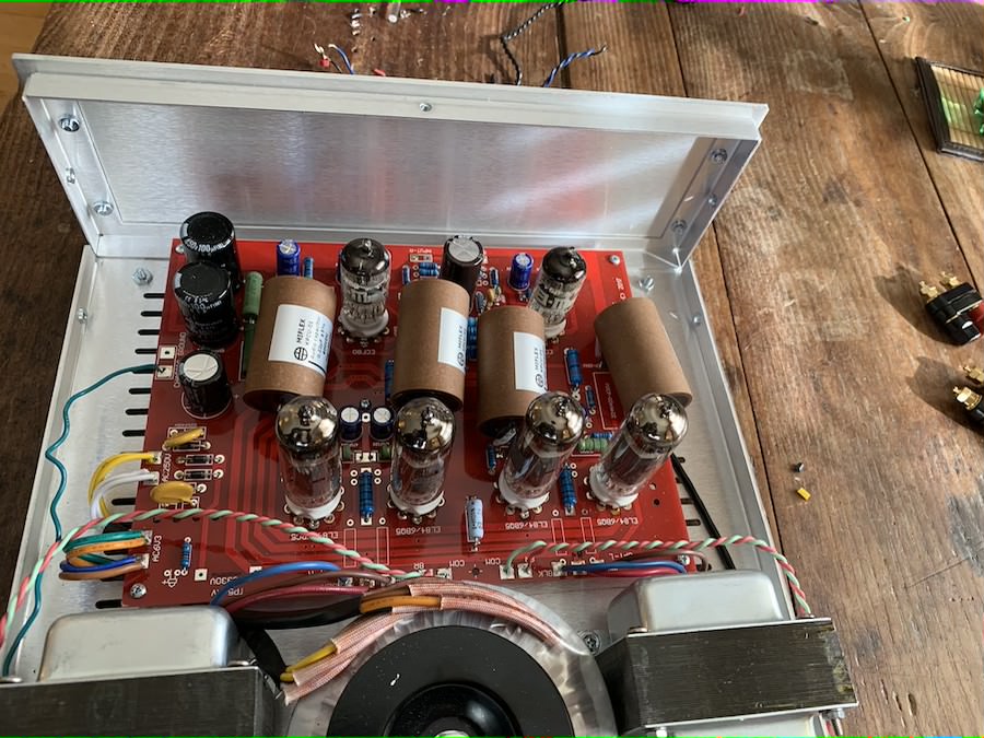

Looks like the same board, but different power transformer and output transformers as far as I can see.  And yes, mine has no volume or input switching (per my request)
The circuit seems to be a modern day take on the old Scott 299 mentioned earlier - it's a 6BL8 tube driving a pair of EL84's for output.  The very interesting thing about the 6BL8 is it's a triode and pentode in one.  So the triode part of the tube does the phase splitting and the pentode portion drives the EL84's.

What are they economizing on to make it half the cost of the Audio Note kit that it's based on?  Looks like the board is still the Audio Note kit board?
  • Posts: 11728
Re: New EL84 based amp
« Reply #14 on: 20 Jan 2020, 07:48 pm »
Looks to me like the power transformer and output transformers, and likely the output caps too.

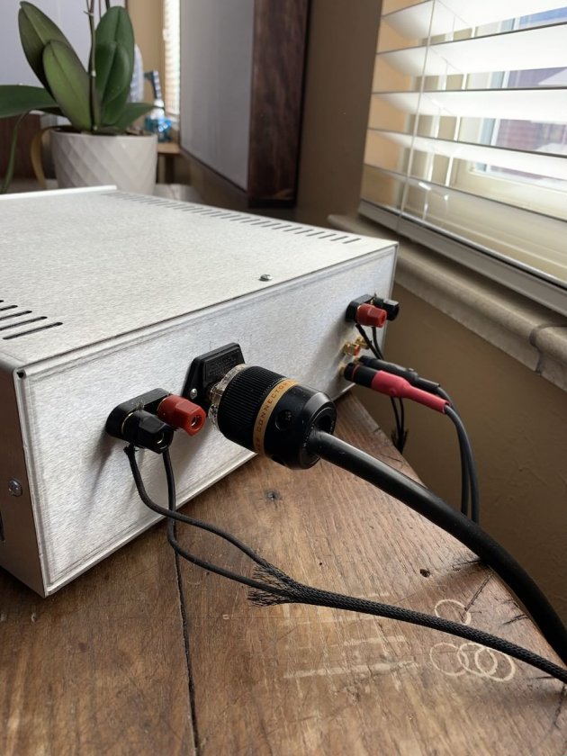

8)
Picture of the back please.
Sure thing, I'll add pics of the amp with the cover on as well as the back panel.
The back panel is just stock parts, I wanted to hear it "stock" for a couple weeks before doing any modding.  Even bone stock (and with stock tubes like the Electroharmonix EL84) it sounds incredible.
Pretty soon I'll whip out the soldering gun & put premium parts on it for the RCA connectors, the binding posts, the IEC connector, the coupling caps and the input/output internal wiring.

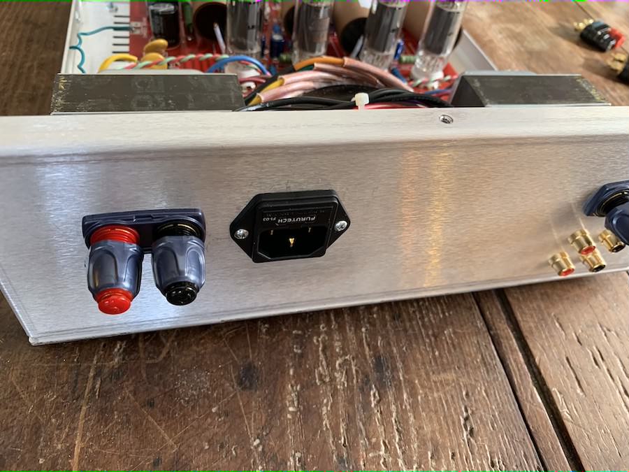

You might be asking, "Did you replace the IEC with a pure copper, gold plated Furutech today?"  Why yes, yes I did.
You might also be asking "Did you replace those brass generic binding posts with pure copper ETI Research cable pods today?"  Why yes, yes I did:
You probably are asking, "Wait, are those pure copper Miflex caps on that board now?"  Why yes, yes they are.
And you might want to know "Hey, did you replace the output wire with OCC copper/teflon wire?"  Yep.
Finally, "Did you dump the stock EH EL84 and replace them with NOS Russian military tubes?"  Oh yeah.

Was the Furutech iec inlet a straight swap or do you have to widen the opening at all?
