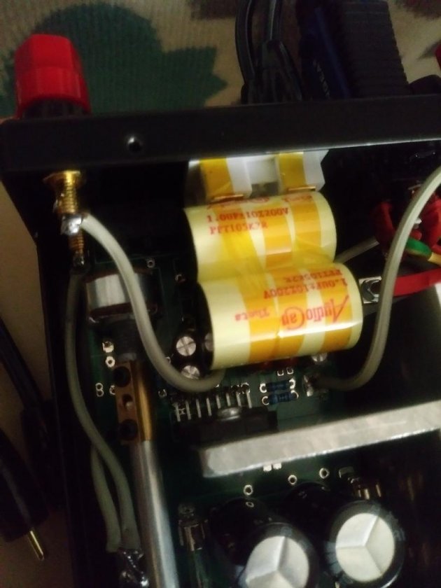

Like many audiophools I'm an impatient person.  :lol:  I took my Spark to my local tech for a capacitor swap. He knows his stuff so I trust him. I wanted to go with Mundorf Supreme Silver & Oil, but their dimensions were just too big. So plan B was a pair of AudioCap Theta's. I got the Spark back yesterday and I have several hours of music through it so far. Sounds fantastic! Everything is more wide open, lively. $50 for the tech and $28 for the Theta's, so $78 for the upgrade. Definitely worth it according to my ears.

Nice, looks like a clean job!
