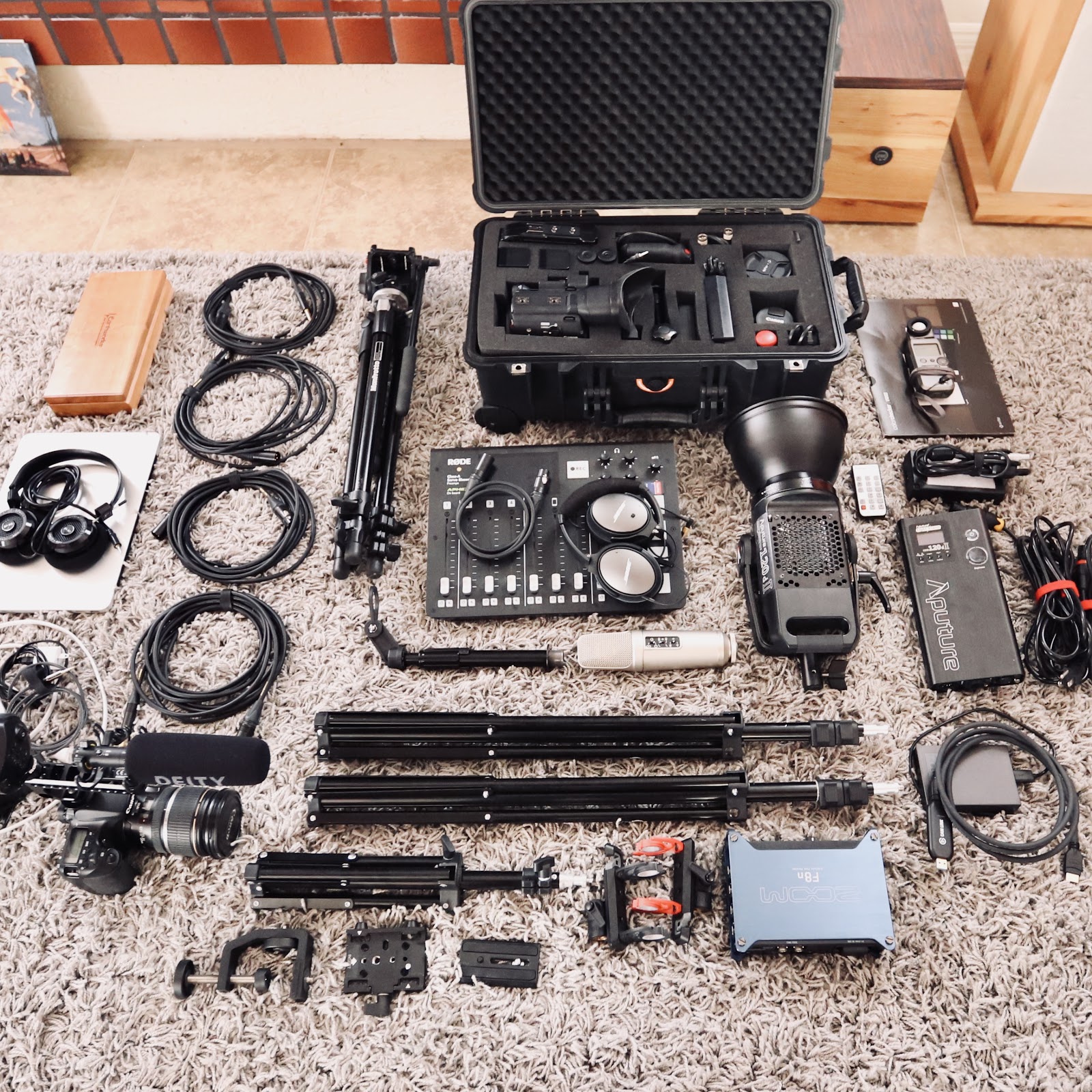

Ron Brenan (New Record Day) audio "arsenal"
« Reply #54 on: 21 Feb 2020, 02:50 pm »
As a curiosity, here you are Ron Brenan (New Record Day) audio "arsenal"
https://www.youtube.com/post/UgxqOemUxaI7A8knbR54AaABCQ
[Big IMG, link] https://yt3.ggpht.com/YNLXlKZebXYj0X8GVUg4QJakuPu_kVDs_o7sQVesx261zWiLbolLlt_T6EhA8jwlOJdbvdZVqZowIvo=s1600
You know, you always have to go well equipped if you travel to Texas to visit Danny Richie :D
