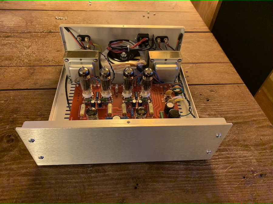

Here's my amplification idea (haha, I just got this as a new toy so had to post it somewhere):
EL84 push-pull, 17 watts.  $750.

« Reply #11 on: 16 Jan 2020, 04:27 am »
nice where did you find that? a kit?
Jmitchell3
Re: Amplification ideas to GR Research Studio Monitor
« Reply #12 on: 16 Jan 2020, 04:28 am »
Sexy AF
  • Posts: 11622
« Reply #13 on: 16 Jan 2020, 04:49 am »
It's a prototype build from VTA (tubes4hifi.com), sort of a modern update of the Scott 222C, I believe.  Even fresh out of the box it sounds great.  Similar levels of clarity and immediacy as my Type 45 SET amp but with more power and punch.
