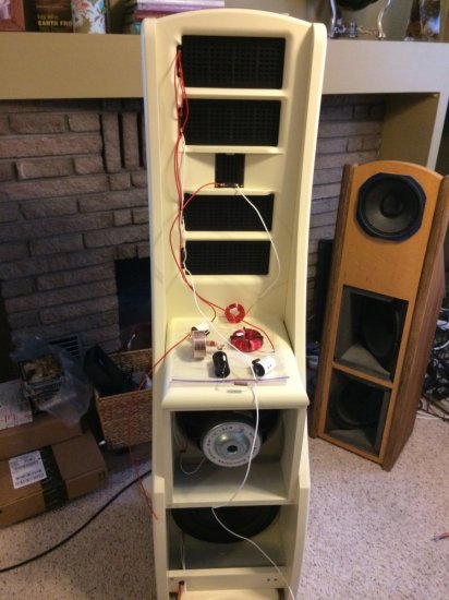

Hi..great review and speakers.....a question about the drivers alignement, Super Mini and Super 7s....I see that in both designs using same drivers, but the Super 7 it seems that the membrane tweeter is behind (one inch?) from the mids, when in the Mini's they are..any specific reason? Thank's
mkane
  • Posts: 488
Re: Tyson's Super Mini Review
« Reply #90 on: 14 Nov 2021, 02:28 pm »
Great read all over again thanks.
Looks like Super Mini separation  is 1-1/2", top of 10" to bottom of Neo 3.
Abelma
  • Posts: 42
« Reply #91 on: 14 Nov 2021, 04:08 pm »
My question is the front distance between them, not vertical....in the Mini it seems they are in the same plane, and in the Super 7, the tweeter Neo3 is in a plane behind the mids Neo10
Hobbsmeerkat
  • Posts: 2741
« Reply #92 on: 14 Nov 2021, 04:38 pm »
The are on the same plane, the waveguide sticks out in front of the neo3
Abelma
  • Posts: 42
« Reply #93 on: 14 Nov 2021, 04:59 pm »
Ok Thx !..it was a visual effect..now it make sense for me  :)
