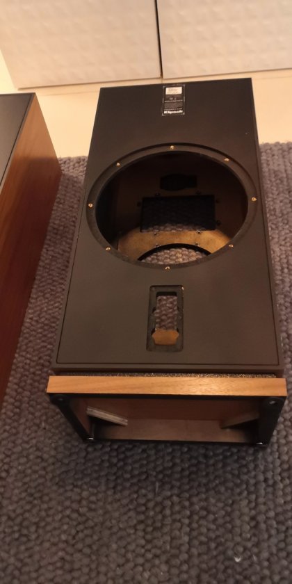

Hi All.
New here, but I received the upgrade kit last week and started work on it.
Will post picture and comments as I go!
Here are the initial pics.

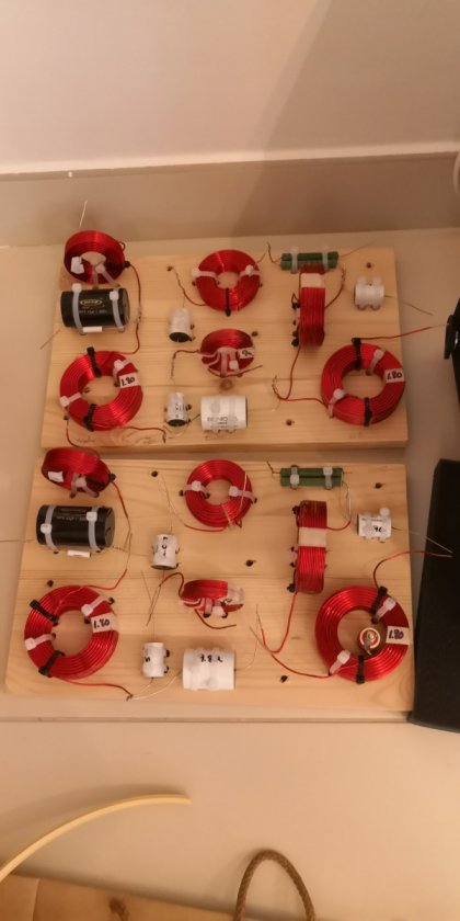

« Reply #203 on: 1 Mar 2020, 07:58 pm »
Today's progress. Crossovers mostly done and braces in.

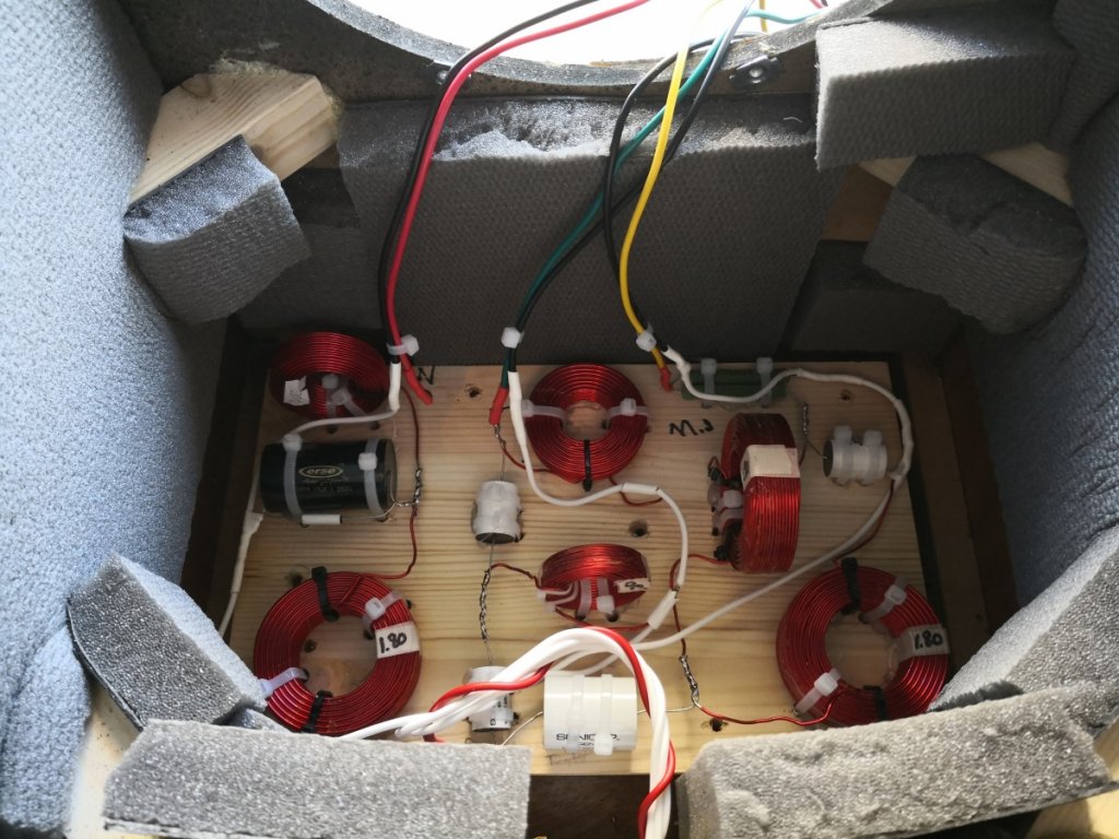

« Reply #206 on: 2 Mar 2020, 05:56 am »
Twelve inductors !

« Reply #207 on: 2 Mar 2020, 07:18 am »

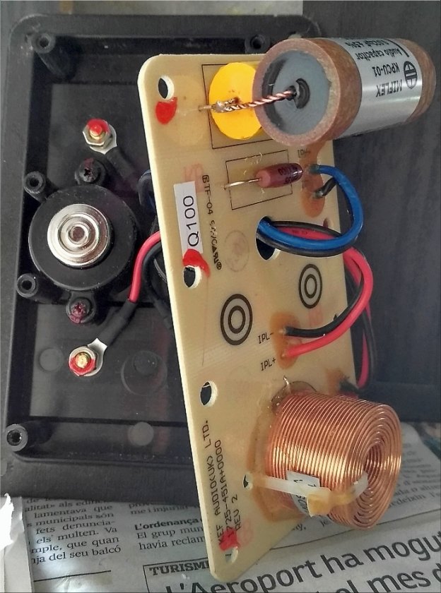

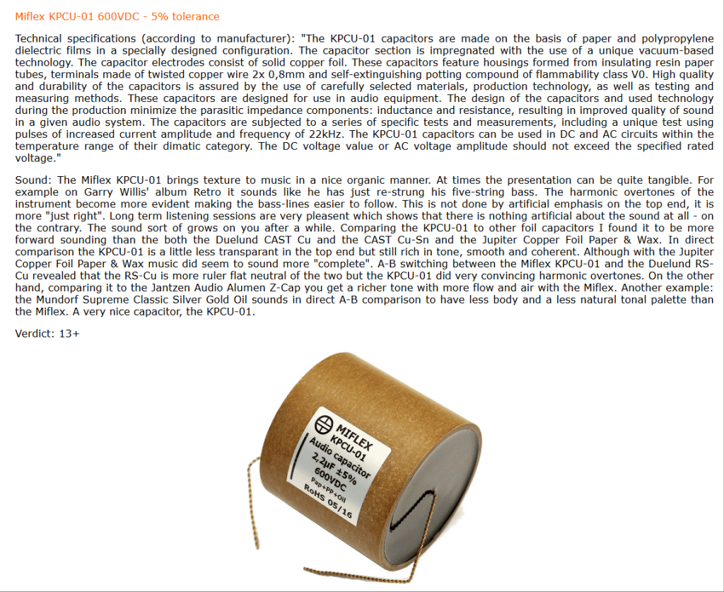

In the future you can try add 2+1 Miflex KPCU-01 0.01uF 600Vdc as a bypass the Sonicaps after you have memorized the new sound.
Tweeter (2) and midwoofer (1).
http://www.humblehomemadehifi.com/Cap.html

To this day I still can't find an academic explanation that justifies as much difference in sound as I have seen with these Miflex. According to Danny Richie, it seems to make it easier for the capacitors to charge and discharge the electric charge much faster.
In my case, in my modified KEF Q100 the difference was amazing, undeniable.
The difference between the baffle with the Miflex and the other without it was overwhelming. With the best version I have and / or that I have never heard of Hotel California (Eagles), 24/192 vinyl rip.

If you dare to do it, first only with one box and thus compare with the other. You play a recording that you have of reference, of great sound quality and high dynamic range and verify how much improvement there is.
I suspect that the M.D.L. capacitor and the resistance of the Q100 should be very damaging to the sound, so the yellow condenser will probably change as well. The oil ones (3.9 uF) are too big for those boxes!
KEF Q100 crossover: [IMG, link] https://www.audiocircle.com/image.php?id=204399&size=huge

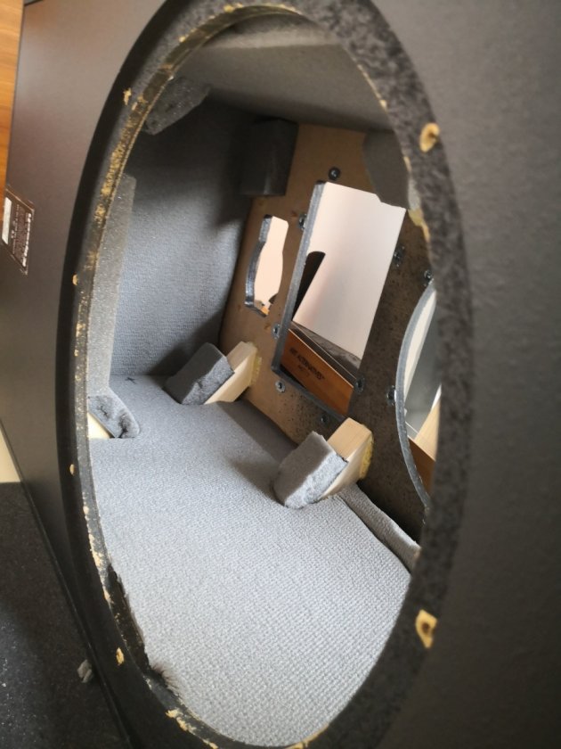

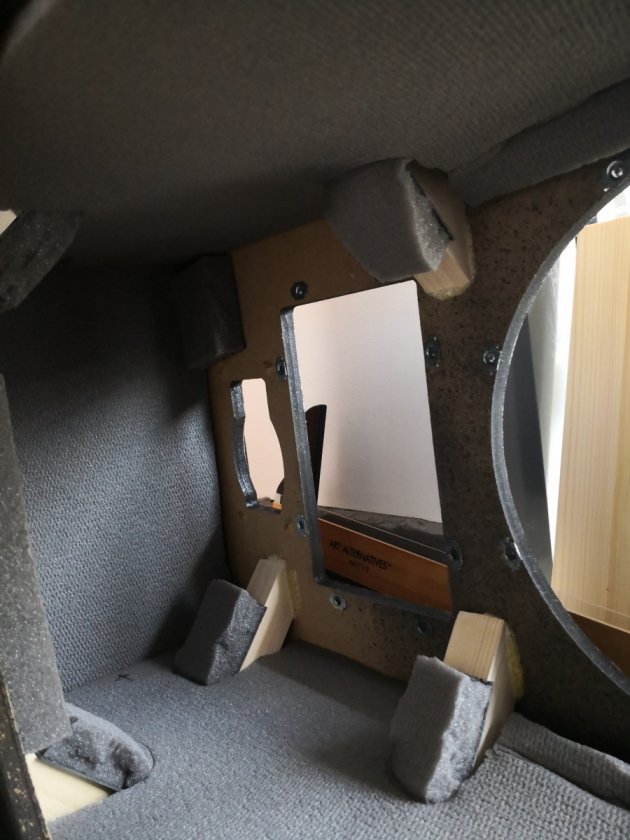

« Reply #214 on: 3 Mar 2020, 04:47 am »
More progress... Can't wait to leave the office for evening extra ciricular...

« Reply #215 on: 3 Mar 2020, 07:51 am »
Maybe also No-Rez on the back of the front is a good idea. Danny and Tyson what do you think?

« Reply #216 on: 3 Mar 2020, 09:57 am »
Yeah, it's coming!

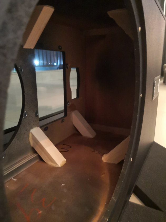

Girated, clarified and optimized
Click on image -> Huge
Front, back and sides, how much thick thin MDF?

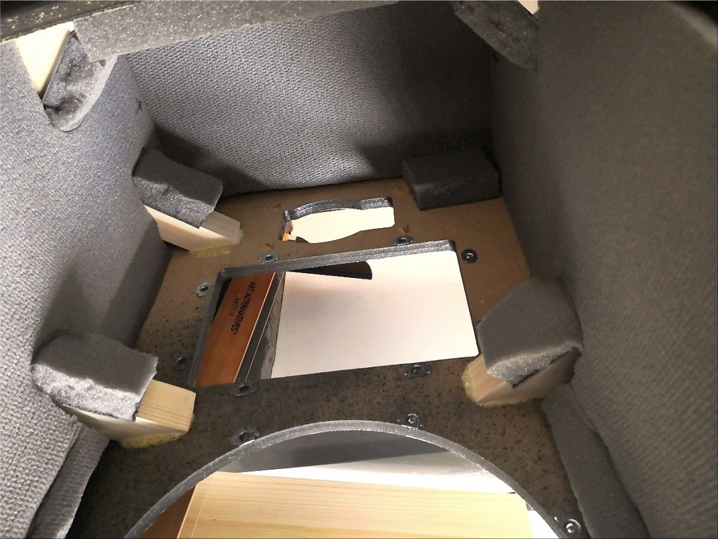

1. MDF is fine. It is dense and less resonant than other materials. It is also cheap and easy to purchase and cut.
2. The front baffle is 1.375" thick [MDF] already. So there is no resonance issue. Also the woofer frame is made from a polymer material that is non-resonance and will not transmit a resonant to the front baffle like most woofers. And it surface mounts so baffle material is not removed for mounting like many drivers that have to be recessed...
