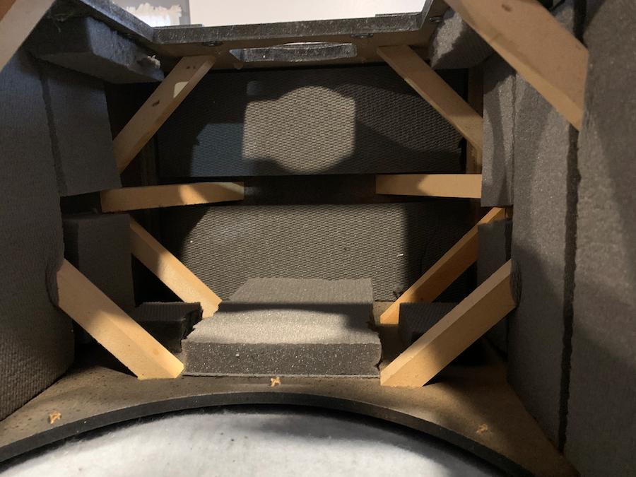

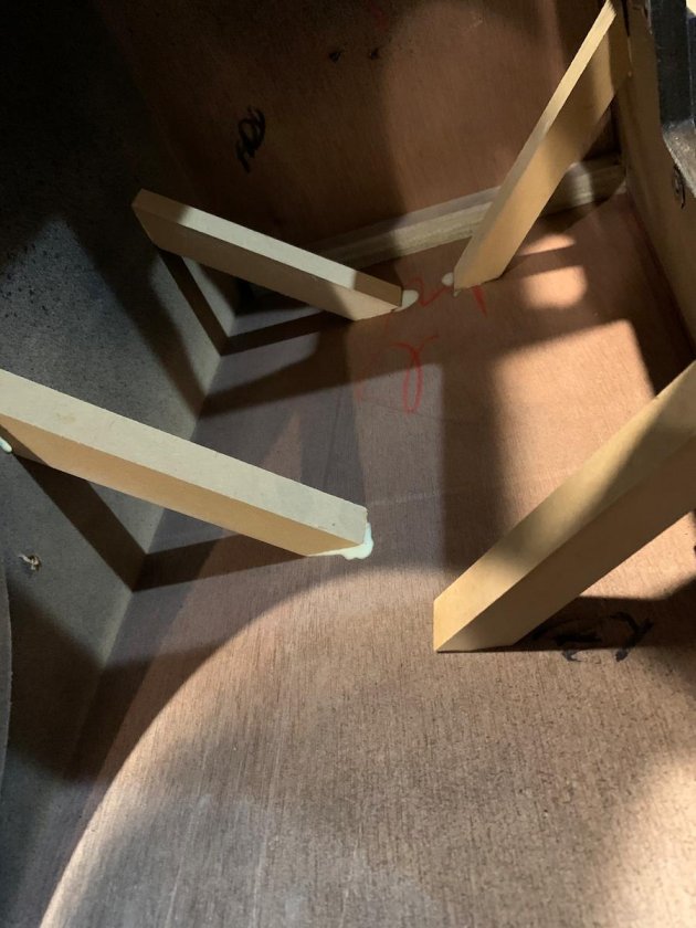

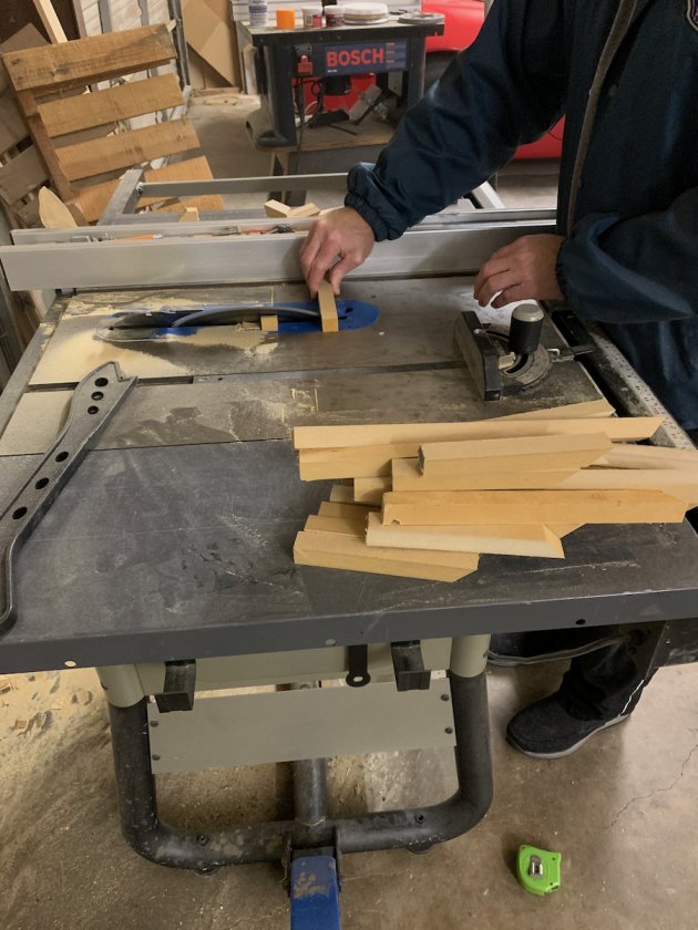

Cutting the braces.  We did it differently than I thought we would.  My idea was just to get some oak dowels and glue them lenghthwise and crosswise, flat against each interior panel.  But Danny explained that while it would make the cabinet stiffer, it would also eat up airspace.  A better way for our purposes is to cut small diagonal braces and make triangle braces at key locations.  I also would have put the braces closer to the middle but Danny showed me that putting them at the 1/3rd point instead of the 1/2 point actually does a better job reducing resonance and increasing cabinet stiffness.
Cutting the braces:
Started adding the braces:
Braces are all in and Norez installed too:

While a lot of speakers could use some bracing (and damping), I always wonder about how the added bracing may alter (reduce) the internal volume.
In the picture with the table saw, I can't tell the size of the braces (the lens appears to make them look bigger than they are.) It looks like the pile adds up to, at least, approx. 1 foot of cubic volume.
That aside, following with interest on how they will sound.
That pile was for both speakers, and they were all angle cut.  The pics definitely make them look a lot bigger than they are in life.
Crossover is still being worked out, but I'll say this - the cabinets are a lot more inert now than they were before we started.  I have a suspicion that it will help with one of the issues we noted yesterday:  When pushed, they get a bit muddy with the stock cabinet.
Now, you might say "I have them and they don't sound muddy to me!".  Which is valid.  But we're also comparing them to cost no object open baffle designs that have zero bloat or muddiness.  So the standards are rather high.
