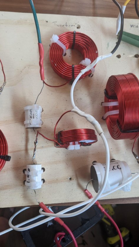

Clearly I did something wrong,  No tweeter or mid range.  I sent you an email Danny, can you please have a look.  I've only made the one crossover thus far.

« Reply #301 on: 2 Apr 2022, 03:31 pm »
I redid the ground portion of the tweeter circuit however it's still not producing any sound.  Could it be a back cap? I can't see where I went wrong.  In the meantime, I guess I'll go back to my Zu Audio speakers.  I've yet to hear back from Danny, I suppose he's busy.  I'm at the point I'll just send him the one crossover and have him look at it.

There’s a crossover 101 post up above.  The one thing I would highlight is making sure your coils are oriented properly.

« Reply #303 on: 2 Apr 2022, 07:07 pm »
My orientation is the same as the others that are posted on this page.  Monkey see, monkey do.
Two of your coils are in position 4 from the diagram that is 'very bad'. It is just rotated 90 degrees.

Although those inductors look like the variety that I used for my encores where it wasnt needed, I recall having read several folks mention that the leads are coated all the way to the ends on the current stock and need to be stripped before you solder the connections. The red coating needs to go, looking at your pics it looks like they are red to the tips and I suspect that is your issue.

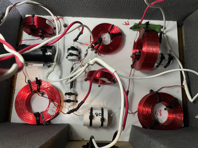

« Reply #317 on: 25 Sep 2022, 05:22 pm »
Here my first speaker's network build with Danny's kit.  Listening to it now before I move on to the second speaker.  Hearing more detail.  Bass has more punch.  Overall more clarity.
Hi,
Are you able to circle in pic what parts are responsible for the tweeter section? Thanks!
Hobbsmeerkat
  • Posts: 2741
Re: Klipsch Forte III Upgrade with Pictures!
« Reply #318 on: 25 Sep 2022, 06:16 pm »
The two small sonicaps and two coils in the middle.
