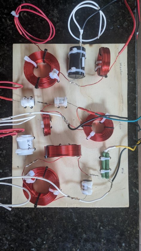

Here my first speaker's network build with Danny's kit.  Listening to it now before I move on to the second speaker.  Hearing more detail.  Bass has more punch.  Overall more clarity.

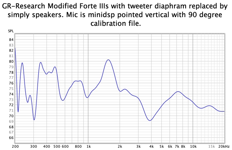

« Reply #288 on: 10 Jun 2021, 09:06 pm »
I am seeking feedback on my acoustic measurement post performing the GR-Research upgrade.  The speakers sound very good to me, but not sure about what I am seeing in the measurement below.  Here are the specifics:
    • Running REW V5.20 on a Mac feeding a Cambridge Audio DAC via USB
      Mic is a MiniDSP UMIK-1 in vertical position with 90 degree calibration file
      Amp is a Decware SE84UFO2
      Speakers are Forte IIIs with Danny's modded filter and his speaker cables
      Speakers have tweeter diaphragms from simply speakers because 1 Klipsch diaphragm was blown
      Room is 13x15' with 8.5' ceilings, speakers are 2 feet off the wall and 9 feet apart, toed in to listening position
      Listening position is centered 8 feet back from speakers and that is the position of the Mic

Is this one speaker in the middle of the room, or both being measured at once?
Both speakers are being measure at once.  Been watching a lot of YouTube and enjoying the (steep) learning curve for now :).  Am I doing this wrong?

No worries, In order to measure a speaker, it needs to be one at a time, with the mic roughly one meter (3ft 3in) away in the middle of fhe room.
Otherwise, you're more likely to get lots of peaks and dips from both speakers as well as reflections, like your graph showes, which is more a measurement of your room, rather than the speakers themselves.

Depends on the measurement goals.  If he's trying to measure the speakers to see if his upgrades worked, then yeah, one speaker at a time and eliminating room effects is key.
But if the goal is proper integration with the room, then measuring as he has done is the better approach.  Now this measurement serves as a baseline, and he can tweak room positioning of the speakers, listening position, room treatments and/or active measures to try and get further smoothing to improve the in-room performance under his circumstances.
But what level of smoothing is applied to this measurement?  Also, did you intentionally leave out the bass frequencies?
Even when taking a room response measurement you never measure both speakers at the same time with a mono signal. You have to take them on one at a time to get the real signal from each speaker.

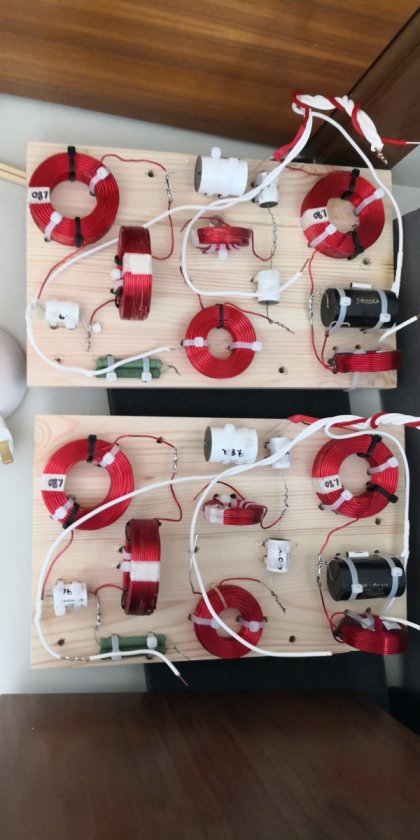

Hello, I just received my kit from GR Research.  I'm not an electronics engineer!  Would you be able to send some Hi-res close-up pics?  I'd really appreciate. I asked Danny for some pics but he doesn't have any.  When I first bought the kit off his website, there was no mention of the kit being DIY.

Hello, I just received my kit from GR Research.  I'm not an electronics engineer!  Would you be able to send some Hi-res close-up pics?  I'd really appreciate. I asked Danny for some pics but he doesn't have any.  When I first bought the kit off his website, there was no mention of the kit being DIY.  I'll work my way through it,  I just some close up pics.  Thanks.

You dont need to be an elecrical engineer.
Zigzags are the green resistors Ex: 1R5J is 1.5 ohm
Round bumps are the red coils/inductors values are written on
The sideways Ts are the black or white capacitors.
Here's a video danny just released talking about how to read a schematic
https://youtu.be/XxAqa-8T5oY
https://www.audiocircle.com/image.php?id=205453&size=huge
This is the highest resolution version of the image

I did my first crossover today, hopefully I made all the connections correct.  If anyone sees an issue, please let me know.  I appreciate it, thanks.
