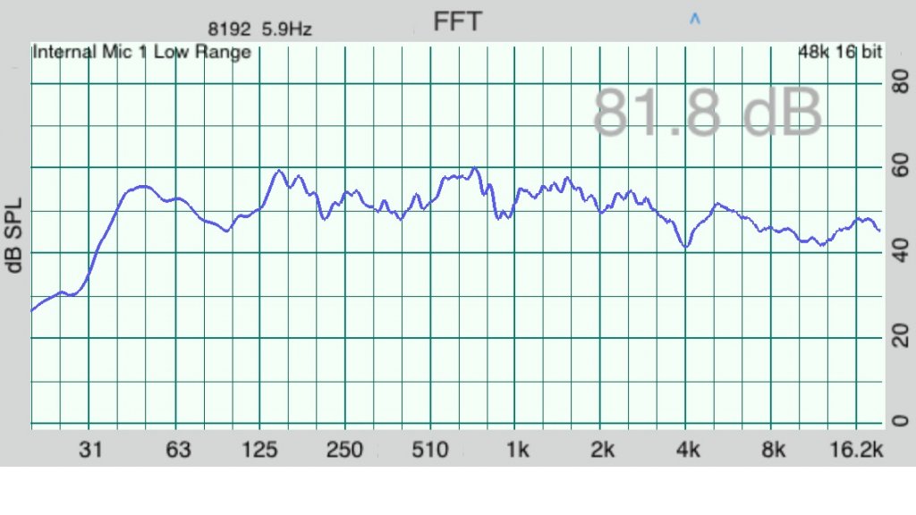

Should the line be flat? I changed to a weighting, and it rolls off like this. If I don't use a weighting, the line is basically flat.

like this?

I use the "Flat" option but C-weighted works too.
Looking at your C-weighted graphs, you have strong response down to 40hz in room.  So your crossover seems fine.
I think that dip centered around 80hz is what's causing the perceived lack of bass.  These types of dips and peaks are very room dependent, and they are ALWAYS present with box speakers.  It's just a question of where is the peak/dip and how bad.  For example, in my room I have the opposite problem - too much bass in the 70-80hz area.
Try this - put pink noise through your speakers again, and then get up and slowly walk around the room with the FFT program running on you phone/ipod.  Do the bass peaks/dips change?  You'll probably see that they will.  You could move your listening chair forward or backward in the room if you see it fills in at a different location.
The 2nd thing to do - move the speakers closer to the wall, see what that does.  And also move the speakers further into the room.  See what that does.
As a last resort, you can use an EQ to boost the 80hz region.  But only do that if you have a fairly powerful amp, as that will tend to eat up watts.
Also, bass traps can (counterintuitively) help with nulls because they absorb the reinforced bass signal that is causing the cancellation effect.  GIK here on AC has some great products for bass traps.  But they are big.

If the reading looks ok to you, then I'm cool. i think it's just going to require the usual tweaking and moving them around until I get the sweet spot - just like getting a new pair of speakers! (as well as adding stuffing.) I spent ages getting the right position for the Forte's when I got them, so it's probably the same now.
It's odd, but I think on day one, we may have had a  bad power day - they are pretty common here in Dubai. It just sounded cr*p, I've noticed this happening several times over the years.
Then yesterday and today, they sounded pretty good. Could be a bad power day, or burn in process.
100% they are clearer, tighter and more detailed so pretty sure the electronics are correct. Will play around a bit and report back when evs.

You are measuring one speaker at a time aren't you?

Nope, both at same time at listening position...
Ugh!
You can't get any real data on the room response measuring both of them at the same time. That will cause peaks and dips from the differential time arrivals of the two sources.
You have to measure them one at a time to get meaningful data.
Start over and do them one at a time.
This will also let you find and fix each issue in the room to help get a balanced response.

I'm just using my ear holes to measure. They sound great. Fine tuned their position and happy with them now.
