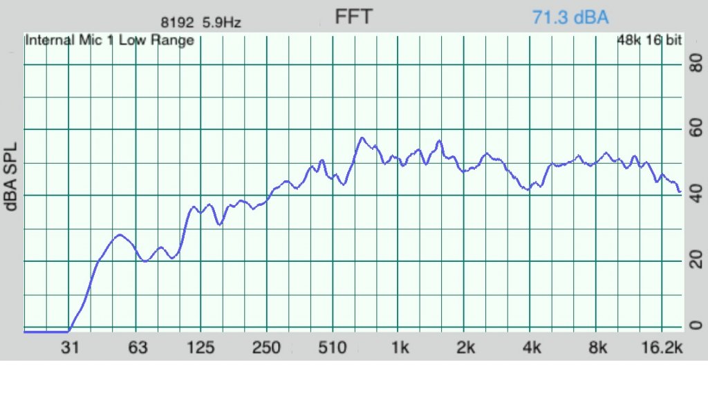

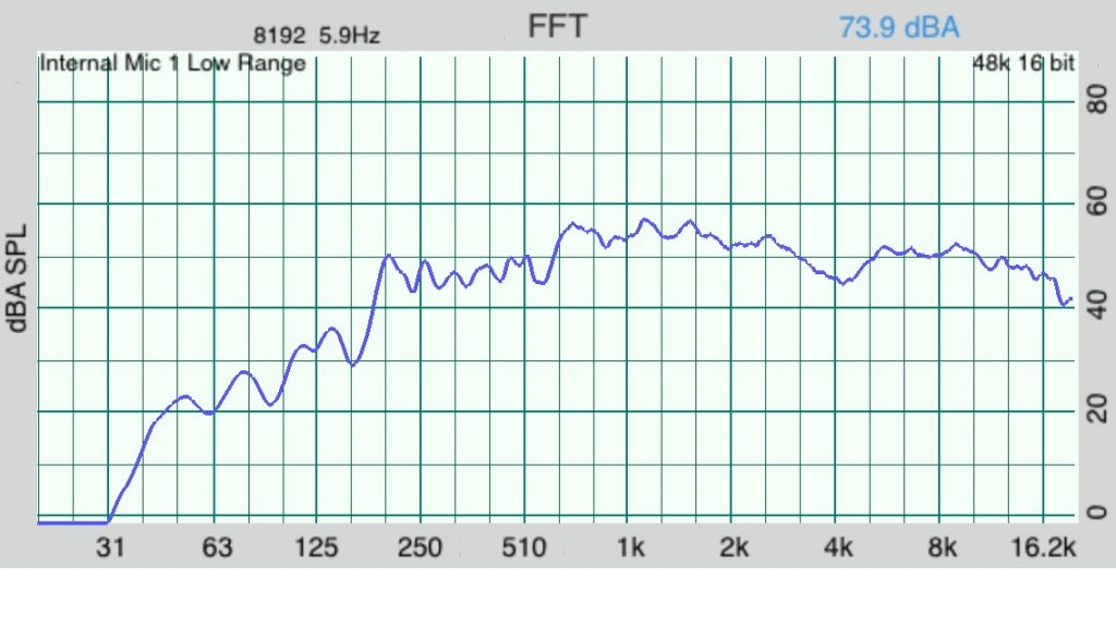

Attached are some screen grabs of probably not the best speaker measurement in history. Done with pink noise - not sure what I'm looking for to see if any thing is wrong. The only setting I change was A weighting. Done off an iPod at listening position...so not the best at all.
  • Posts: 11729
Re: Klipsch Forte III Upgrade with Pictures!
« Reply #239 on: 11 Mar 2020, 04:05 pm »
The issue is definitely with the midwoofer.  Not sure what would cause that type of drop off, my guess is a wiring issue with the crossover.  Almost seems like the midrange rolloff wiring is hooked up to the bass woofer by mistake.  Try swapping the wiring from the midwoofer and the midrange horn around & see what happens.
