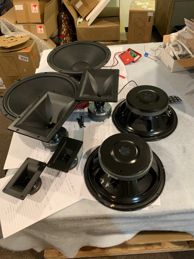

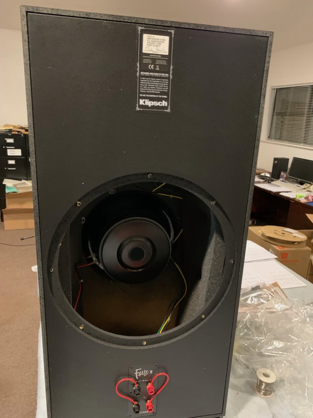

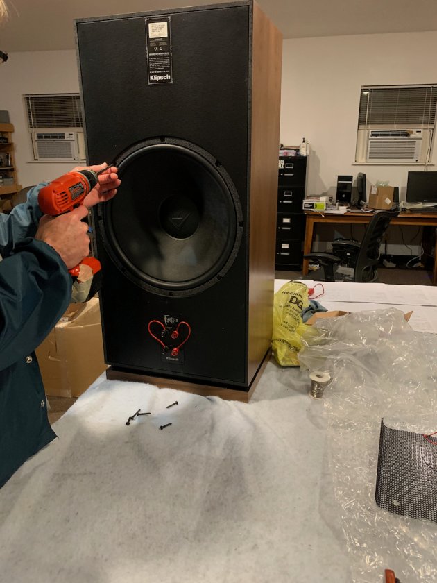

Time to start pulling things apart:
The good news is that they used 3/4th MDF for the cabinet, the bad news is that there's zero bracing inside.  So, out come all the drivers and time to start making braces.

Fun project Tyson.  Are those woofers typically running bipole or dipole?  Seems that might be a choice given the binding post layout although changing one to the other would greatly change the apparent cabinet volume the woofers would see as well as the speaker impedance.  Seems odd so likely incorrect, please set me straight.

Never mind, I see that the rear unit is a passive radiator.

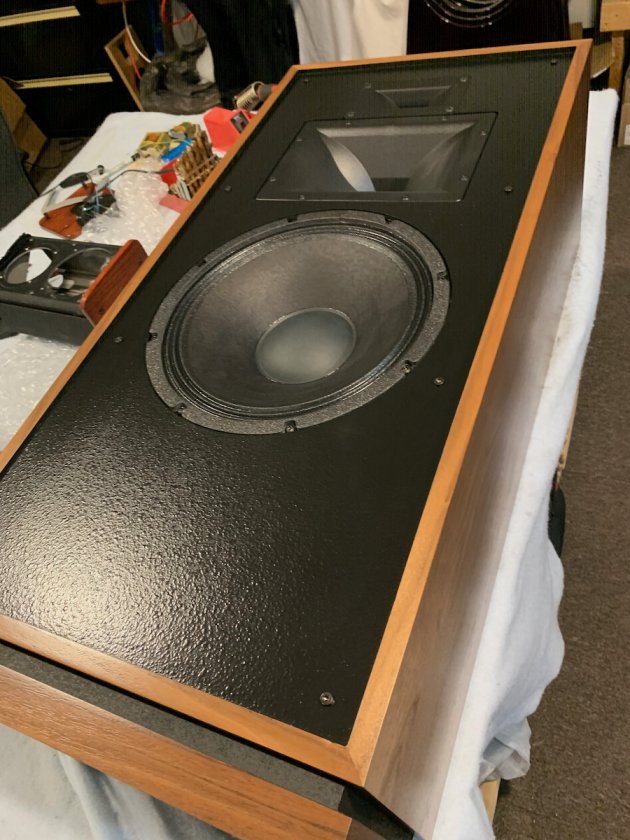

Tyson-Danny
Any thoughts on the diffraction of the front baffle? I notice your F3’s has a lip around the edge where the grills go but it is not as demonstrative as mine. Part of my mod is trimming off that lip from the sides and top/bottom but my cabinets are not veneered like yours. Just wondering if that is something you’ve considered or not and if it shows up on measurements.

Addressing the limitations of the front baffle would be great to see but might prove expensive to implement short of a complete rebuild of the front baffle. Still the contours from the horn design of tweeter and midrange seem smooth here. I wonder what material the horns themselves are built out of, and concerns with regards to 'ringing.'
The horns seem to be directional enough that it doesn't affect the sound.

Oh, there's bracing now.  We braced the hell out of them, haha.  I'll post some pics tomorrow and also we've lined them with norez.  There also wasn't any acoustic stuffing, so that's going in there too.  Parts quality on the crossover leaves a bit to be desired.  I'll post more tomorrow on the crossover stuff.
Also, the horns are made of plastic.  I'm going to damp them down too.  The woofer frames are thin and resonant as well, all of it's getting damped....
