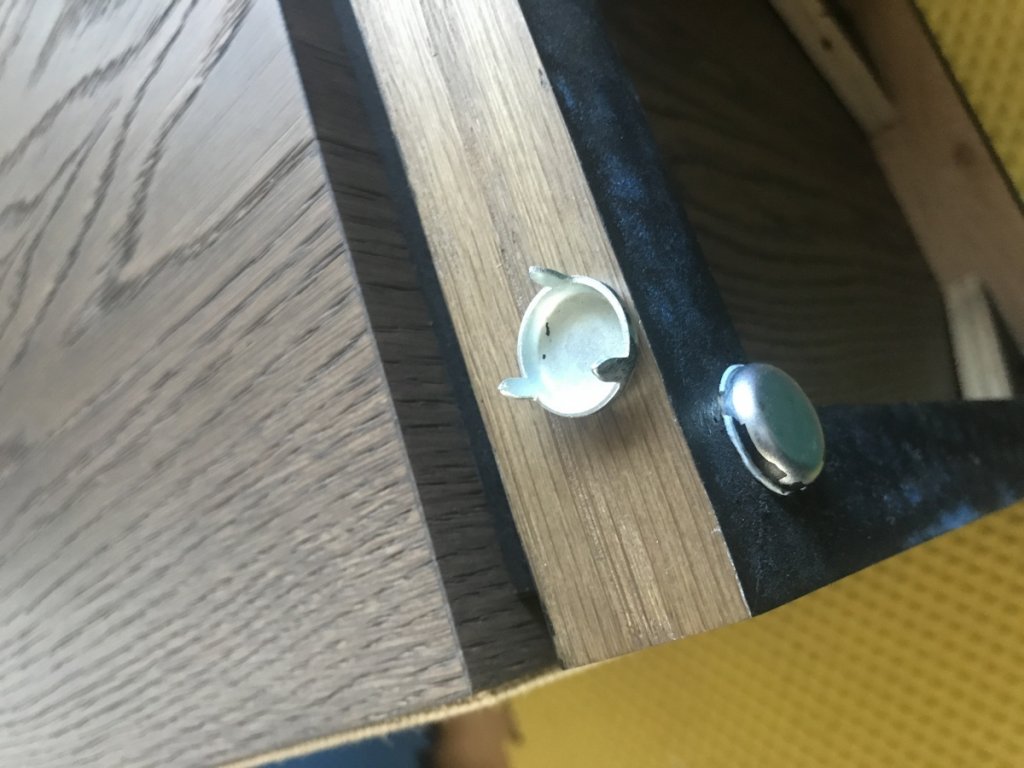

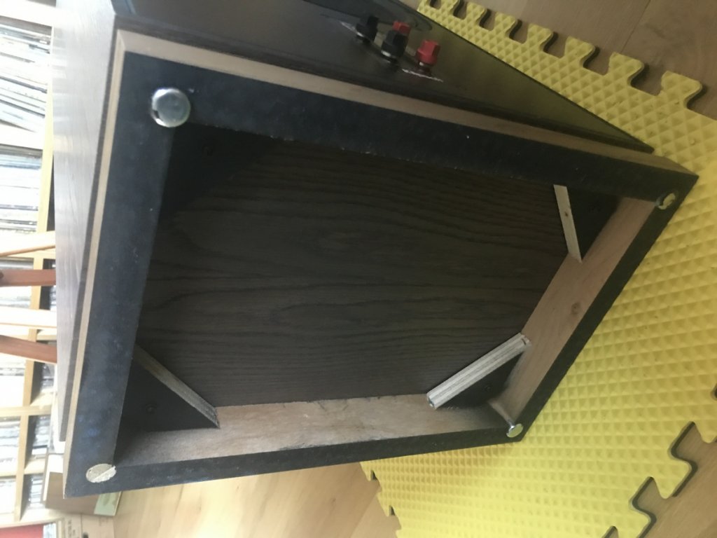

I was kinda surprised to find the construction of the integral stand. Seems like this could be improved upon to help isolate speaker from floor. Also, there is no way to level with uneven floors with these cheap hollow glides. I ended up popping them off and filling all of them with Blu-tac while I was at it. They come off super easy.

Just spit balling here....but I think this lower section stand would be easily improved if the hollow portion was filled in with mdf or similar to create a solid base instead of this open design.  Also, trying to figure a way to get them on roller balls. That seriously improved the sound of my last speakers.  Pretty tricky given the weight of these speakers and the stock base design.

I thought that they needed about a one foot tall stand myself.
Interesting....I have read comments from quite a few folks saying the same thing about these speakers.
