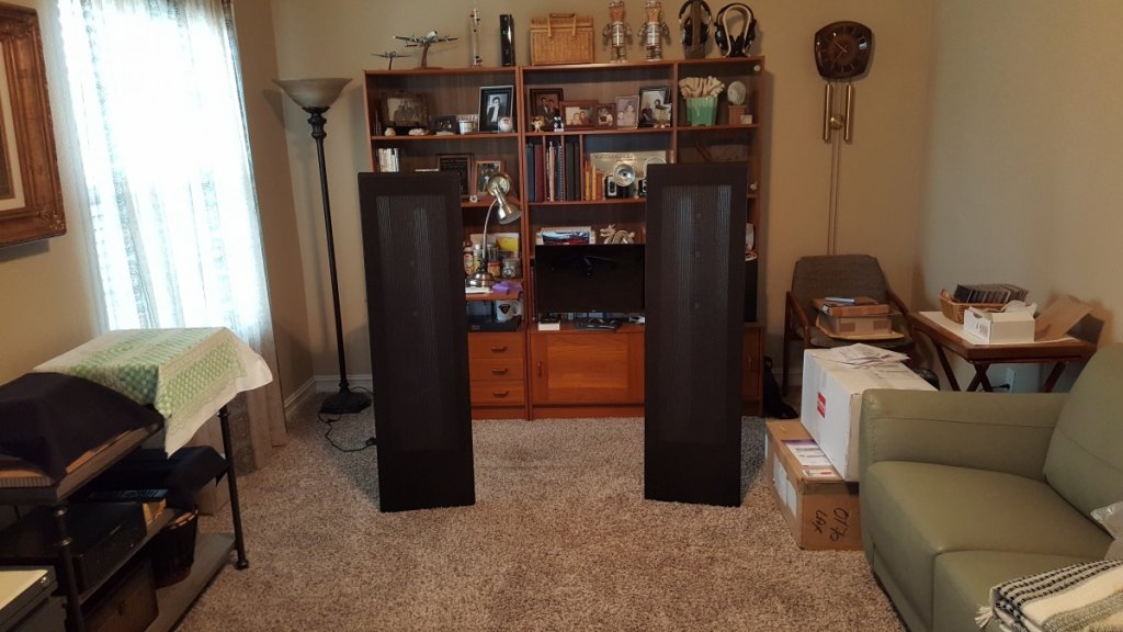

Well, the Maggie’s arrived less then a week ago, they got here sooner then expected.. I do know Maggies need break-in but right now their sounding a little thin.I don’t remember the MMG’s sounding like that initially. My long time audio buddy is already encouraging me to get a sub. I may tough it out for a little longer to see if the bass improves. On the pro side, it’s nice seeing Maggies in my listening room again, it was like having an old friend come back to visit.

Play around with position, that might help.
I expected my LRS would sound a bit thin, but they don’t.  I still use a sub, but they are surprisingly satisfying full range.
I guess I got lucky they like where I put them.
agreed, IMO and given the pic you provided give them a little more space between the pair for starters. As for not having room for a sub, if your room can accommodate di-poles done correctly it can allow for a sub(or two)

  Can you get 7' to 8' center to center ? Try tweeters on inside. Can you move them back to 3' from front wall ? Give it a go. When and if you get a sub then you can pull out from front wall more. You may want to get off heavy carpet as well. Spikes ?
  Have fun,
charles

I do have the the tweeters on the inside right now and they are more spread out then in the picture I posted. When I ran the MMG’s a few years back my electronics were a Prima Luna preamp and Bel Canto REF 500M mono amps. Now I’m using a Bel Canto PRe2 preamp and a Bel Canto REF 500s stereo amp which is pushing 500W per channel into 4 ohms.
I do have some options at this point like using my Woo Audio headphone amp as a preamp. I also have a PreSonus Temblor T8 Sub which won’t be optimal with the Maggies but I could see if it help’s. I will experiment with placement today, hopefully that will help. I’m thinking (hoping) the .7's just may need some break-in time. We’ll see. Thanks for all the suggestions.

Last night I decided to try the PreSonus T8 Powered Sub which I was using with some powered monitors as a desktop system. I thought, what the hell let me try it with the Maggies. I didn’t really take too much time setting it up, just set the crossover and plugged it in. I figured this ain’t gonna work..
Well, I was in for quite a surprise, it sounded wonderful. I sat there scratching my head and said… WTF… I listened to music for hours, everything I played sounded great. Rock, classical and jazz. This turned out to work better than I imagined. I’m now thinking of getting a sub that might be better suited for the Maggies, maybe a REL T/Zero. So far I’m dumbfounded but very happy…. Life is good
