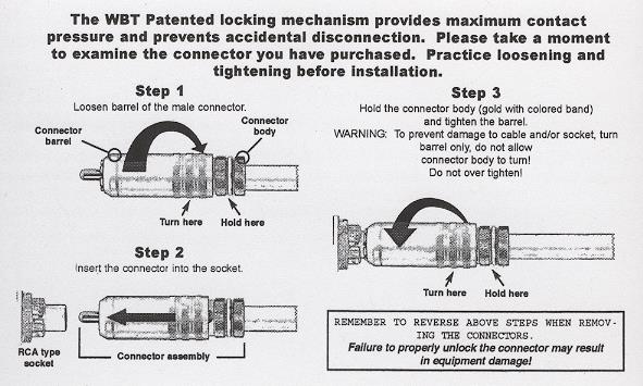

I'm going to go over how to use the WBT 0102 Ag locking RCA plugs I use in many of my cables.
First, why locking RCA plugs? They are a pain!  :evil:  I know, but there are some advantages!  :)
     - RCA jacks are not all the same size so if you don't have locking RCA plugs some may be too loose and some may be too tight.
     - If the RCA plugs are not locking the design must use a plug that can flex. This introduces some design constraints.
     - If RCA jacks are not locking the number of cycles the plug and jack are good for is greatly reduced due to friction wearing out the parts. This friction will wear through the plating eventually.
     - Conversely, locking RCA plugs allow the plug to be installed and removed without nearly as much friction, this preserves the plating on both the plug and jack.
     - Locking RCA jacks make more firm contact with the ground and can't be inadvertently pulled out as easily.

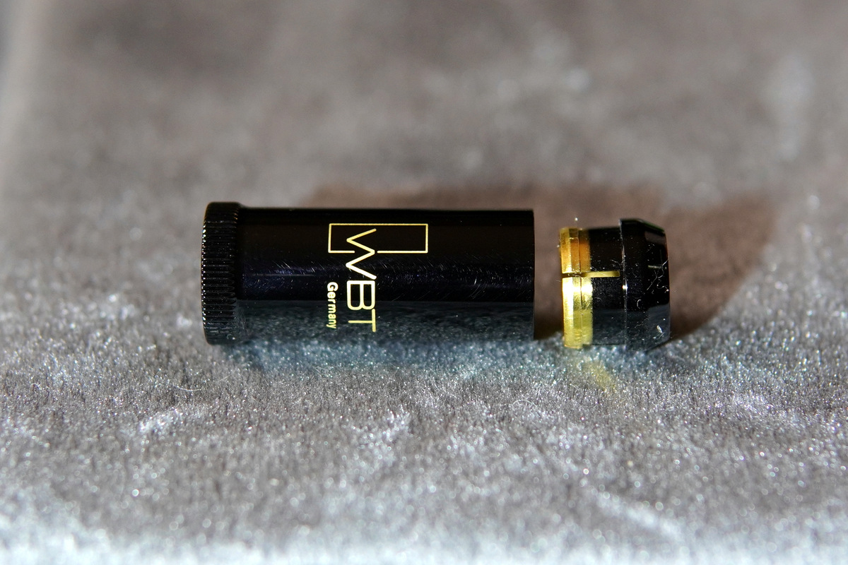

     - If over tightened the plug can damage the jack. If you look at WBT's Nexgen jacks, they are mostly plastic and too much force by the plug could damage it.

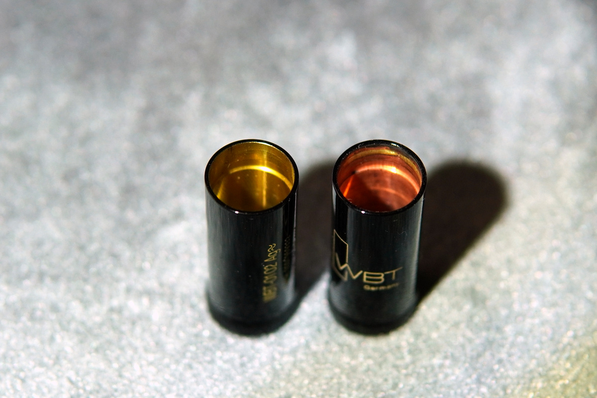

WBT has recently changed the material the locking barrel of the 0102 Ag RCA plug, it is now softer to prevent damage of RCA jacks. The downside is the main reason for this post, if over tightened the plug can come apart, it's made of 2 pieces that snap together. Let's check out some photos to see exactly what I'm talking about... But 1st, here's the instructions given by WBT:

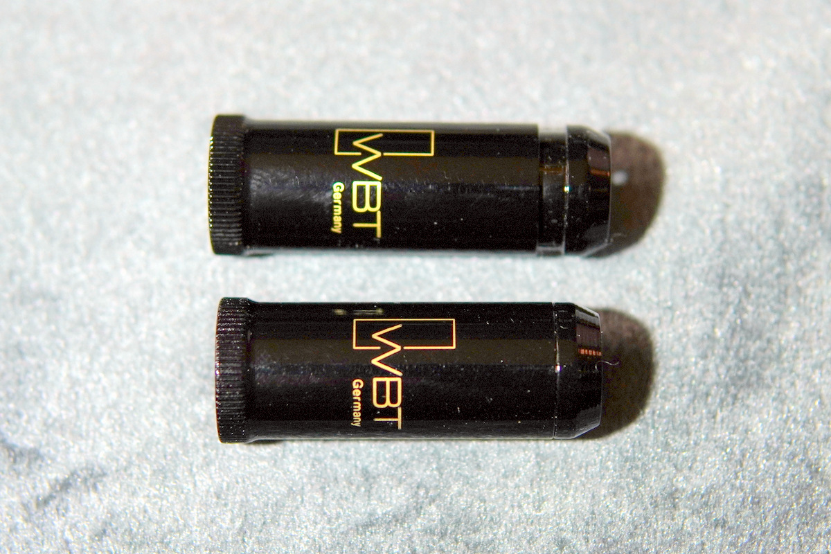

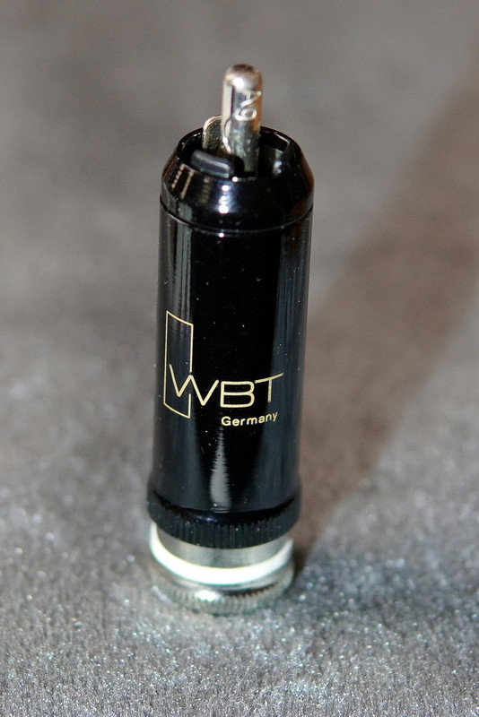

First, the complete plug. I recommend lining up the tip of the locking barrel with the ground prongs when installing. Note only ONE ground prong is the ground, the others are only there for support, so it's very important the ground prong is firmly in contact with the RCA jack.

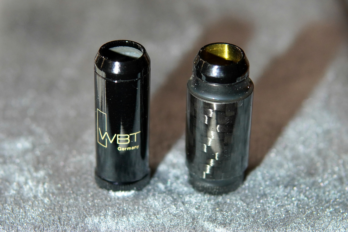

Next, let's look at the locking barrels, stock on the left and with the carbon fiber damper added on the right. The carbon damper gives you more leverage, so it requires less force to tighten.
Here's a locking barrel separated into it's 2 pieces:
And here's what the locking barrel looks like when it's been separated due to over tightening:
And here's what the 2 different barrel materials look like, the old style is on the right and is much more difficult to over tighten, the new softer brass material is on the left and some folks have been having issues with them lately. The old one, I maybe had 2 folks separate the locking barrels over 5 years.

In your own judgement, when installing these cables what do you consider tight?  Turn until you meet resistance and then stop, ensuring the cable base (core) does not itself twist?

Interesting to note that when looking straight into the end of the cables loosening and tightening are standard. Counterclockwise (CCW) is loosen and clockwise (CW) is tighten. But when installing a cable and looking at the rear of equipment the mind thinks the opposite direction because it is like inserting a screw into the equipment.
That always messes me up for a while. But then again, all my clocks are digital so what do I know.  :lol:

I have a version of these on a Bolder digital cable.  I tighten them only by hand, and only until light/medium resistance.  No issues for many years.

yes, this throws me off as well.  Would this be considered reverse thread or are you standing at the front of your equipment and as such not reversed thread.  (I would end up tightening when trying to loosen and then really be confused because I either made it more stuck or damaged it when using softer alloys of today.)

Hi John, I'd consider tight just past the point where you start to feel some resistance, maybe only about 10 degrees of rotation past that point, so it's not much. Just enough clamping force so you can't easily pull the plug off of the jack without loosening it first.
To make things more confusing, Furutech locking barrels operate in the opposite direction vs WBT.

The teflon tape is pretty easy to figure out, just wrap it around the threads just like a pipe. The carbon fiber dampers are used on ZenWave cables, they are cut using a diamond saw blade, reamed, and glued in place. I don't want to give up all the details, I can see my competition copying. There's another company that uses dampers on WBT and they hide it under shrink tube. I think the carbon fiber looks too nice to cover.
