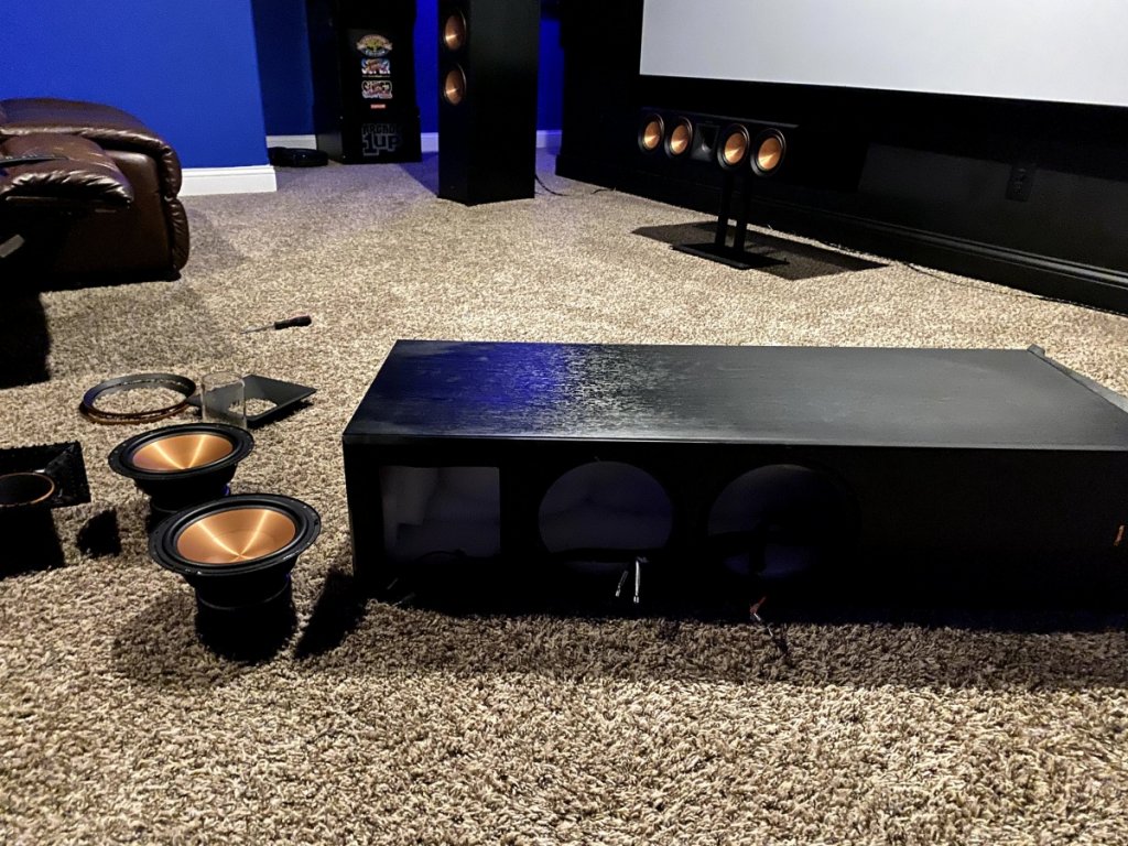

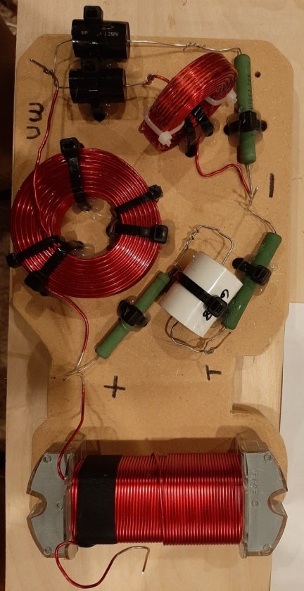

Received my RP-8000F kit on Wed.. Started the Crossover build and am just about ready to take the speakers apart...
Will post more pictured of the build and install with measurements if anyone is interested

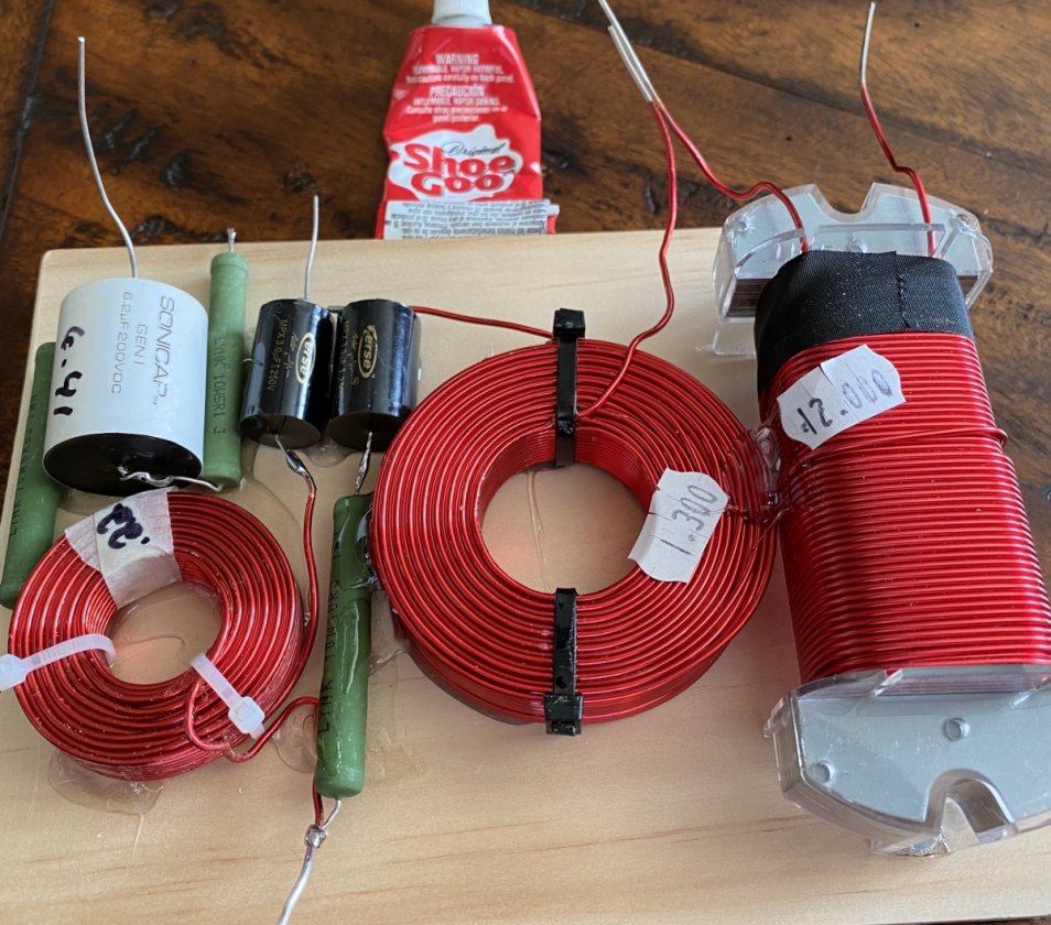

I completed my Klipsch RP-8000F upgrade last night.  I love the Klipsch sound.  But I wanted to get the midrange hole that was bothering me fixed.  I was expecting smoother highs and more present mids.  Since the upgrade I can't stop listening to my system.  The upgrade exceeds my high expectations.  The highs were already clear.  Now they are cleaner and smoother.  The mids are more present and involved in the presentation and the bass is stronger.  I could go on about the sound improvements for some time but will spare you.  I was a quite nervous about tearing apart these already pretty awesome speakers.  Once open, I noticed the internal cabinet bracing looked very rigid.  With the NoRes installed the cabinet is now solid as a rock.  For anyone with a similar system, and want to estimate your system improvements I have a test for you.  In my case, my front LCR speakers are a pair of RP8000F's and a center Klipsch RP-504C.  Prior to the upgrade music sounded better by a mile in DTS Neural X mode compared to multichannel stereo.  There were some things better about multichannel stereo mode for music.  But the vocals and other midrange sounds were so muted that it was a rare song that sounded better in this mode.  This observation has been immediately confirmed by numerous friends a family on many occasions.  If your system has these same odd characteristics, you may be perceiving the same midrange hole and can estimate the upgrade improvement comparing to better midrange performing center channel .  After the GR Research RP-8000F upgrade, The DTS Neural X mode sounds better for sure when sounds are played on the front LR speakers.  But now music unquestionably sounds the best in multichannel stereo mode.  Classical instruments, piano, strings, etc recorded in near field sound amazing now.  The only downside is the 8000F speakers are a slightly less forward sounding in the high range.  Oh and it took me some real effort to complete the actual upgrade.  While I always received high praise from anyone hearing my system before, I feel like my system has now crossed over the line from mid-fi to hi-fi.  The GR Research upgrade is one of the better upgrades I've done on my system.

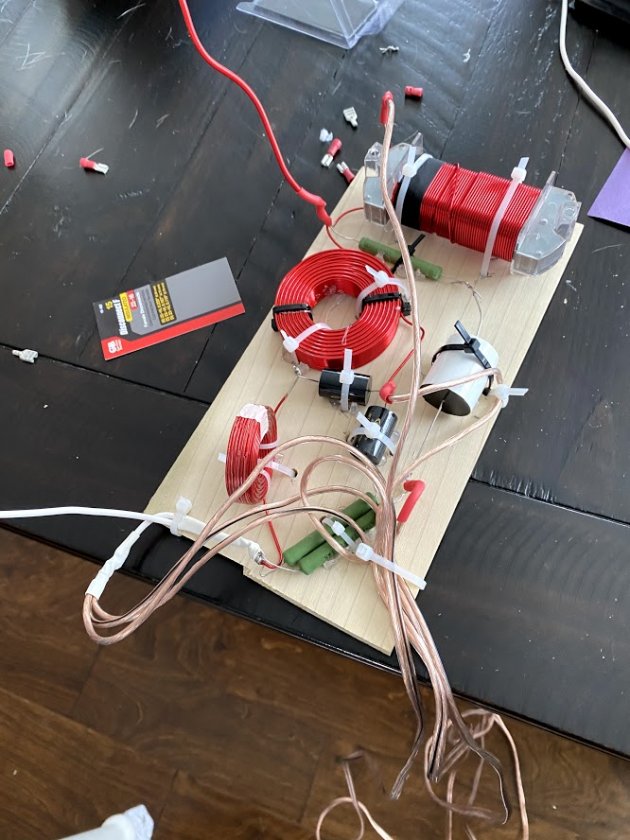

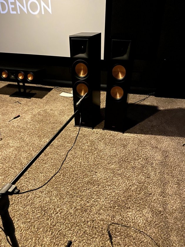

With the crossover competed and tested, I am ready to install..

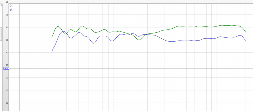

Only one is done So I figured this would be a good time to compare the two...
Please note (I did not have enough cable to complete the install with GR-Research's included cable, so I used some 16 gauge speaker cable i had.
Not seen here is me installing the no-rez
As you can see the dip at the crossover range looks to be gone and the upper freq controlled more..
Need to finish the second one now and then I can actually listen lol.

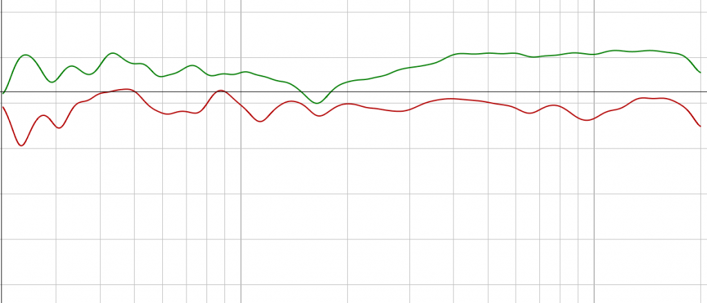

Second speaker done.. Before and after measurements
  • Posts: 11646
Re: Klipsch RP-600M Upgrade
« Reply #126 on: 16 Feb 2020, 12:52 am »
That's a rather large improvement.
yeah that's a bit of effort  :D

It wasn’t to bad took about half a day to complete but yeah I was over it by the end lol... will post thoughts on the changes as I get to listen to them more tonight and tomorrow
