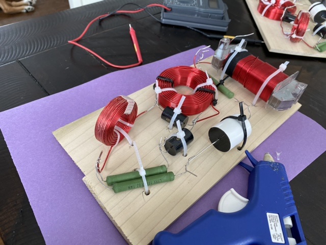

Received my RP-8000F kit on Wed.. Started the Crossover build and am just about ready to take the speakers apart...
Will post more pictured of the build and install with measurements if anyone is interested
