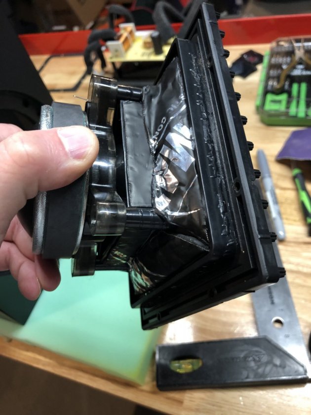

It’s worth noting one of the most significant upgrades I did to the version one models were using non-hardening modeling clay on the mid-bass driver, and plastic surround in the back of the tweeter.

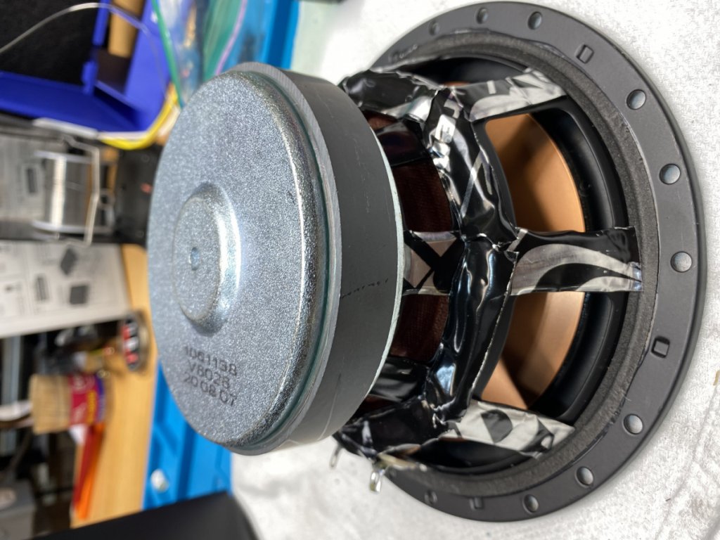

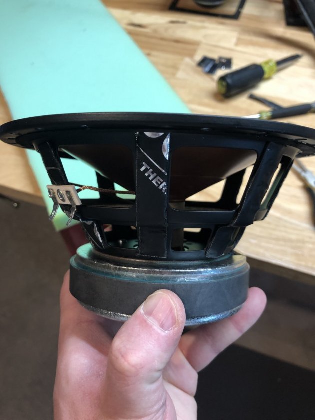

I do plan to do something similar using butyl based product similar to Dynamat. Not sure about the inner horn frame, but ill likely do at least the woofer baskets.

It’s hard to say how damponing the horn frame effects the end result.  I did it along with all the other upgrades at the same time. It definitely didn’t hurt the sound and made things like trumpets and and saxophones sound less hollow and exaggerated. But again this was the overall result.
If you tap the tweeter horn frame with your nail or a screwdriver, it’s obvious it rings like crazy. The clay was a massive improvement to that. When I ran audessey setup on my system with the premium version and mic, It indicated about  a 2 db dip in 6-8 khz range of my speaker. These were preliminary measurements just to dial in distances, the measurements are pre burn in of some gear and cables, and should be taken with a grain of salt. I plan to post measurements of my fr response after I get about 200 hours on my system.

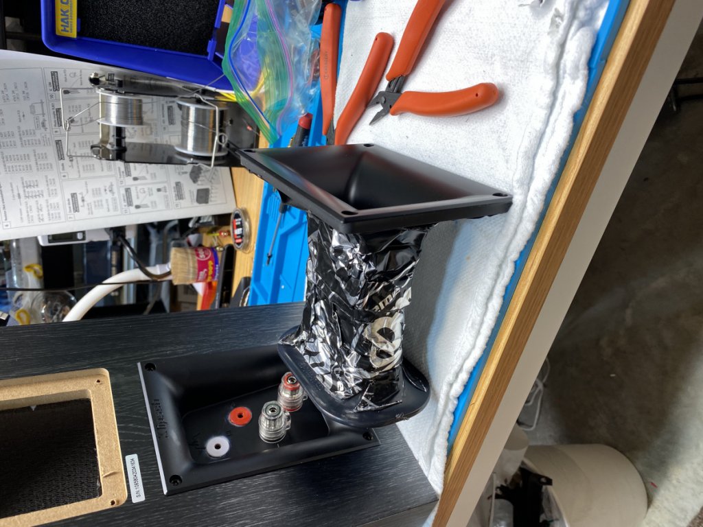

You can feel a lot of vibrations with vocals when putting your hand on the horn while the speaker is playing. I am going to be upgrading the pair I just got soon. I bought some stuff called “boom mat” from Autozone which is basically the same thing as Dynamat. I plan on using it on the back of the horn and the woofer frame.
mkrawcz
  • Posts: 628
Re: Klipsch RP-600M Upgrade
« Reply #368 on: 11 Jul 2022, 12:35 am »
So here is what I ended up with using “Boom Mat”. Does it make a difference? I don’t know, probably. It certainly reduced the ringing when tapping on them.

mkrawca, that looks pretty good.

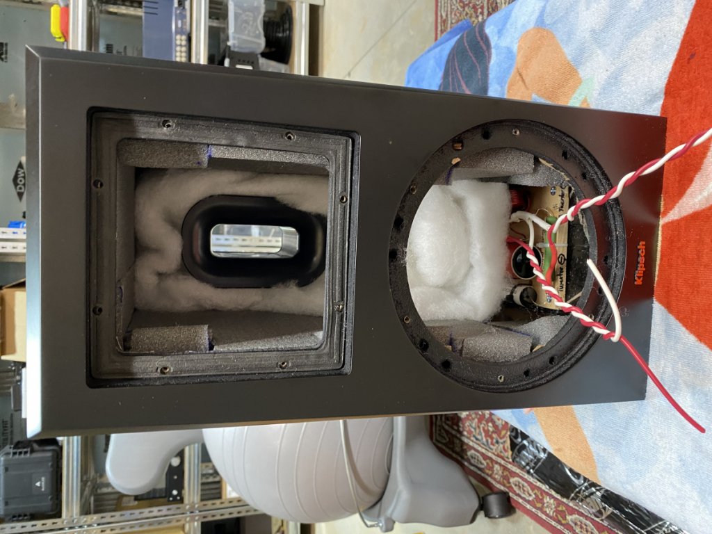

Finally getting around to give feedback on my assembly of the modifications of the RP-600M's.  I included the included mods from Danny's kit and then added dynamat to the speaker assemblies and the horn port.  Only other mod was adding a Jantzen cap in the woofer path.  My assembly isn't pretty, but it works and sounds sooooo much better than the OGs.  Also added the tube connectors and replaced the standard style ones in series.  Before, I finished both - it A/B'd the unmodified vs the modified and there was a huge difference.  The modified no longer 'screamed' at me - aka way too in your face.  Although, the modifications brought the 'in your face' part back in the stage; it was still very present.  Otherwise clarity of the music was improved across the range.  I used the Decware Zen Anniversary amp in addition to a Elekit 8600 as integrated amps.

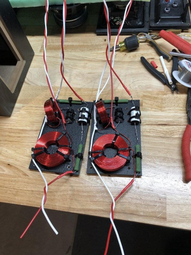

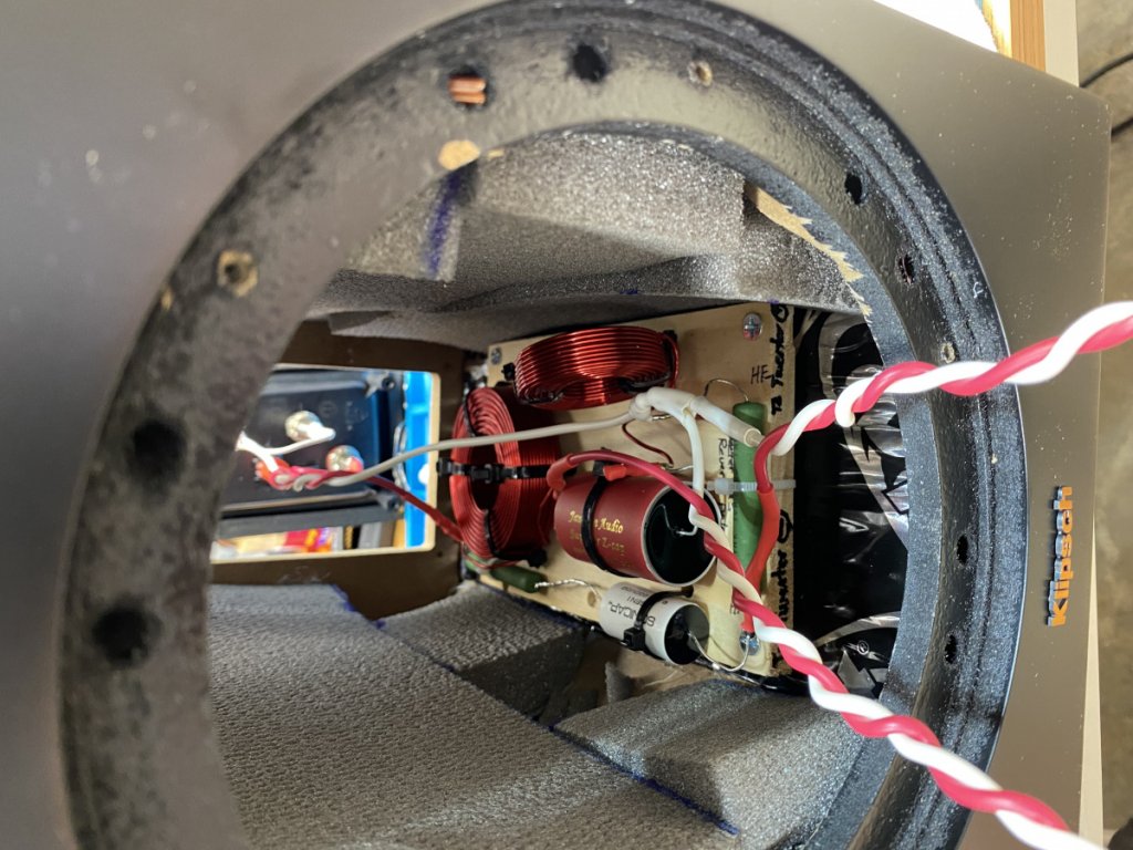

I was looking at your images posted of your crossovers and noticed the red wire attached to the leg between the capacitor and resistor.  Instead of red, I used the white wire on this leg as it would correctly reflect the negative tweeter wire and utilized a red wire connected to the leg between the inductor and resistor for the positive tweeter connection.  If you installed the crossovers and ran the red wires to all the positive connections and the white wires to the negatives, the tweeter would be wired incorrectly.  Then again, it would be simple enough to place the red tweeter wire on the negative tab and the white tweeter wire on the positive tab for correct connectivity.  I was just pointing this out in the event others who are building GR Research's RP600M crossovers don't get confused when looking at your image of the crossover.
You generally always wire Red and White from input to output. The polarity is just reversed on the tweeter, so you just connect the red to the negative terminal on the tweeter. and the white to the positive as per the schematic.
Either way works.
