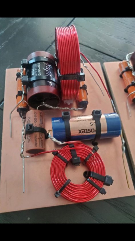

Folks looking for network boards.
Few tips, least some ideas or thoughts. Less metal the better. I used a hard cheery wood to mount down the parts. Little overboard I went with making sure things don’t come loose! Also stained it, added some fill under it as well.
I wish I did the tube connectors on the top! Why? The angle down can interfere with the network. Try and have your network boards as short as possible. Driver vs inductor space is limited. Lol.
Zip ties, hot glue gun. Wood glue.
Also used some strips and cut them to 3/4 wide by 3/8 for stand off’s. Pre drill down a little, brass screws to hold the board in place.
Advise for the tube connections… use the top position. It gives you more room for the wires and such.

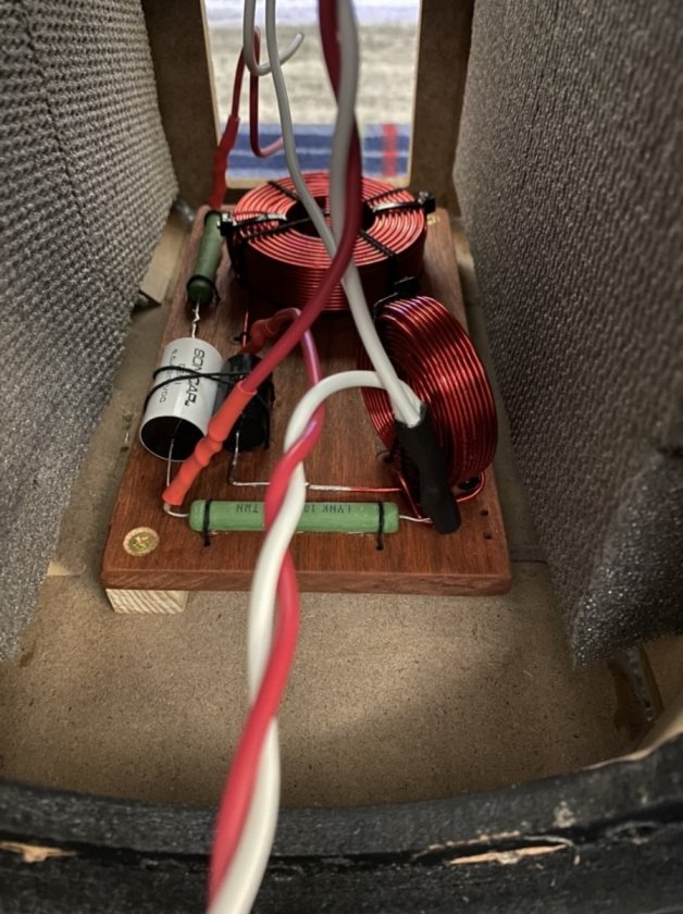

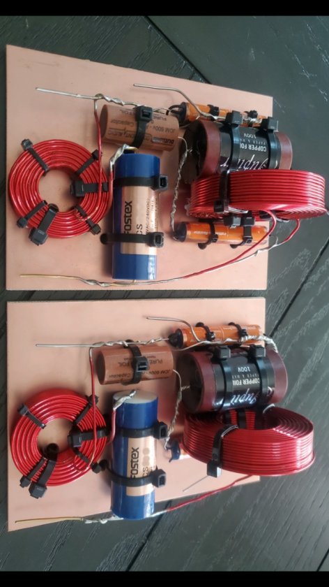

Hey happy klipsch owners. I have a question regarding the Klipsch rp600m's. My questiong is about toe in, specifically for the upgraded klipsch rp-600m. I have done the upgrades and have burned them in fairly well.
I will say that i have added bypass caps, and after installing them and putting my speakers back in approximately the same position, Im missing some center image lock in the soundstage, they play really wide feet past the speakers to either side, which they didnt do before the new bypass caps. But my question is about extreme toe in, does this work? Ron from new record day made avideo about this and i was wondering if anyone has any experience doing this with success with the Klipsch RP600M.
Please let me know how you use your klipschs, and pictures are definately welcome.
Heres mine: PS, including a shot of my crossovers.

Re: Klipsch RP-600M Upgrade
« Reply #344 on: 12 Jan 2022, 02:53 am »
I played around with some JBL Studio 4309 monitors a few months back and noticed the same thing.
Imaging was a bit unfocused, but they had a really nice, wide soundstage, especially without any toe-in. I found them to be a little  fatiguing when directly facing me, so I didnt stick with that very long. The upgraded 600M likely wont have that issue but it's hard to say.
I tried "crossing the streams" as Ron calls it, and imaging was locked in tight, but i also found the soundstage had almost completely collapsed by doing so, at least in my room.
So for me, i just kept them facing into the room without any toe-in.
I imagine that the 600M and other horn/waveguide based speakers will do the same thing.
So you may need to play around with the toe-in a bit to find what you think works best for you and your room.

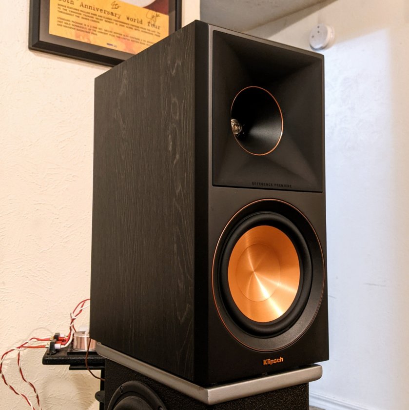

A pair of the RP 600M II just arrived the shop, and I'm currently putting some time on them. (I bought them)
Out of the gate, at higher volumes, they're a little bright, especially with respect to electric guitars & synth in the lower treble region, leaving the mids feeling lacking. Facing them into the room helps ease some of the brightness and helps with soundstage width but which did some weird things on one song I've only ever heard  happen with headphones. Not much in the way of layering or depth.
Imaging is quite good, even towed out.
Mids, aside from being a little thin, are decently behaved too, but not as clear or articulate as I'm used to.
Gunna give them some time to loosen up & burn in so see what changes after 50-ish hours.

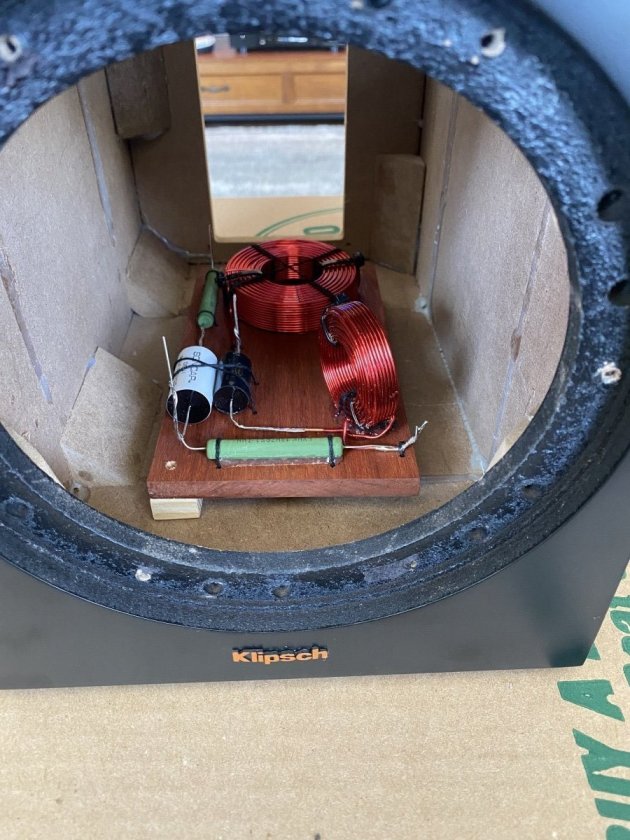

A peek at the new stock crossover, there's definitely some improvements made over the original

Yep. Looks like they pulled from the standard Klipsch parts bin.
It's nothing particularly special, but it is a step up in parts quality over the original. It still uses steel nuts on the inside of the binding posts though, but the use of a polyester cap in the woofer circuit is better than the electrolytic cap in the original.
