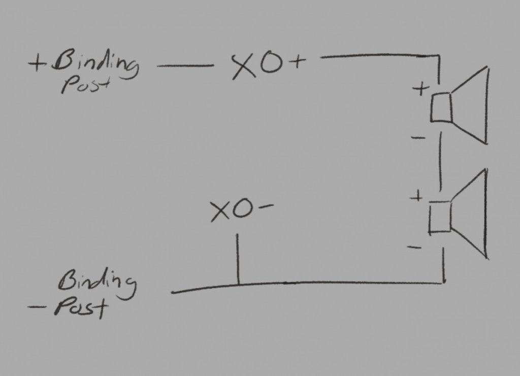

Heres a quick sketch of the drivers wired in series, hopefully this explains things better  :thumb:
Thank you! Alright. Now I understand where the + to - happens. Your post when you mentioned the negative going to the positive..it makes perfect sense now. You were describing it starting at the woofer, and I was interpreting it as starting from the xo, hence the confusion.

I think it would just be...if the resistor in the pic is the negative(for both woofers), and inductor will just be positive to outer woofer.
What you said about the negative going to the positive confused me a bit. If the negatives are shared, the positive will just go to the woofer and that'll be the end of it. No need to connected the shared grounds to the positive on the inductor, or am I wrong?

I believe I'm all set Danny. My xo is wired the same exact way as the picture shared 7-8 posts ago, which was user Homer2's build of the same upgrade.
I just needed to do some research on wiring woofers in series, as your diagram states. Now I understand. You can disregard that question, as it was only asked because I misunderstood a statement made previously. He was telling me to "daisy chain" the woofers, + to -, and I got confused because I thought he was still talking about the crossover board. No worries. All set. Thank you!

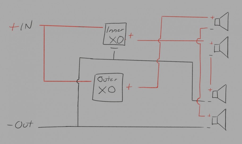

I just wanted to know if there was a problem with the inductor on the left. Also, according to what you said, and your diagram..the woofers should be wired like this, correct? There are 4 woofers. I=Inner O=Outer

No, the output of the crossover only connects to the positive terminal of the inner woofers only. The negative terminal of the outter woofer then connects to the negative crossover.
I'm out for a whiskey festival right now, but ill be leaving here in a lil bit, & Ill sketch something up for you soon as I'm home.

I reread your post and i think I get what you're saying, but the diagram would help clarify. I appreciate you. I'm hoping to finish up tomorrow
So it looks like I mightve had everything right besides...the outer + terminal only gets connected to the inner -, and not also the XO +. Makes sense. I guess I'll find out when you get back to me. Have fun man. Thanks again

Here’s a quick diagram to show how the woofers should be wired.  :thumb:
Hopefully that clears everything up!
Disregard. I was missing some details.

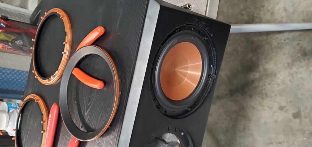

How the heck do these things go back on!? Sheesh. This took a while.
Danny, the 504c kit is 4-5 feet short on wire. Is what it is. Used wire I had around the house.. I've seen this mentioned from others who have built this too. I've gotta get this done and get home!

Right. I thought of that. I ended up using the other wire for the + to - jumpers. I just had to. And I had to extend one of my negatives a bit, and use a red wire as one of my negatives coming from the binding post.  I honestly have no freaking clue how to put those caps back on

Okay good, good.
I wonder if its one of those things were you just gotta get the pegs ligned up and kinda gently bang them back into place?
Or in the woofer has a specific orientation that it needs to match for them to fit?
Cblan1224
  • Posts: 34
Re: Klipsch RP-600M Upgrade
« Reply #298 on: 15 Mar 2021, 03:02 am »
Woofer was upside down. Has to be in one specific place for it to work.
