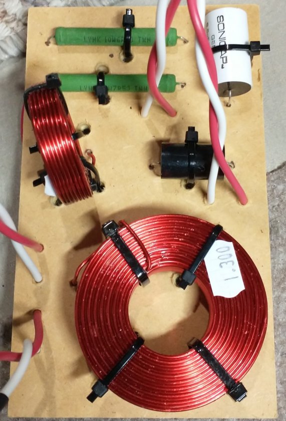

Hey guys. First time, long time. I just received my 504c upgrade kit. I have 8000f upgrade on the way in a week or 2. I'm not worried about the 8000s, because I've seen pictures that should help. This is my first entry into DIYing, other than putting together a few hypex ncxxxmp modules. Of course, there isn't much to those.
Anyway, I'm a visual learner and would love a picture from someone who has done this. I think that would help me a lot.
I don't know much about the diagram here. Ive got the parts laid out, but there are V shaped things on the diagram, U shaped things, things that mention ohms. Have a green marker and an X through one of them. Someone post a pic! I heard someone posted a picture(Homer2), but it won't let me search until I have 3 approved posts, so here goes the first one!
Thanks everyone.

Here ya go!  :thumb:
In case anyone is looking for a layout example to consider.  This is the GR Research cross-over layout I used for the Klipsch RP-504C center channel.  It measures 3.5" x 12".  It fits very well on the bottom all the way to the side behind the binding post cup.

Thank you so much. It was hard to find while not being able to search for it. I have learned a lot since my last post, and had the tweeter circuit put together, but I did have one question about connecting the positives that these picture answer clearly.
I cannot tell you how much you tracking down that picture for me has helped me out. I am now 100% confident in what I'm doing. ...I have a good size mdf board on order and I won't get it for a week, but I'll have this properly laid out in a few minutes.
Thank you!

Here ya go!  :thumb:
One last question. Is there any issue if I put the inductor in the middle laying flat and the 2 on either side of it up on end?
Thanks
Hobbsmeerkat
  • Posts: 2741
Re: Klipsch RP-600M Upgrade
« Reply #273 on: 12 Mar 2021, 08:39 am »
Thanks
That will work just fine as well.  :thumb:

One more for ya. If a diagram shows a line that just goes straight across, where does it get its ground connection? On my diagram it says the inner woofers and outer woofers are wired in series. I'm mentioning it because I'm not sure what it means in this case, so I wasn't sure if it applies to what im asking.
The negative wire goes from outer woofer, to where? Shares a ground with the inner woofer?
Thanks
Hobbsmeerkat
  • Posts: 2741
« Reply #275 on: 13 Mar 2021, 12:56 am »
The Neg terminal from the inner woofer goes directly into the Pos terminal of the outer woofer, then from the Neg terminal from the outer woofer is the ground for both drivers and connects to the Negative tube connector or binding post.
If the woofer circuit doesn't have connection to ground, then the wire simply goes get connected to the ground line for the tweeter and then from there to the tube connector/binding post.
If that makes sense. if not, let me know, and I'll doodle something to explain it better tonight/tomorrow, when I get some downtime.  :thumb:

I tried to put a caption to that last picture. I don't know what happened to it. So looking at his drawing, it appears these 2 should be connected. If wired like this, would you use a jumper cable, and isn't it better to connect the 2 directly, if at all possible?
Thanks

I think it would just be...if the resistor in the pic is the negative(for both woofers), and inductor will just be positive to outer woofer.
What you said about the negative going to the positive confused me a bit. If the negatives are shared, the positive will just go to the woofer and that'll be the end of it. No need to connected the shared grounds to the positive on the inductor, or am I wrong?
Sorry for all the messages, I just wanted that clarification. Otherwise, I'm ready for installation.
