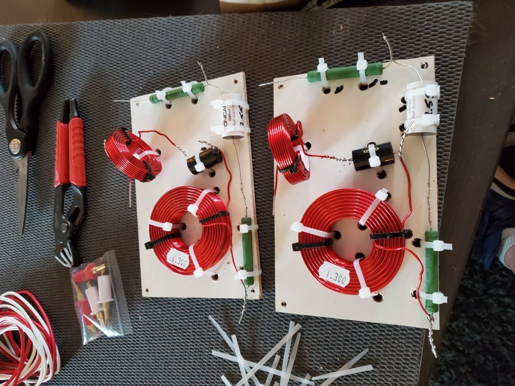

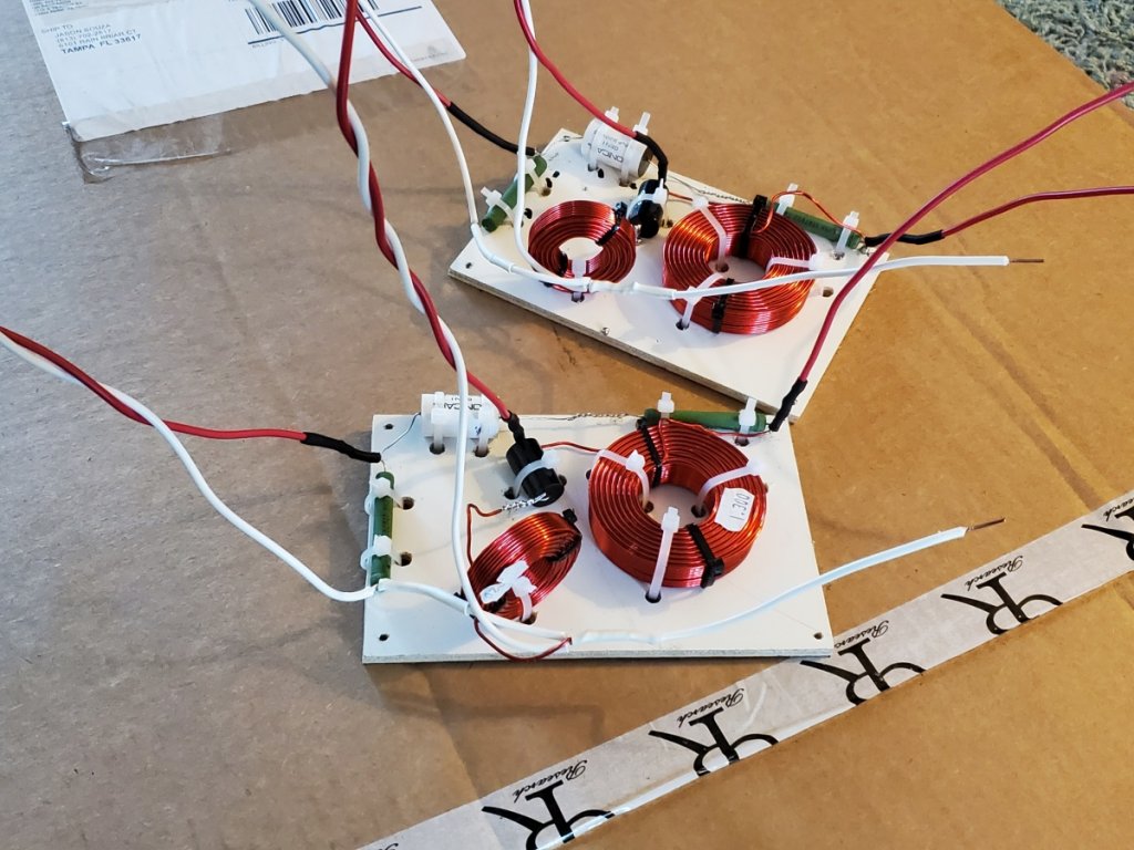

Finished the RP-600m upgrade today. It was my first time in the DIY world. Overall the process was pretty smooth. I used a lot of of the info and pics from this thread to get through it so thanks for all the info!
Overall impressions with a couple hours of listening: I hear stronger and tighter base and midrange. The top-end definitely seems toned down to me. Not as sharp or forward as they were. I also hear more clarity, I assume from the tube connectors but I did not wire up the jumper wires to the original binding posts so I can't be sure. I'm super happy with the results! Now I just need to figure out the hum from my phono stage to break out some vinyl.
