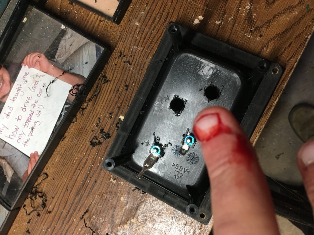

It would not be a project of mine unless blood was involved.  I did start by drilling out the binding hole with a smaller drill bit and worked my way up.  I think the jump to 7/16" was a bit too large.  The cup swung around resulting in the flesh wound.  I used a c clamp to finish and do the rest of the holes, (while my wife laughed at me).  End of the day it worked and tube connectors installed.
