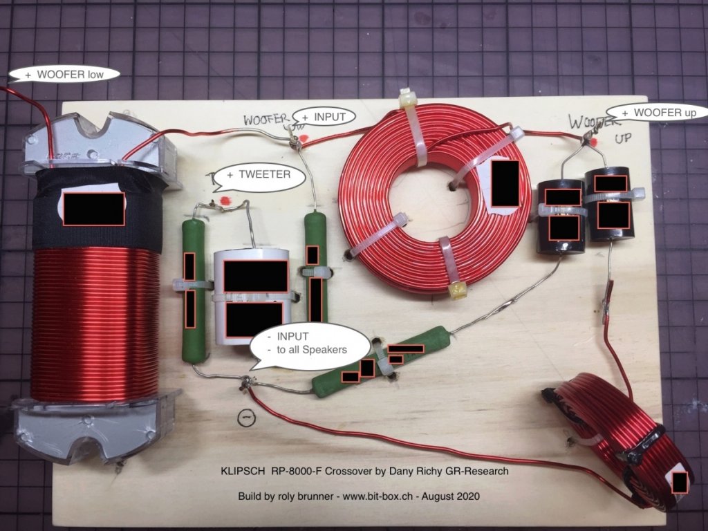

Danny please help Klipsch RP-8000-F Upgrade
« Reply #181 on: 3 Aug 2020, 05:13 pm »
Maybe Danny can help me here:
Please have a look at the "speech bubbles" ...
Is this way of connection okay?
In particular the Input + and Woofer low +.
I m confused .. sorry ..  :icon_lol:
Thanks for help.
roly

Danny Richie
Re: Danny please help Klipsch RP-8000-F Upgrade
« Reply #182 on: 4 Aug 2020, 02:43 pm »
Thanks for help.
roly
Check the wiring diagram. The tweeter has reverse polarity.
« Reply #183 on: 4 Aug 2020, 03:07 pm »
Thanks Danny - But sorry, i'm not a pro. I do not understand what to change ..  :roll:
When I compare other pictures, it looks the same.

Re: Klipsch RP-600M Upgrade
« Reply #184 on: 4 Aug 2020, 03:12 pm »
He's saying to be sure to connect the positive end of the crossover to the negative terminal on the tweeter, and the negative end of the crossover to the positive terminal.
« Reply #185 on: 4 Aug 2020, 03:17 pm »
[/quote
Oh ! I didn't note that ! And did not ..  :oops:
I'll change it immediately  :icon_lol:
Thank you for your help.   :thumb:

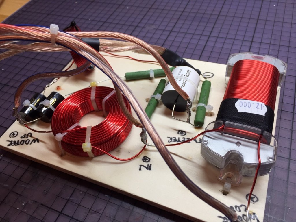

Here a picture of my build so far ...

Danny Richie
« Reply #188 on: 4 Aug 2020, 04:04 pm »
Correct!
And if you don't flip that polarity then there will be a huge hole in the response.

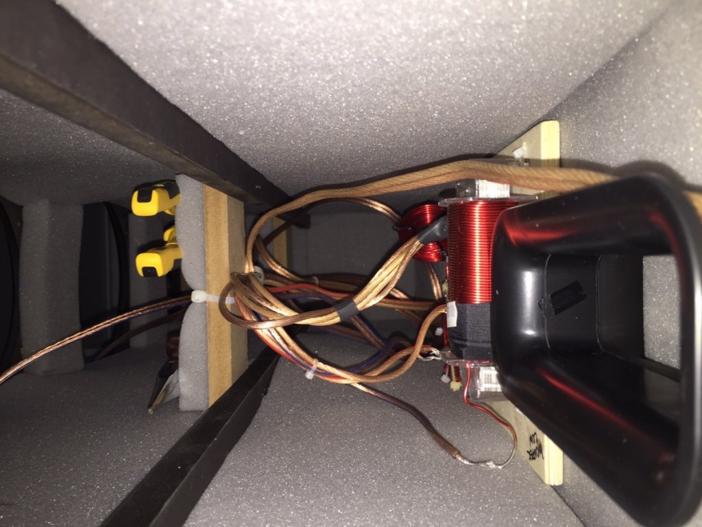

Update KLIPSCH RP8000-F with GR Crossover.
The second speaker is made. Used other cables. See pics.
Well, i can't hear a difference between them (because of changing the cables). So no sense not to use Dany's cables.
