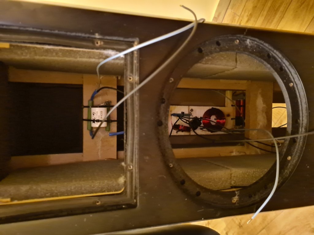

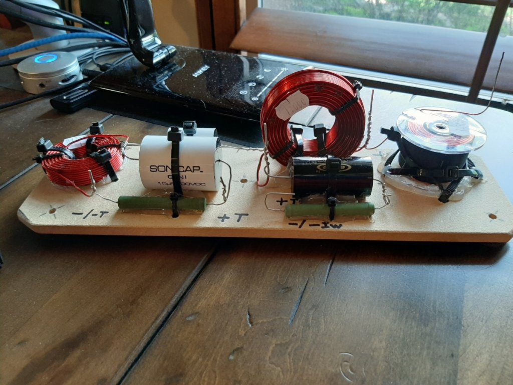

Hey guys first post here, got my Rp8000f kit in so I'm starting to put that together. Just posting to see if you guys can just check it out see if it looks ok. I basically just copied what Homer did on a previous post, his layout made the most sense to me.
Danny Richie
Re: Klipsch RP-600M Upgrade
« Reply #145 on: 4 Apr 2020, 09:40 pm »
If you connect your wiring on it correctly then you have it. All of that looks good.

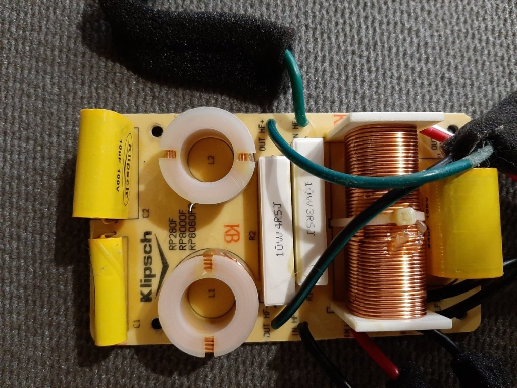

This is a still photo of the OEM crossover for the RP-8000F.

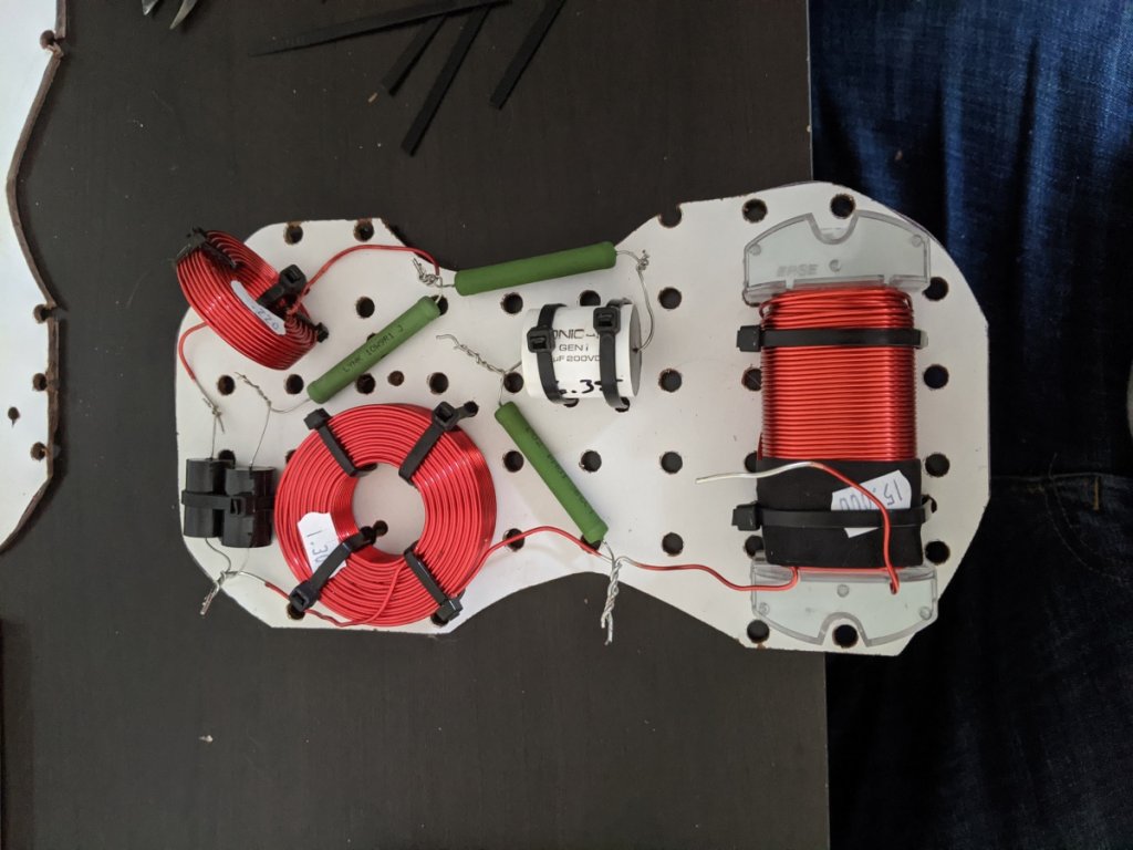

In case anyone is looking for a layout example to consider.  This is the GR Research cross-over layout I used for the Klipsch RP-504C center channel.  It measures 3.5" x 12".  It fits very well on the bottom all the way to the side behind the binding post cup.

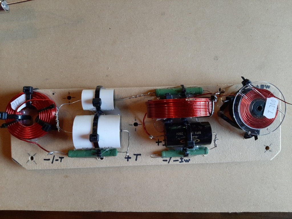

I made a "cut sheet" for the no-res sheet I used on the RP600M kit.  I thought I'd post it here to save others the time who may be assembling the same kit.
This is awesome!! I just used this to trace out my cuts - thank you for doing that!!
