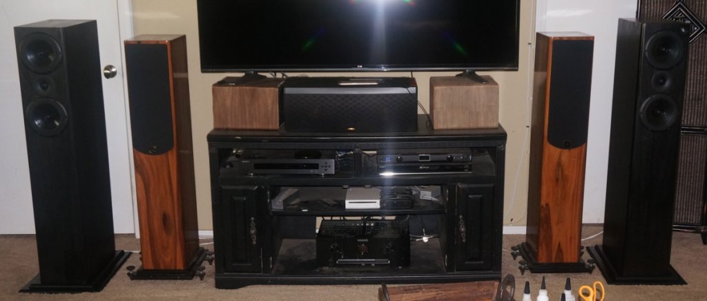

Here's the pics Jay's talking about, X-MTM Encores in black, N3s in Pau Fero veneer.
Mike

Those look great. There’s a gent here in town that has the xstatics and I’m gonna try to go listen to them. I’m considering those studio monitors, and these x-mtm towers. Do you have any thoughts on how these might compare? It’s so hard to know without being able to listen ahead of time lol.
Mike
