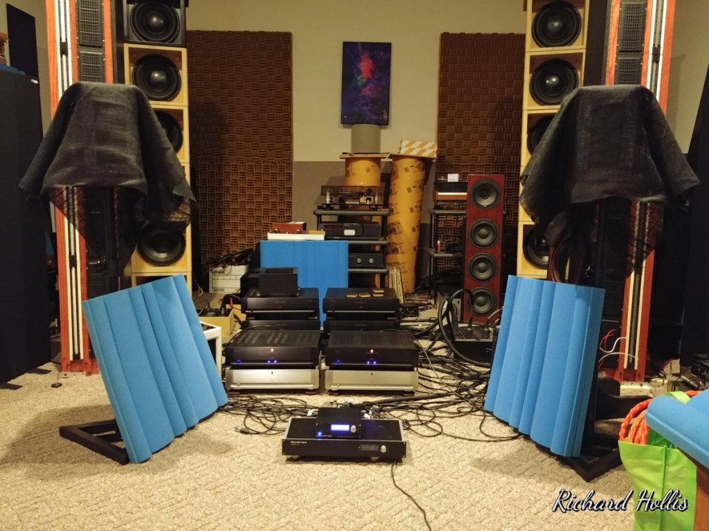

The next generation open baffle planar speaker begins. Meet the Magnetar open baffle planar wide range speaker.
Have been working with a new push-pull planar driver that is designed for open baffle use. Using a test folded baffle design, and doing the digital crossover with the dspMusikLCD 2x8, this is the farfield response in my room with first reflections removed. Adding in some first reflections goes down to 200Hz for crossover to the 3x12" servo subs wing the Rythmik Audio HX300-12OB servo amp and GR-Research 12" OB servo subs..This is not a speaker sensitivity measurement calibrated to 2.83V output.
The frequency response is +/-2dB form 300Hz to 22KHz and will be better than that at the low end. The driver specs are 103dB/1w/1m on a standard test baffle.
Will be working on the production baffle and working with the new dspNexus digital crossover as they become available. These will not be DIY kit speakers as The Monoliths are.
The initial listening sessions are these will be a force to recon with!

The Magnetar OB speakers can be stand mounted to separate them from the servo sub cabinets.  As in this picture with the servo subs near the front wall and the planars in more optimal spots for the mains.
Getting ideas for grill cloth to form fit it to the speaker baffle.

« Reply #5 on: 16 Jan 2020, 03:27 am »
The Orchard Audio BOSC GaN monoblock amps have arrived and connected with 18" speaker cables to the single planar in the baffle.  Using the dspMusikLCD 2x8 as the digital crossover driving balanced inputs to the amps.
The crossover to a pair of 3x12 OB servo subs is working and will be tweaking levels.
So far very impressed with the amp sound driving the planars and integration with the servo subs.
The final baffles are still in work, so will take pictures once they are done.

Will do off axis responses with the new baffles.
The last two HX300-12OB servo amps to run the servo subs are here and the Speakon connectors installed.  These are for the two 6x12 OB servo subs with 4 HX300-12OB amps.
Will get the speaker levels dialed in this weekend.
HAL
Re: Meet the Magnetar speaker
« Reply #10 on: 21 Jan 2020, 12:41 am »
The four Rythmik Audio HX300-12OB servo amps are now running the two 6x12 OB H-Frame servo subs.
A fun visceral experience with this bass with the Magnetar planar running everything above 200Hz.  The Orchard Audio BOSC monoblock amps are directly driving the planars.
The dspMusikLCD 2x8 is doing digital crossover for the system with everything running balanced.  Absolutely no noise from the system in my room when nothing is playing.  Great black background.

« Reply #11 on: 27 Mar 2020, 07:38 pm »
The dspNexus 2x8 is now running the Magnetar speakers as a 2-way system.  Using the new AKM AK4499 DAC modules to run the system with two 3x12 OB servo subs.  The planars are driven directly by the BOSC amps.
After the measurements with the latest prototype open baffles for the planars, the updated digital crossover design sounds great mating to the servo subs.
Now for a lot of listening to finish the voicing.   :D
