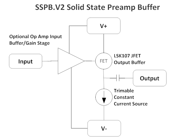

The following items distinguish the SSPB.V2 from what I understand of the B1 or similar buffer designs.
1) 2-stage split voltage power supply - +/- 15V SMPS followed by +/-12V linear. This makes it possible to achieve close to zero DC offset and thus avoid input/output coupling caps.
2) We use an adjustable constant current source with a trim pot on each channel to adjust for near zero DC offset. If things change over time you can always tweak the trim pots to get back to near zero offset.
3) Accommodates an optional op amp gain stage with adjustable plug-in gain modules. Technically this makes it more of an active preamp rather than a true buffer but this is optional and not required. If you want/need gain you can have it. Plus the design is not married to any particular op amp as long as it can fit into an 8 pin DIP. If your op amp of choice is SMD only you'll need an SMD to 8 pin DIP adapter.

Morten,
LSK170 JFET or what you have shown in your diagram  :wink: ?
Best,
Anand.
tortugaranger
  • Posts: 1779
    • Tortuga Audio
Re: SSPB.V2 Solid State Preamp Buffer Kit
« Reply #4 on: 29 Dec 2019, 10:11 pm »
Morten,
LSK170 JFET or what you have shown in your diagram  ;) ?
Best,
Anand.
Duh!  :duh:   Yes it's an LSK170. #dyslexicaudio

ha !  I actually looked up the LSK107..   super secret jfet  8)

The SSPB.V2 kit was planned to be released on Jan 14th. Due to last minute design tweaks and the Chinese New Year (raw circuit boards) we now anticipate release and shipping of kits by February 10th. The pre-order 20% discount has been extended until then.
The good news is we are very pleased with the overall performance of this updated preamp buffer with it's dual stage buffer: op amp input stage and JFET output stage.

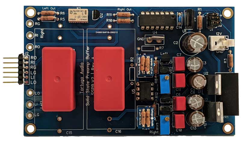

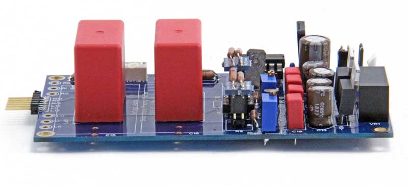

« Reply #12 on: 25 Feb 2020, 05:31 pm »
First pic of a fully populated board.  :thumb:
More info on the SSPB.V2 here:  https://www.tortugaaudio.com/products/diy-preamp-components/sspb-v2-solid-state-preamp-buffer-board-kit/
Also, here are the detailed kit instructions (still tweaking the details): https://www.tortugaaudio.com/documents/product-documentation-kits/?section=sspb-v2-kit-assembly-instructions

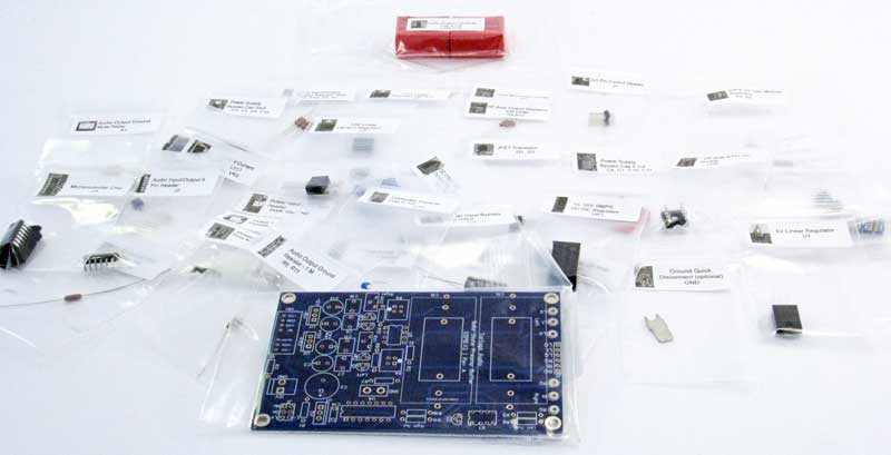

We might have been remiss in not mentioning that you can also order the SSPB.V2 Solid State buffer board fully assembled and tested.
$219 - DIY kit (bag of bag of parts)
$299 - fully assembled and tested (single populated board - but still in a bag  :thumb:)
