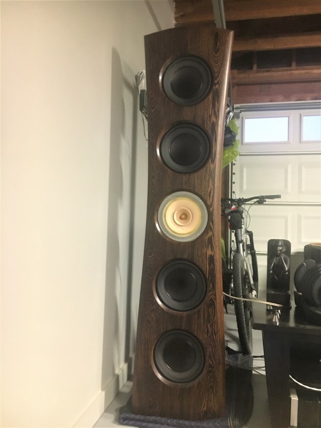

It's kind of a long story that I will try to keep short. I built these speakers for a customer back in 2012 and ended up getting them back on trade late last year. Having retired back in 2017 and downsized I no longer have a real listening room so they ended up in my little exercise / hangout space in the garage at our new place. Sorry in advance for the feeble pics....
In the picture above they have a 10" coaxial driver in the middle position. When I heard about the Lii Audio drivers and how good they were I wanted to try the Crystal 10's in place of the existing coaxial. Having retired early I have to curb my audio spending a bit so I then set my sights on the Fast 10 when Lii was liquidating their remaining stock. Unfortunately the Lii 10" drivers have a rather larger OD of about 10.75" and wouldn't fit into the existing cutout on the rear of the baffles. While I was hemming and hawing about having to enlarge the openings at the rear of the baffles I got a really good deal on the Fast 8's. Turns out their OD was pretty much the same as the existing cutout in the front of the baffle. So I just pushed the whole driver from the rear out more or less flush with where the driver cut out bevel started. So now they looked like this.
I didn't much care for the color of the new driver or seeing the entire frame so I decided to add grill cloth to make them blend with the edifice a bit better. And while as I was at it I added grill cloth to the four woofers too. Ended up looking a lot cleaner with all the drivers hidden.

Thanks for posting pix. Bass reinforcement indeed. Pics are not feeble.
Nice build. Not what I was expecting to see but they look great.
So the entire baffle is open baffle? How thick is baffle?

Yes, it is full open baffle. Here's a pic of the back, the 3" support tube is filled with lead shot and just that support tube is a two man carry.
The baffle is 1.25" (31.75 mm) thick solid wenge. I bought 2" thick material and re-sawed it down to about 1.5" thick. With the remaining 3/8" thick material my good buddy built three of the best sounding guitars he has ever built. And he had enough left over to build a Weissenborn too.
It's a pain in the ass to work with, very brittle but maybe that's why its sounds so good.
