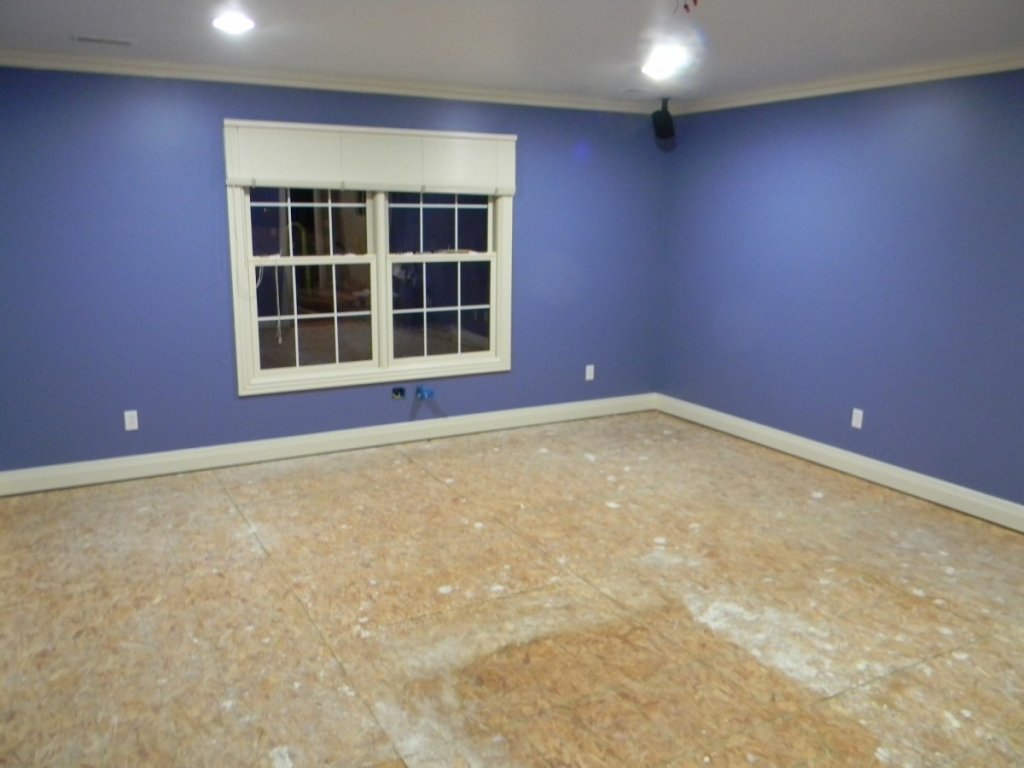

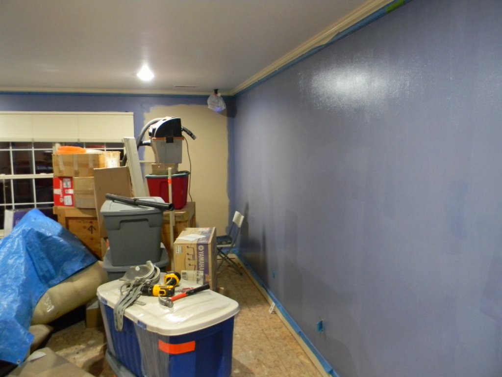

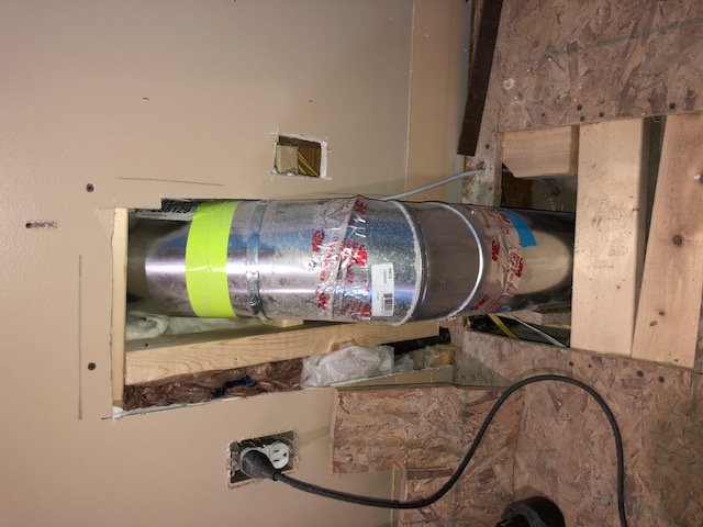

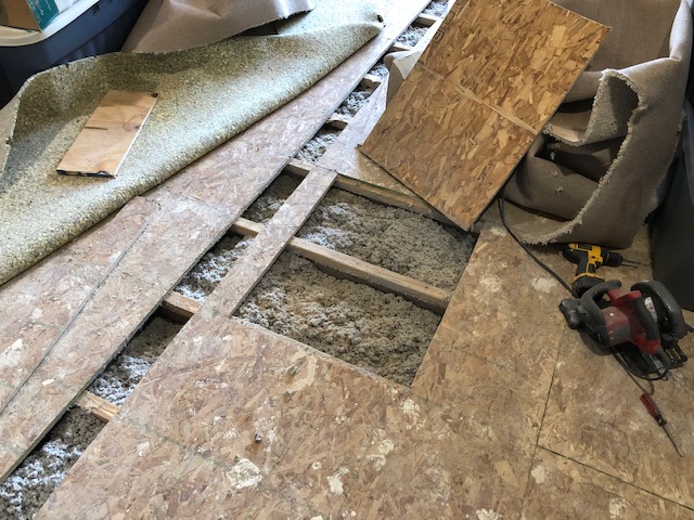

A couple of pics where the behind the scenes work had to get started. Presently I am working on the laundry room project but my MLV and flooring has arrived already and I'll let them acclimate.
The kitchen is directly below and we will change to a gas rangetop. So I will need a 500 cfm fan unit and real duct instead of those goofy MW non-vents. Luckily the attic is right next this room and I can shoot it out there and get a roof vent in later. Unfortunately there is a 10 foot ceiling room right next to the kitchen so I had to go up and then over and out.
I ran a 20 amp line and a Cat 7 along this wall down and around the corner. Darn engineered trusses were running perpendicular and I had to feed the wires thru each one keeping them separated accordingly.
Then I cut up the center after deciding that adding blown-in insulation couldn't hurt for a little extra dampening in the floor. It cost me $250 to rent the machine and buy the bales.

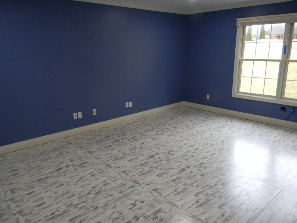

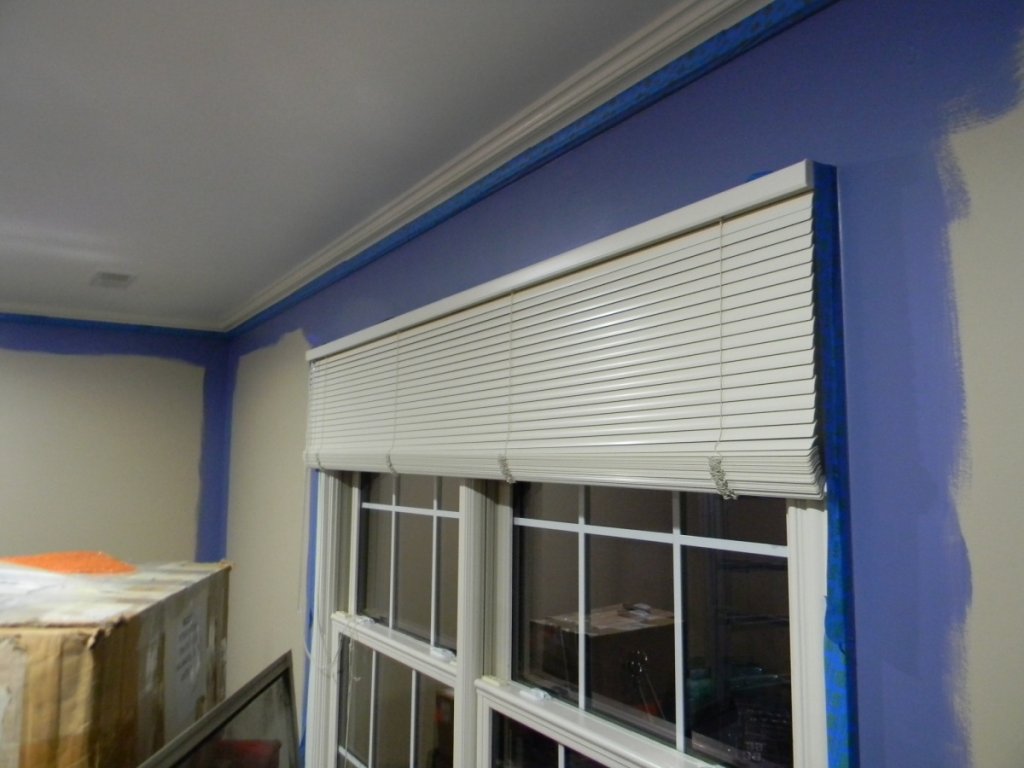

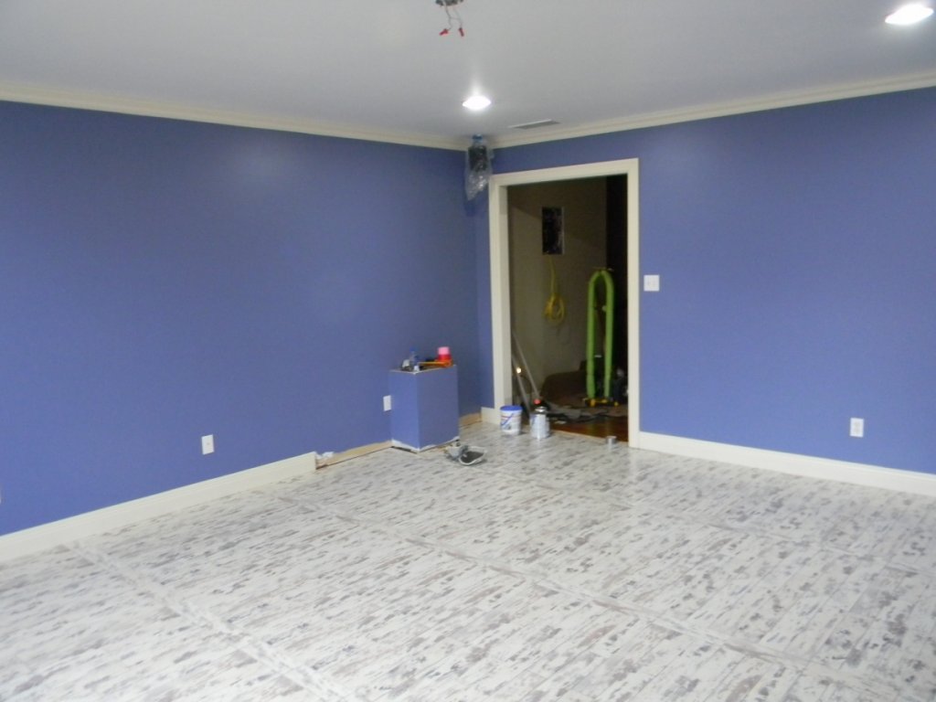

Painting almost done. Ceiling is Cool White and walls will look darker after the second coat. After the Thanksgiving herd leaves I hope to install the MLV and flooring Sat and Sunday after I move all this out and throw the carpeting out the window.

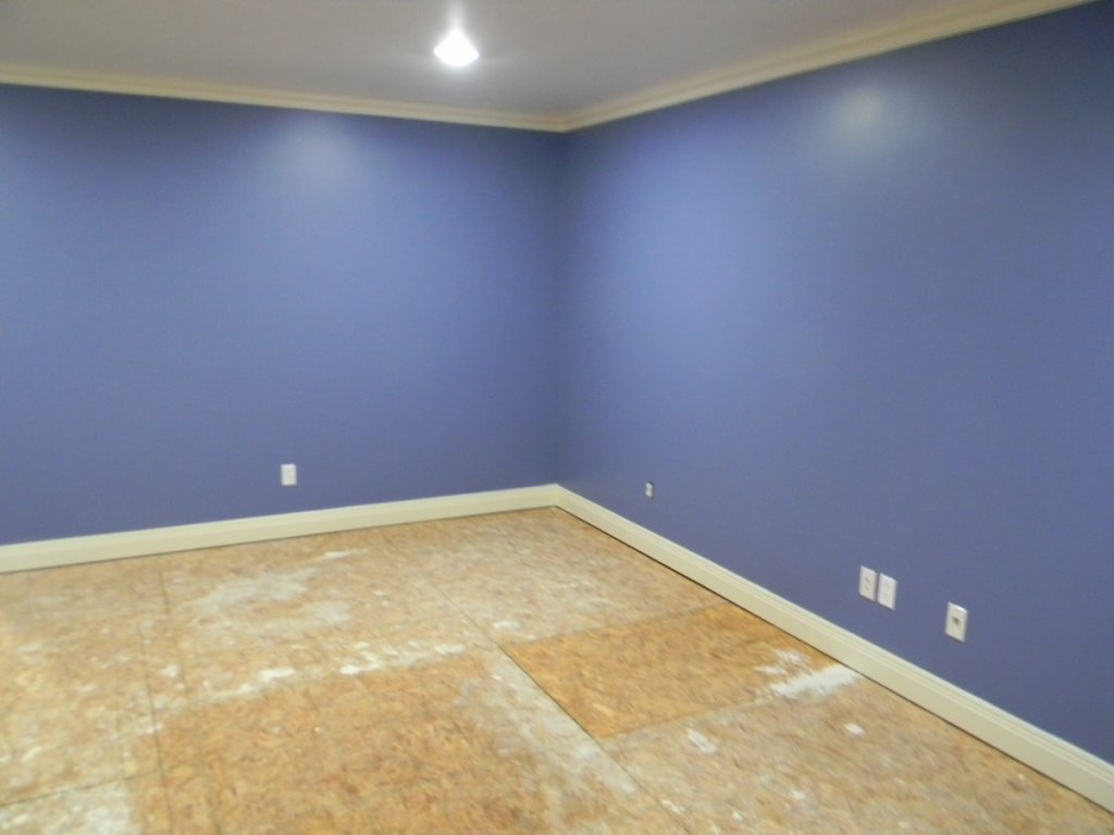

Painting completed:

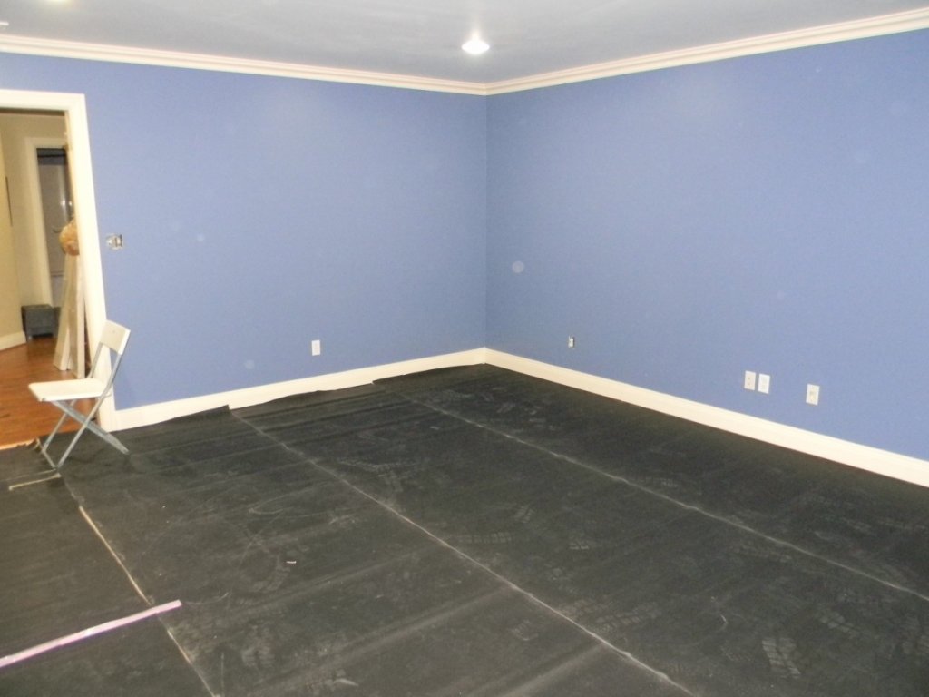

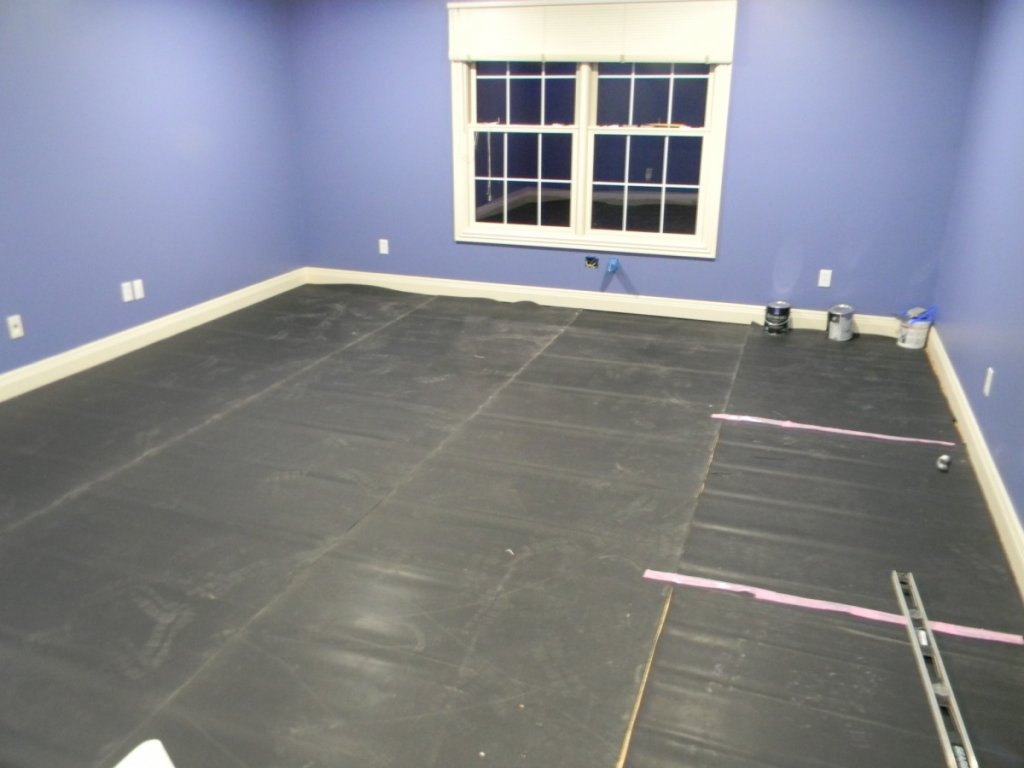

Mass loaded vinyl installed. 300 lbs of it.

Flooring done today. I need to paint the shoe molding and then get it installed. Just purchased two 30 inch door slabs for a 60 inch barn door entry.

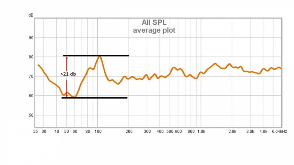

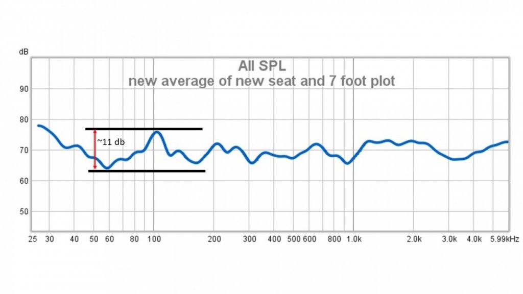

I'd just about lost my mind trying to get a smoother room response. As most of you know, the room is the room, and you can move your speakers around and you can move your seat around, and you can try and treat the snot out of the room.
I was stuck with this response for a few days while I worked on some other projects. A huge peak to peak range and nowhere near a preferred +-5 db band.

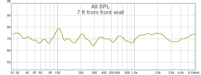

I wanted to make things better and was not sure which route to take. I kept trying to figure out if the speakers were not where they should be or was I sitting in a bad spot. So I started reading and googling and came across several of Ethan's discussions which helped quite a bit. It was a coincidence I was on the phone with him in the morning ordering another bass trap stand and never thought to ask him about this.
https://ethanwiner.com/basstrap_myths.htm
The above led me to read the links within that page and add two more tools. Very similar to Bob Gold's mode tools.
I tried moving the speakers toward the side wall and the front wall and found very little effect in doing so. I was searching for those 1/4 wavelength relationships and what distance was influencing others. My room width is the biggest culprit to the nulls and peaks.
So then I got crazy and put the mic at 7 feet from the front wall for a simulation of a very near field listening position and see what happened:
So a much better result with a much smaller band - pretty close to +-5.

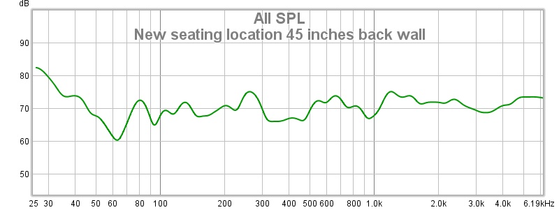

Looks like I should move my seat but certainly not up into the equipment rack. What if I moved it backwards to try and hit a sweet-spot in that territory that mirrors the front of the room?
So I started measuring in 6 inch increments from my 11.95' seating position toward the back of the room. At first I moved the speakers in and out to see if they played a part in this move and once again I could not get much swing by moving them. I had to find a complementary location that negated the peaks and nulls influenced by the room width and ceiling height.
Eventually I got to this spot about 45 inches from the back wall:

An average plot made from the new seating and the 7 foot from front wall plots:
And yes!, it sounds much better sitting in this new location. I like the intimacy of the closer location and will miss the involvement at that close range.
I get more instruments moving outside the speakers from further back believe it or not.
I use a laser pointer to adjust the tweeters to the same relative locations. Typically I get the tweeters to cross just behind my head so I point them to my shoulder width.
