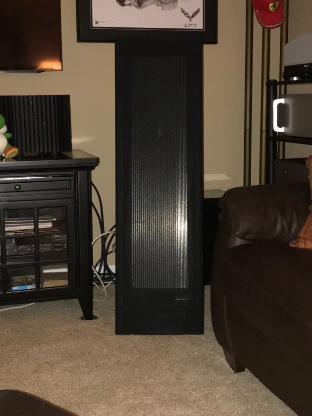

Just got a pair of these from Magnepan.  Pretty freaking awesome.  Youse guys need to come over sometime to hear these things.  Its like a 21st Century Quad ESL-57.....its really that good in the midrange.  A couple caveats - they need a lot of current to drive them.  My Aleph 5 works, but just barely.  The second is they run out of poop at about 50 hz.  I tied them to an Outlaw subwoofer and they work pretty well, however.  Definitely a speaker that needs some augmentation, LOL.

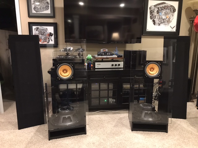

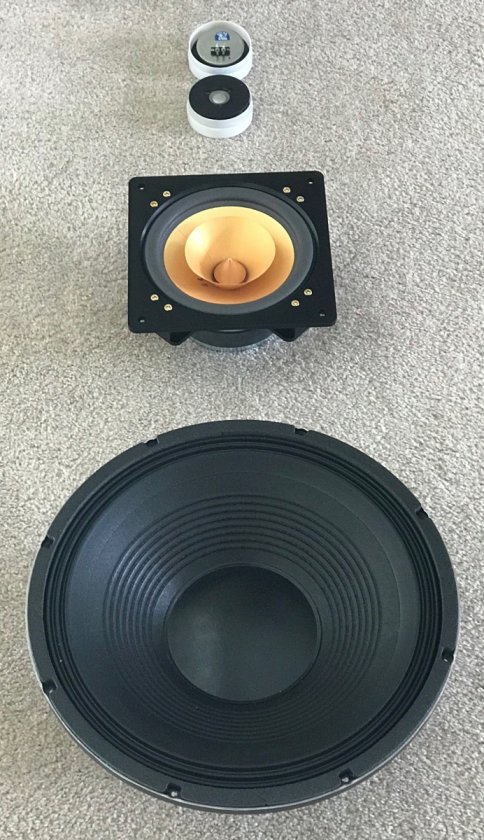

Hi, guys, I am actually waiting to do a two-fer for you guys.  The SECOND speaker pair may be more impressive than the Maggie LRS speakers.  I am in the process of finishing up a pair of Pass / Linkwitz SLOB's - that is Slot-Loaded bass augmented Open Baffles.  This speaker design combines a full-range 8" Cube Audio driver set in a 20"W x 40"T open baffle and a 15" Eminence super woofer which propagates through a 3"T x 16"W slot just below the baffle board.  This is Pass's reference speaker and only about 2 pairs exist - Herb Reichert of Stereophile heard it about 8 months ago in Sea Ranch, CA and said it was the best audio transducer he has ever heard.
Here are some pics of the cabinets which master carpenter Jeff McCabe is finishing for me, and the drivers.  The speaker is bi-amped using a Pass Aleph 5 on the bottom, and a First Watt J2 SIT amp on the top.  I will receive the cabinets from Jeff in about 1 week.  The only change I made from Pass's design is the use of a 1/2" thick piece of clear acrylic instead of 3/4" birch plywood.  (The acrylic has a much higher density but lower modulus - great for damping.)  The crossover is under construction at Casa de la Binger and should be ready in a couple weeks.  It includes equalization to flatten the driver response out to +/- a couple dB from 40Hz to 20KHz.
I am also looking at adding a dipole set of Coles Supertweeters at 8Khz and up to improve the Cube Audio driver's high frequency polar response.  The last picture is a 2001: a space odyssey inspired layout of the drivers.  I expect to be ready for an audition by about Thanksgiving time.  I will set a date (probably a Sat. afternoon / evening) in about 1 week.

Can’t wait to hear both of these.  Which Eminence woofer are you using?

It’s a Definimax 15 - 8 ohm version.
The star is this crazy Cube Audio 8” FC8 Driver - it is the most innovative direct radiator / voice coil driver I’ve ever seen.  Very linear and no hysteresis.  It uses a spider made of phenolic “leaf springs”, but shaped like a set of spiral galaxy arms.  Very cool.

Am curious -- is there a crossover to the SLOB speakers? Or do both woofer and full-range connect directly to the speaker terminals? It is not possible to tell based on these photos if there is a crossover involved.....or what kind it is.

The speakers are bi-amped.  The active crossover was custom-designed by Nelson Pass and had EQ for each driver, as well as a 2nd-order Linkwitz-Riley filter set.  The crossover frequency is about 80 Hz.  The drivers are connected to the amps in positive phase.  The Cube driver is quite efficient and is driven by an SET or a JFET power amp like a First Watt J2.  The low pass is driven by a suitable 60-100W power amplifier like a Pass Aleph or First Watt F5 Turbo (about 140W).
The crossover has stereo pots for both low and high pass.  The pots are set using a pink noise source (CD), a calibrated mike and an RTA.
