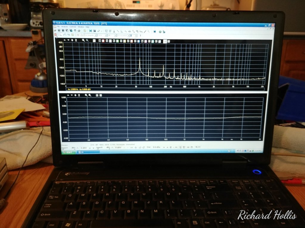

« Reply #45 on: 17 Nov 2019, 12:34 am »

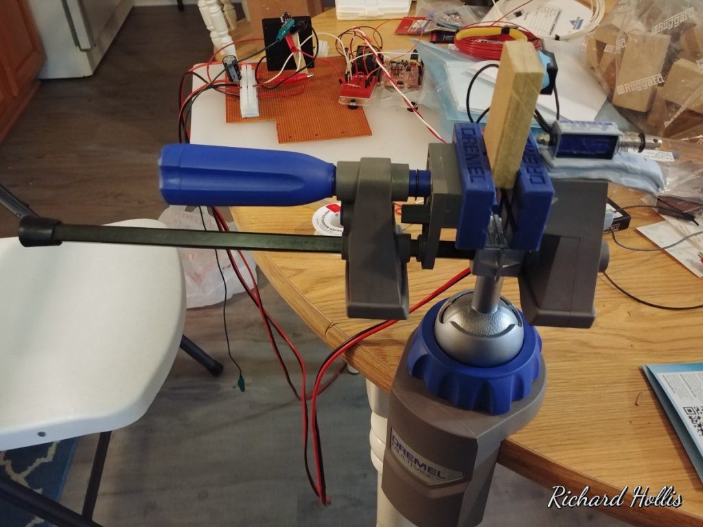

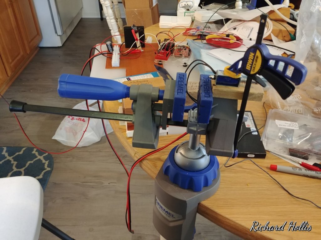

Have the impulse response test setup running and the CLIOwin 8.51 Standard system calibrated. The sensitivity of the accelerometer is being adjusted by the system software in the measurments.
Now to get the impulse generator working and do some trials with MDF to see what the system finds for response.
Some pictures of the new test setup and measurement system.

« Reply #46 on: 18 Nov 2019, 09:00 pm »
Modified the test setup for more stability for the solenoid.  That made the measurements a lot more stable.
Measured all the samples Peter J sent and will be posting response graphs as I get them ready.  There are a lot of them!  :D

« Reply #47 on: 19 Nov 2019, 01:55 am »
I would attempt to have the depth, or amount of material that enters the vise, exactly the same as well as the amount of pressure that gets applied for a consistent result, i'm sure you've already thought of this but it popped into my head after a beer or 3.
Good luck with this, i'm eagerly awaiting the outcome,
Don
HAL
Re: Fun with materials
« Reply #48 on: 19 Nov 2019, 02:02 am »
Don,
Exactly what I did to make the measurements.  Marked the vise for depth and position.  Best I can do.
Now to graph like 20+ samples!  :o

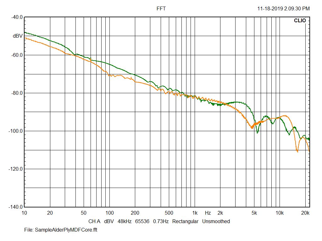

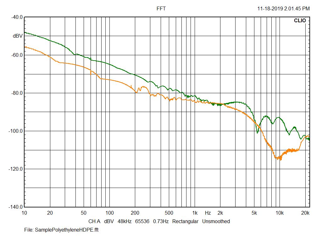

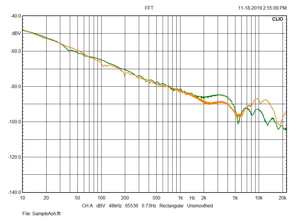

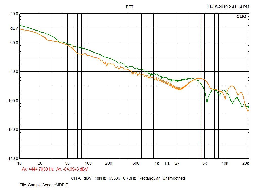

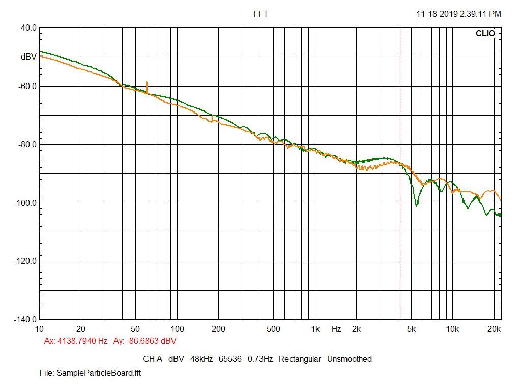

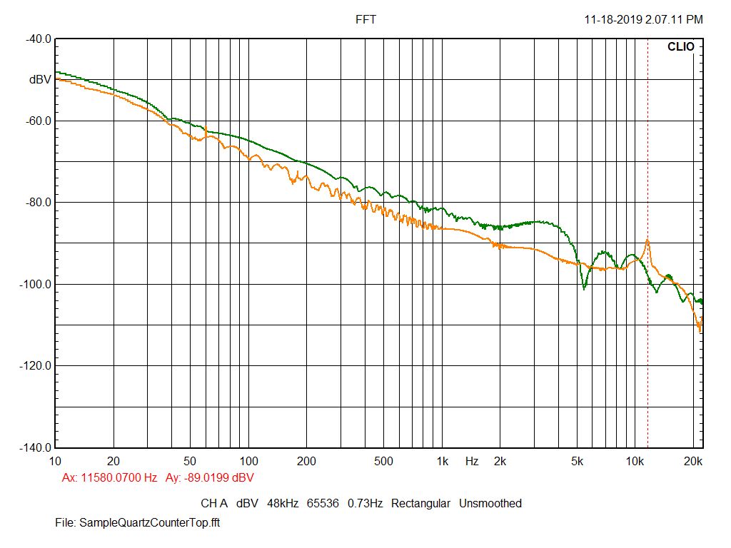

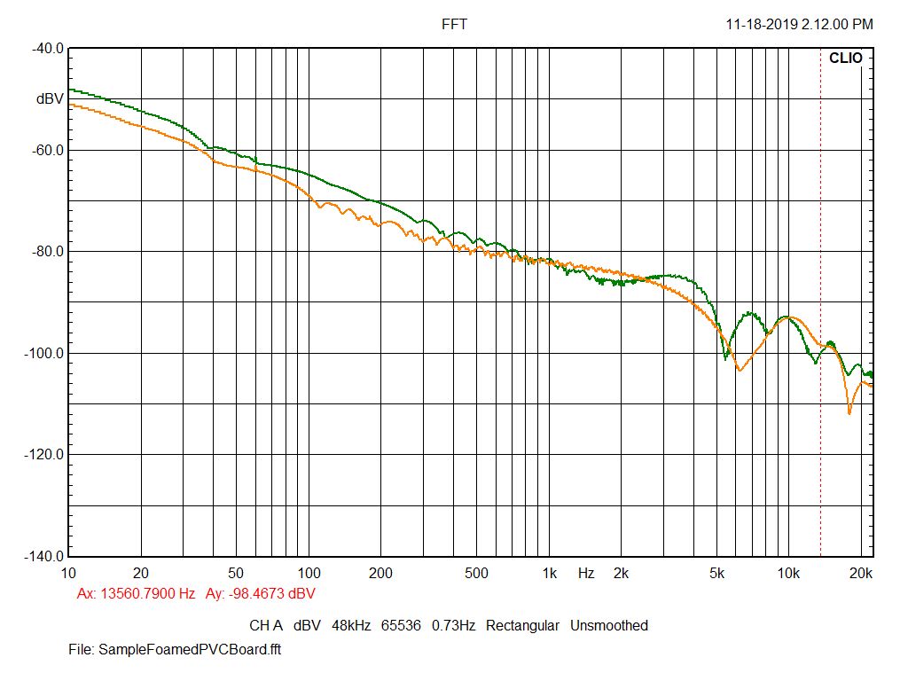

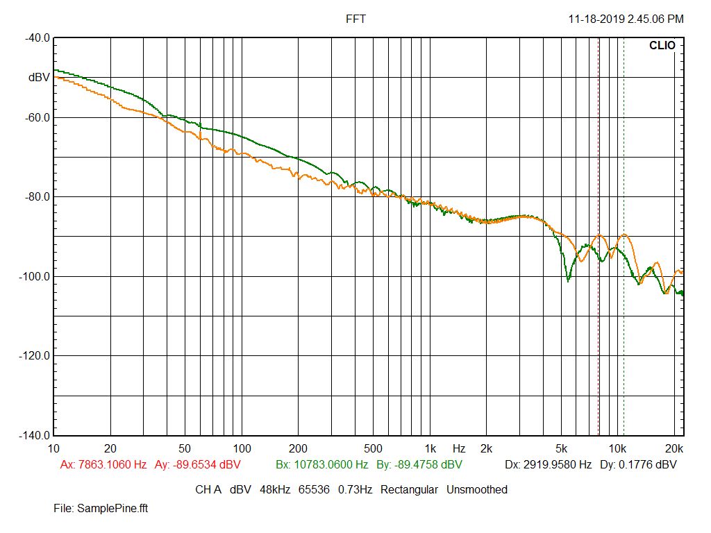

HAL
« Reply #52 on: 20 Nov 2019, 12:58 pm »

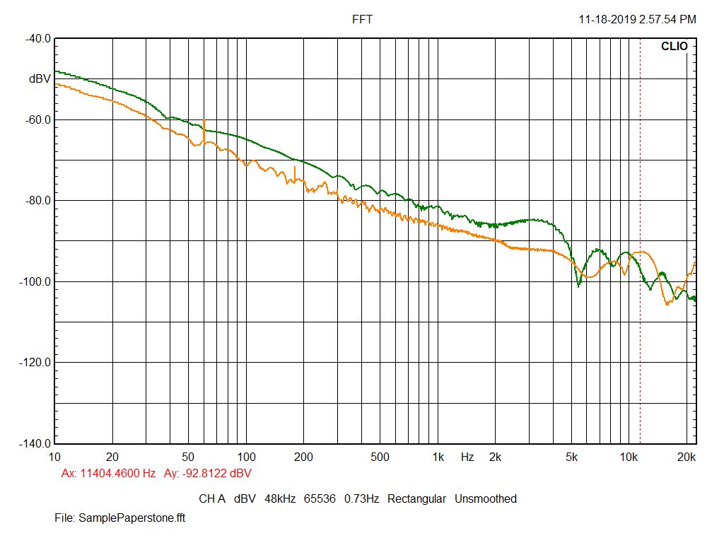

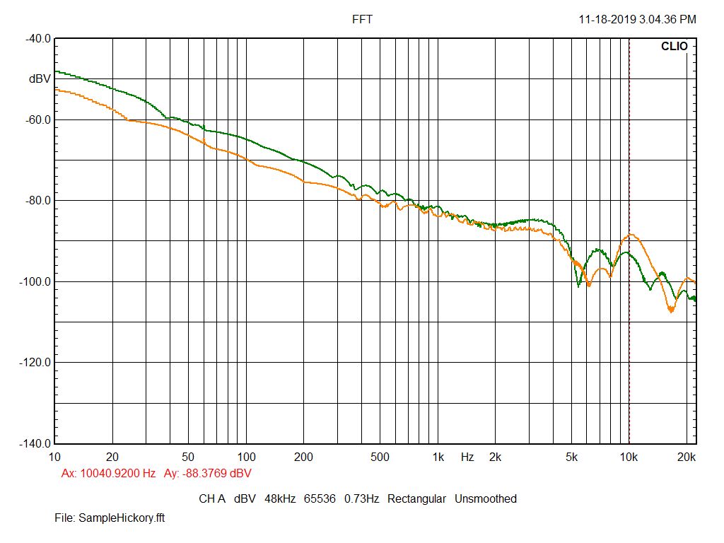

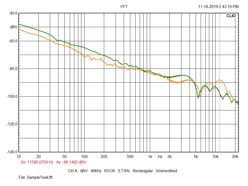

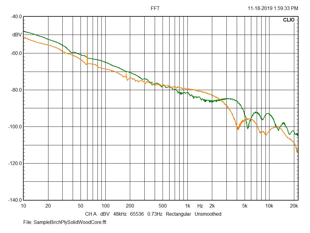

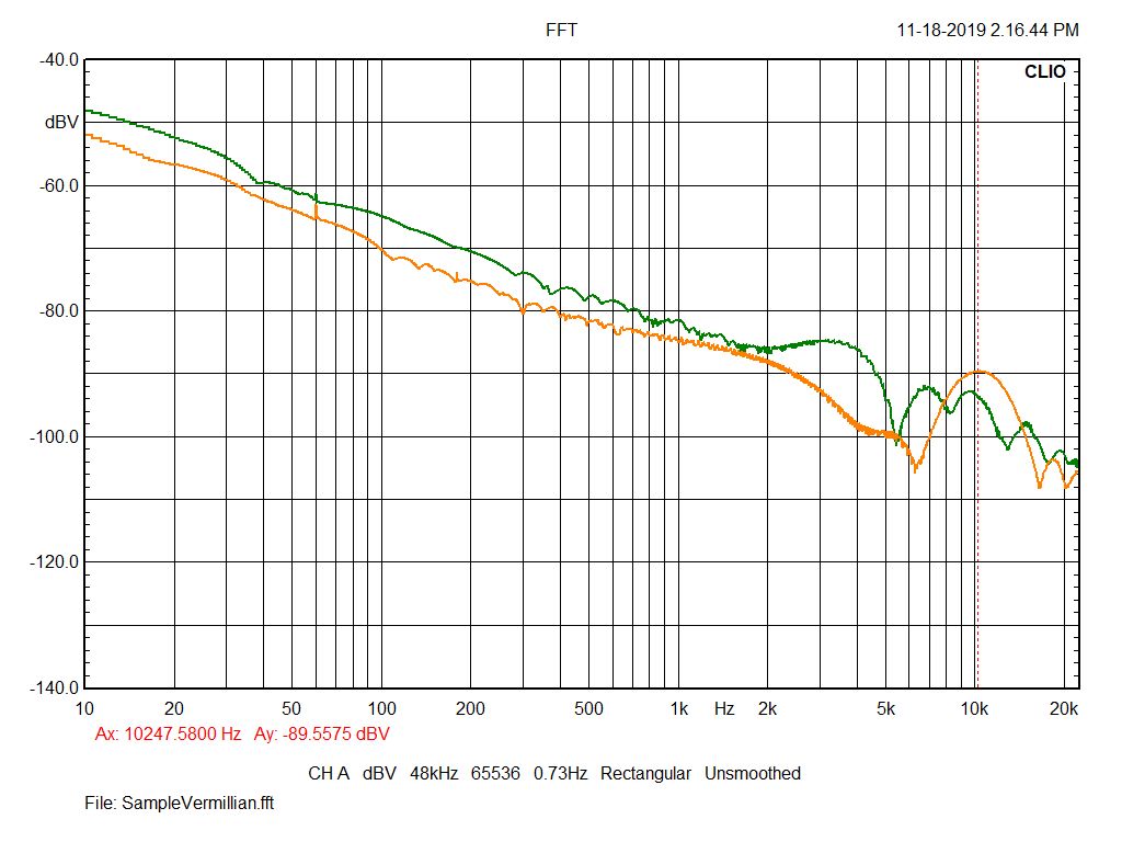

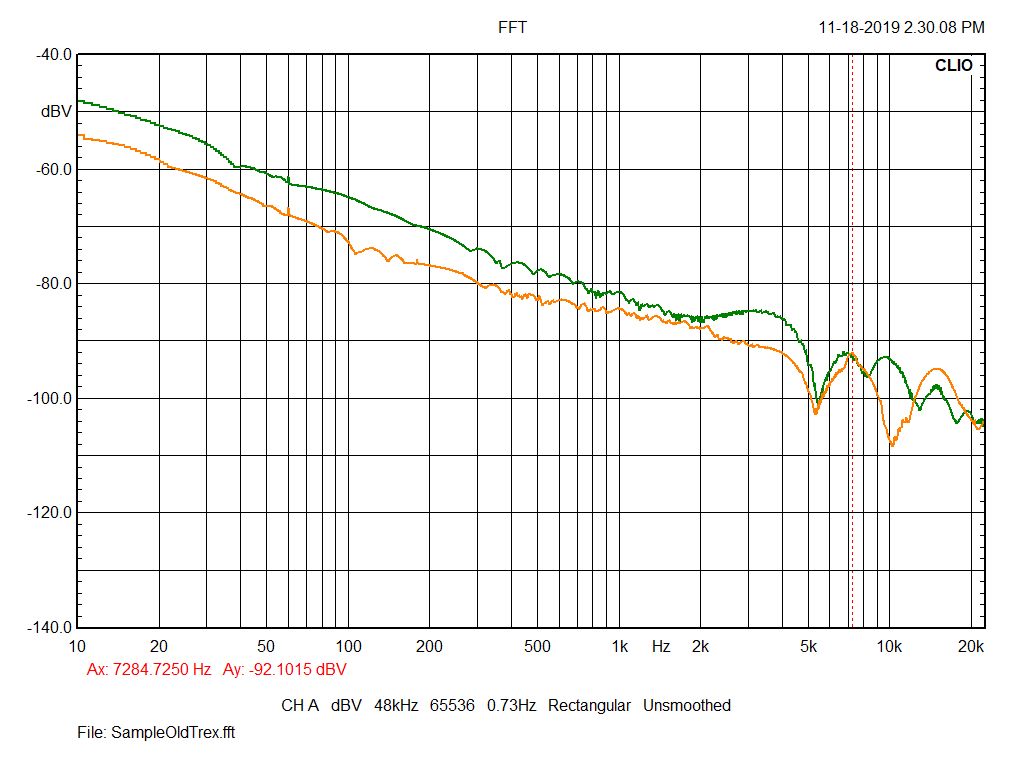

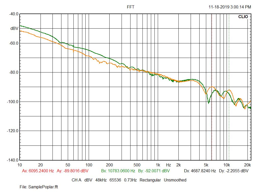

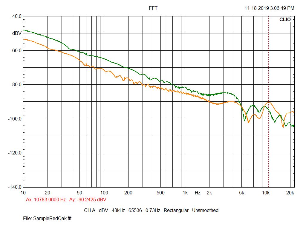

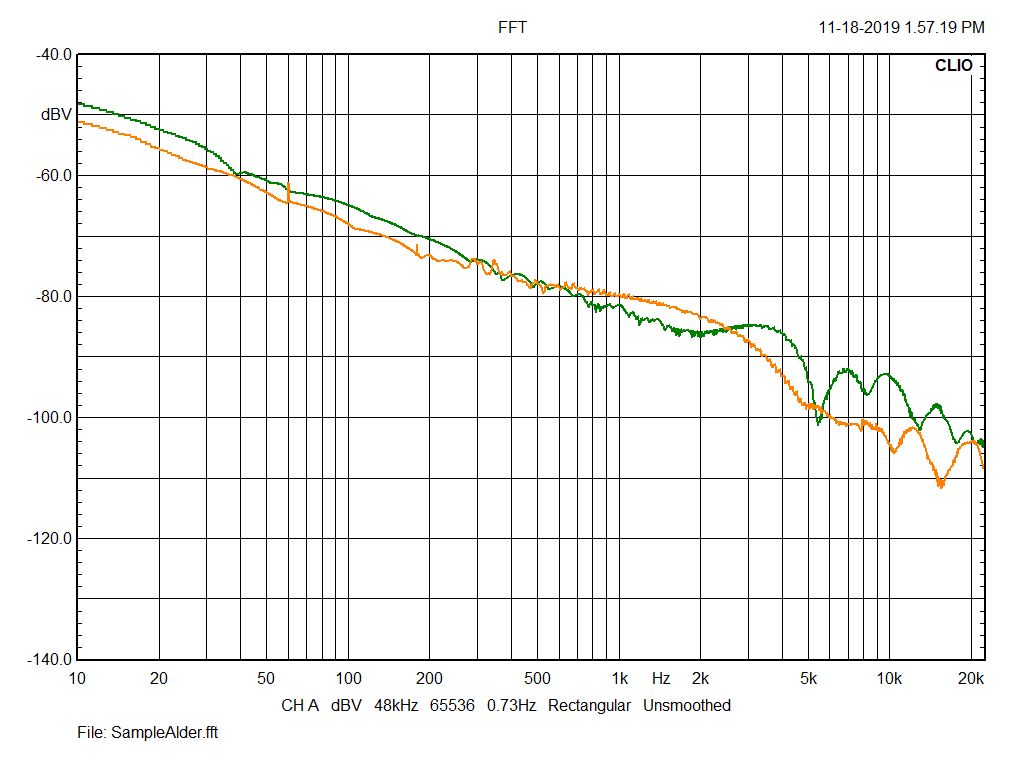

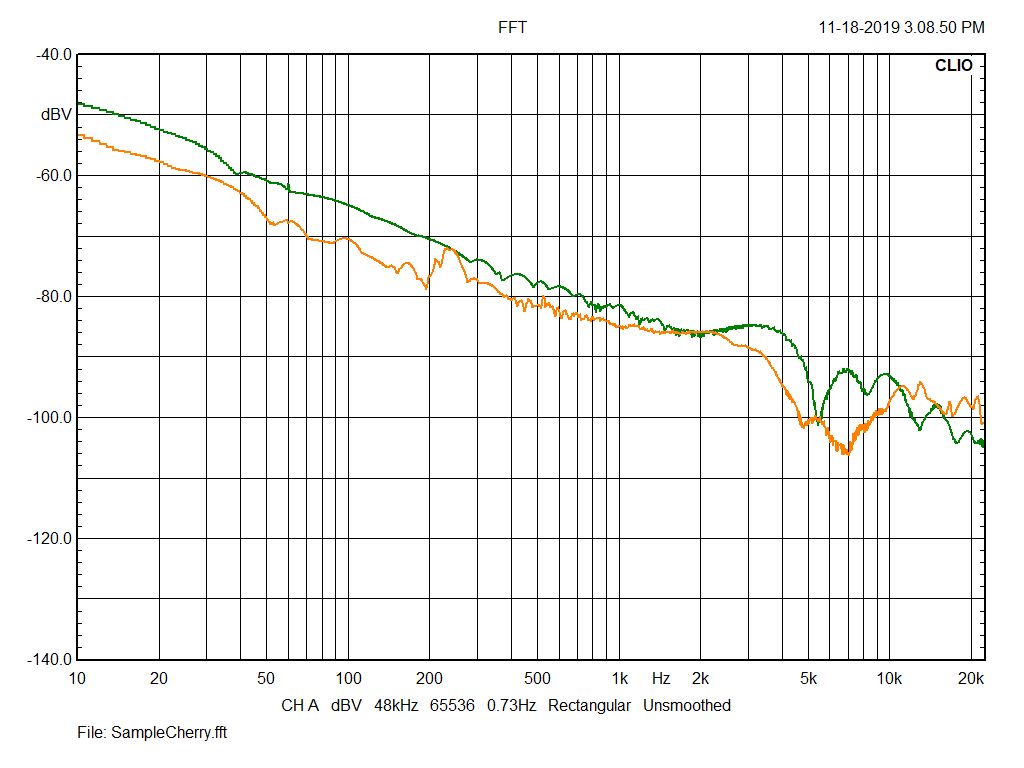

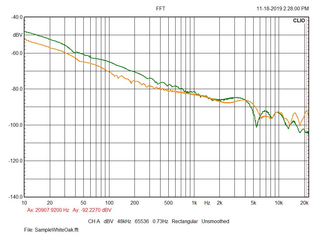

Here are more sample measurements.  Each measurement has the material name as Peter J wrote it on the sample in the title.  The green line is the MEDEX for comparison.
HAL

« Reply #59 on: 20 Nov 2019, 01:13 pm »
The quartz sample was the one with the most pronounced resonance from the test.
Other woods that had damped resonances, I put cursors on them for highlights.
Constrained layer damping materials helped even MEDEX when a 1mm layer was added to the back.  Nothing new, just a way to see the effect.
