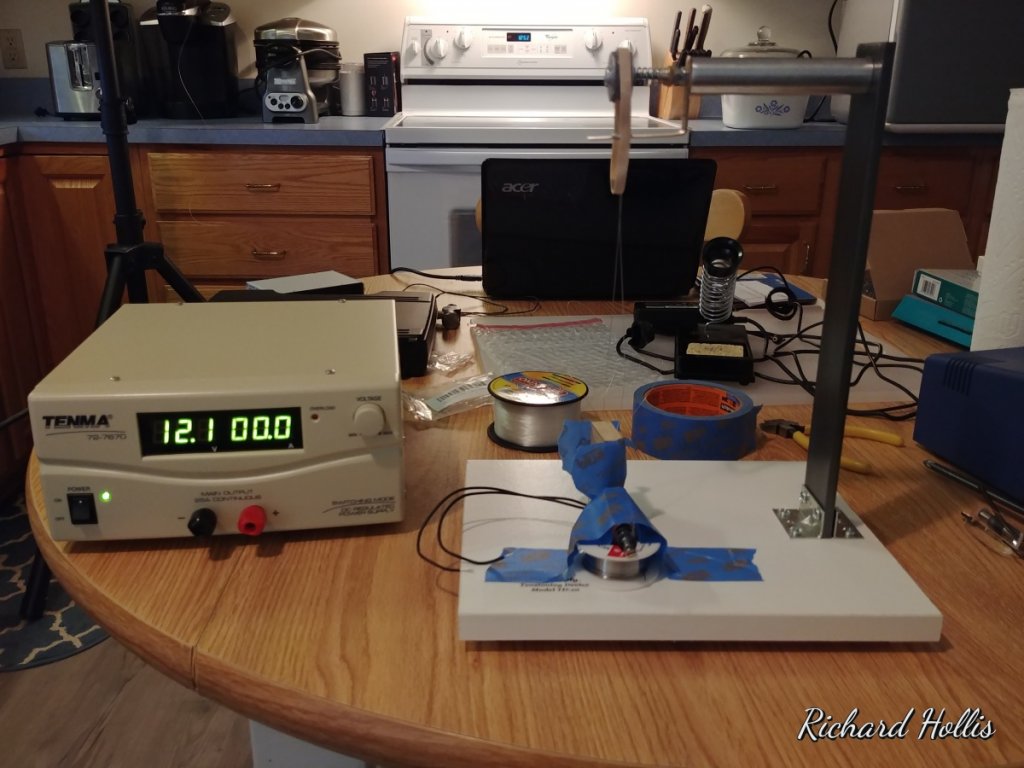

New test jig for sample testing.

« Reply #32 on: 27 Oct 2019, 06:03 pm »
New test setup is running.
Had to design a simple variable length pulse control system with an Arduino and BJT/Power MOSFET driver for the solenoid.  This lets you make the shortest hit on the material before the solenoid will no longer actuate.
The results are similar, but the level is much more stable so easier to compare the samples.

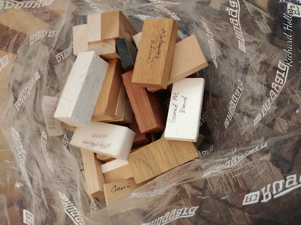

« Reply #37 on: 6 Nov 2019, 08:12 pm »
Peter J sent a big box of material samples to test!   :D
Will get the test setup running and see what I find.
