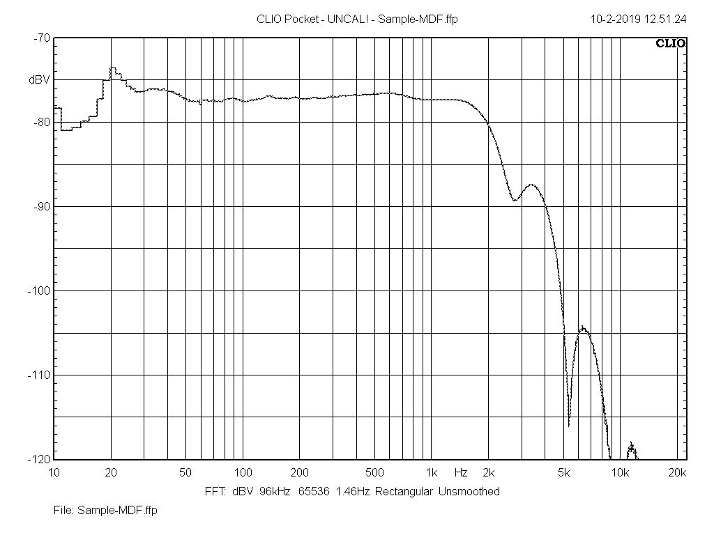

What happens when you put an accelerometer on a piece of MDF and hit it with a ballpeen hammer. Lets take a look.
Audio spectrum 64K point FFT of piezoelectric acclerometer with CLIO.
Love hitting stuff and see what happens!  :o

Exactly my point.  What do different materials have for resonance and damping properties.  The samples have to be the same size for comparison, but usually easy to cut a piece to use from raw materials.  I have tested turntable isolation stands in the past with a different setup, but the same measurement system.  Fun stuff!

The plot I posted is the impulse response of the piece of MDF after FFT processing.   It shows the overall transmission of sound vibration through the sample from the hammer impulse.  Amplitude may change due to how hard you hit it, but overall a good way to test sample.  You typically want something harder than the sample to do the hit.
In the vibration industry they use calibrated hammers (specific mass hammers with an accelerometer attached) and shake tables with accelerometers for this type of testing.  This is my DIY version for trials.
Fun stuff! :)

Please explain/interpret the graph and video results because frankly I don't see/hear anything meaningful in them.  And honestly don't know how much can be discerned from uncontrolled/unmeasured banging or knocking on pieces of wood.  And BTW, all solids can resonant.  No wonders outsiders scoff at audiophiles.

What I see is that MDF doesn't ring especially at any audible frequency (perhaps slightly around 20 Hz), and falls off rapidly above 1800Hz.  Looks like an ideal material for speakers, and very easy to incorporate into a 2 way system with a crossover around 2KHz. Perhaps more important than the above graph would be a look at decay.  That's what would tell more about ringing.

As stated above, this is a standard test technique for materials resonance properties.  Different levels of striking the piece changes the amplitude, but not the overall spectrum.  The less upper end response and lower amplitude are for better internally damped materials.
The wider the frequency response and higher the amplitude, the more the material resonates.
I have never liked a speaker cabinet designed to resonate with the drivers.  You want the driver to stay in one place and resonance means it can move.  I do not like boxes, so open baffle speaker need a stiff, low resonance material to work well.  Hence the reason that most use 1.5" baffle thickness of different stiff but damped materials.  The damping is just as important as the stiffness.  Building a speaker out of steel that is not damped is like making a bell, same for boxes that resonate.
Scott,
Excellent observation.
I am trying to see if a material is available that will beat MDF, as it does not have enough structural strength for larger line array baffles.  Next I will test the oak sample I have that is the material I made The Megaliths baffle from.  Should be interesting.
Also working on a more repeatable striking method.  Parts are here and time to build it.
