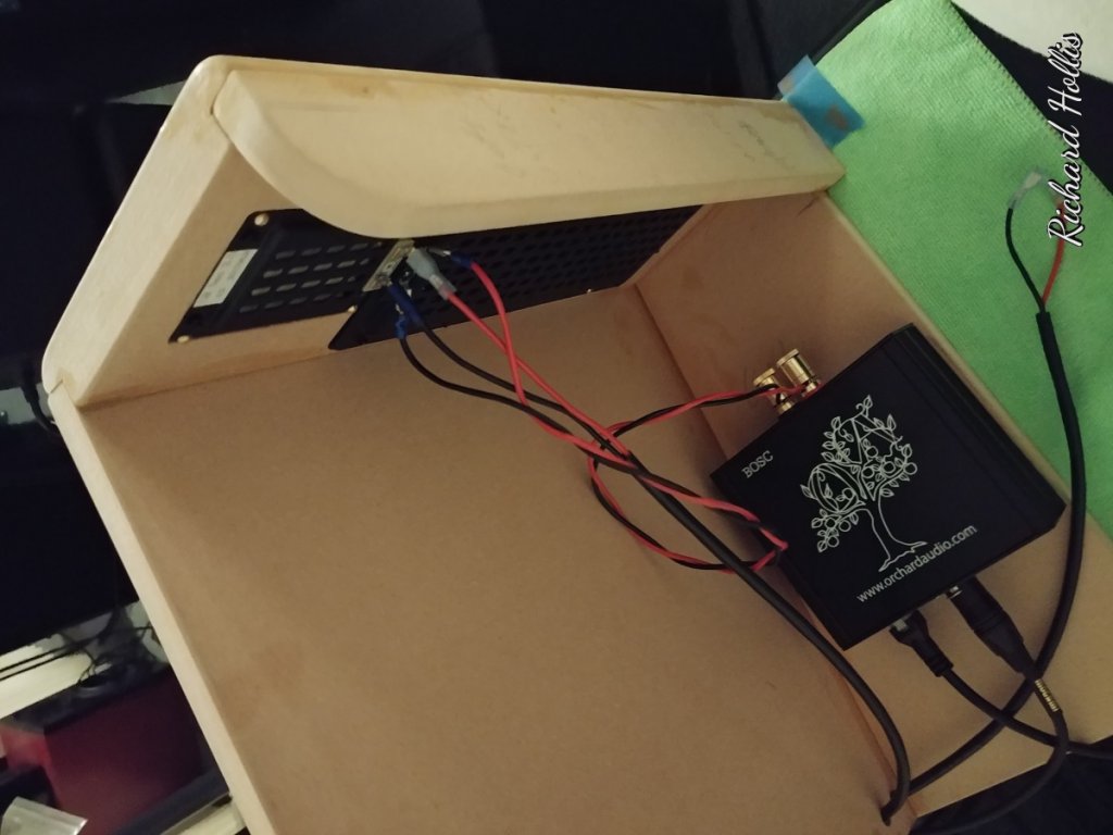

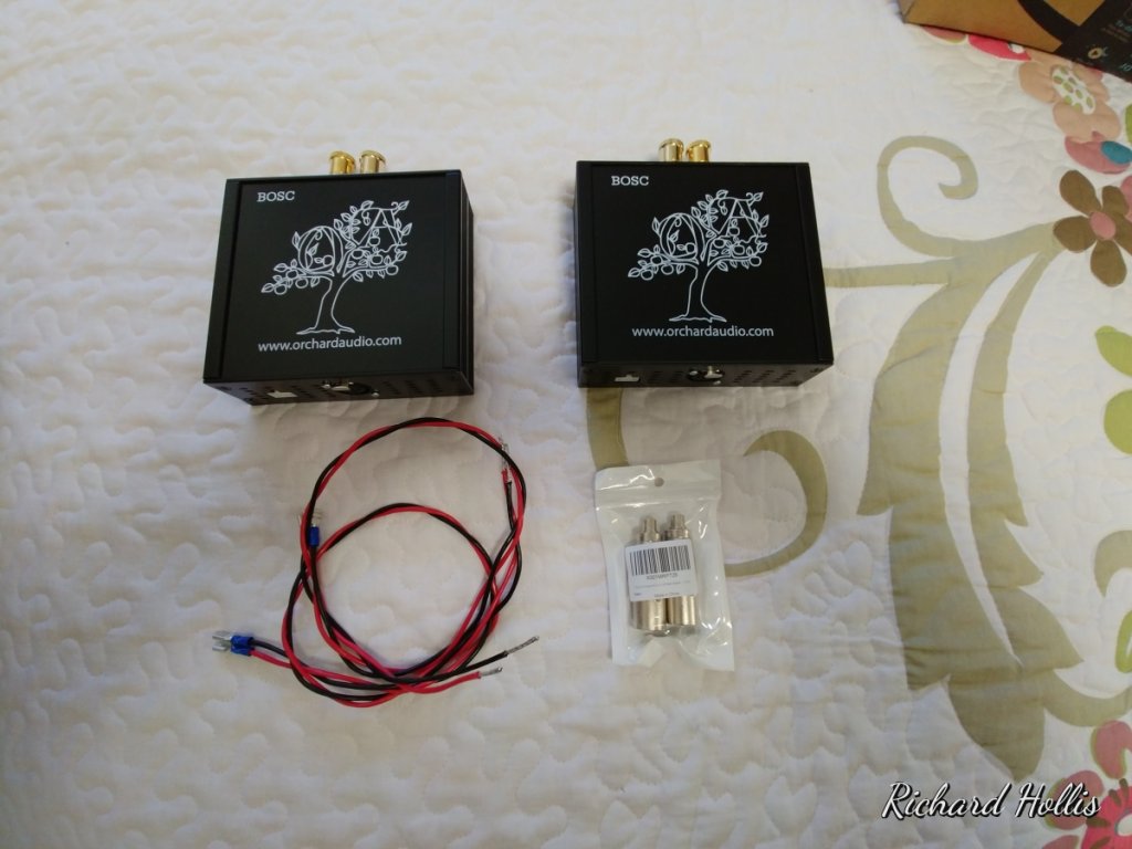

The Orchard Audio BOSC amps have arrived to demo with The Monoliths speaker system.  These will be the BG NEO10 driver amp in the system for trials.
Made a custom set of 2' speaker cables for direct connection to the driver terminals.
Balanced inputs on the amps, so easy connection to the dspMusik 2x8 digital crossover.

Love that the amp just fits right behind the drivers.  That's about as short a path for speaker wire that's possible.
