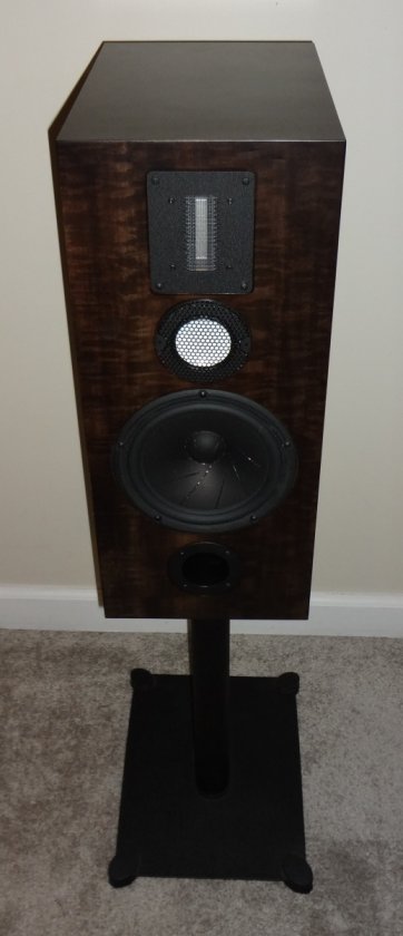

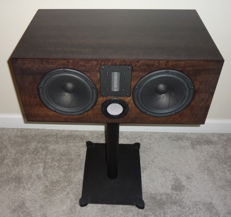

L/C/R and surrounds with Scan-Speak Revelator woofers, Accuton dome mids, and RAAL ribbon tweeters.

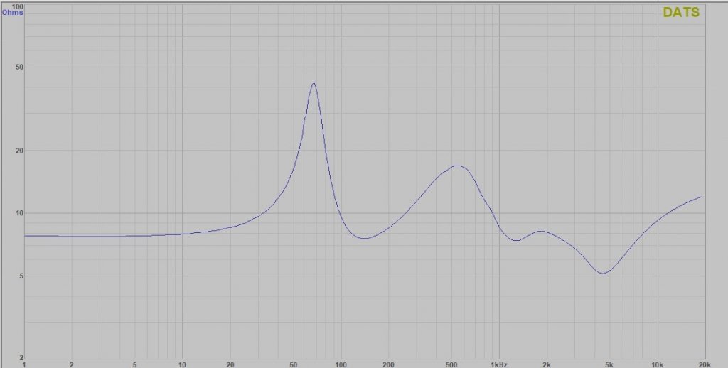

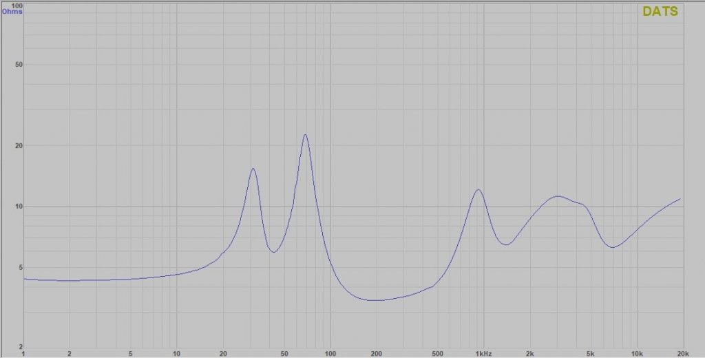

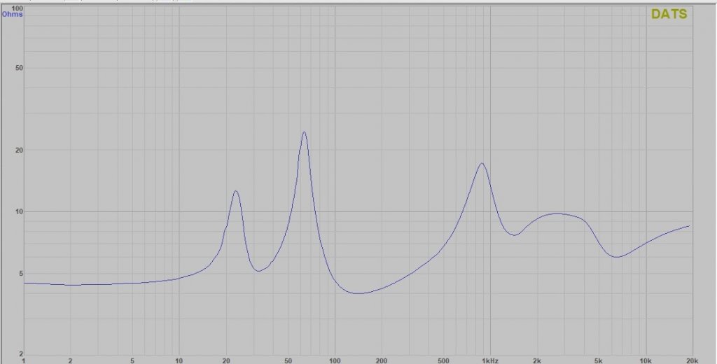

Impedance graphs...
CC
L/R
Surrounds

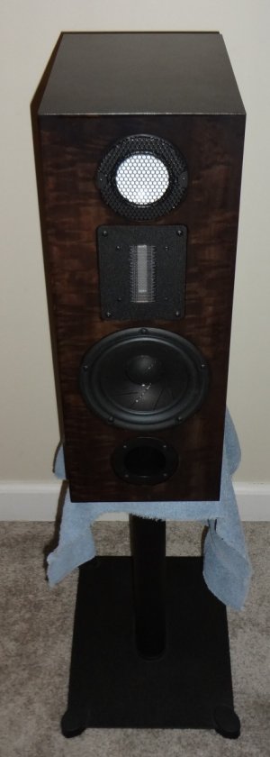

Rick,
What are the advantages and/or disadvantages of changing the positions of the midrange and tweeter? What were your intentions in doing this?
I'm not judging, mind you - just curious.

Rick,
The owner requested that in order to have the surround tweeters closer to his listening angle. Once I complete the measurements I can comment more of the difference. The surround woofer is smaller than the L/R and that makes the inversion easier to do with the crossover.

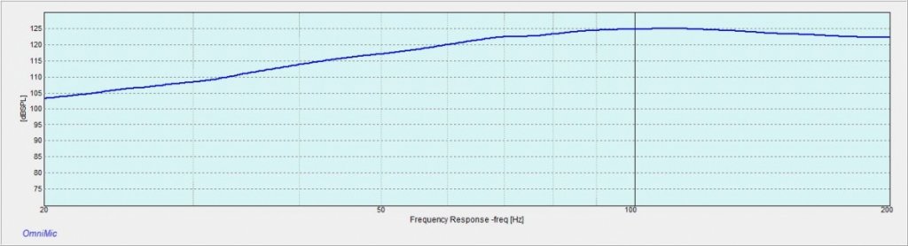

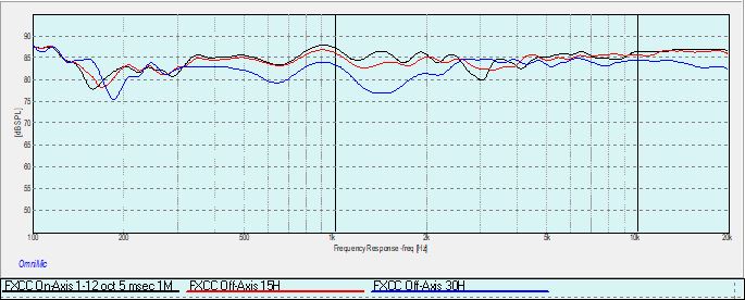

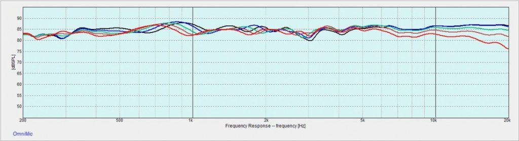

Center channel response graphs, both vertical and horizontal, as well as the nearfield bass response.

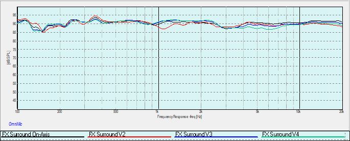

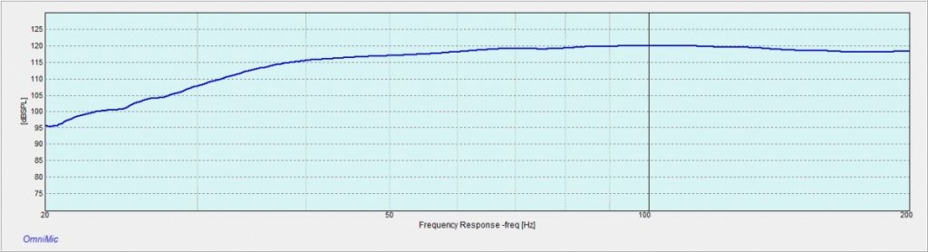

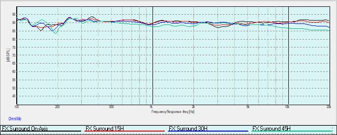

Surround graphs...
On-axis and 15,40,45 degrees off-axis horizontally.
Vertical Reponse (V1/on-axis, V2/woofer axis, V3/midrange axis, and V4/above the midrange (2") from 40" distance.
Nearfield bass response summing the woofer and port responses together.

« Reply #8 on: 26 Sep 2019, 03:28 pm »
Rick,
Here's the on-axis and horizontal response.
