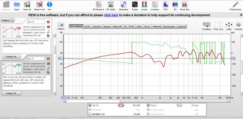

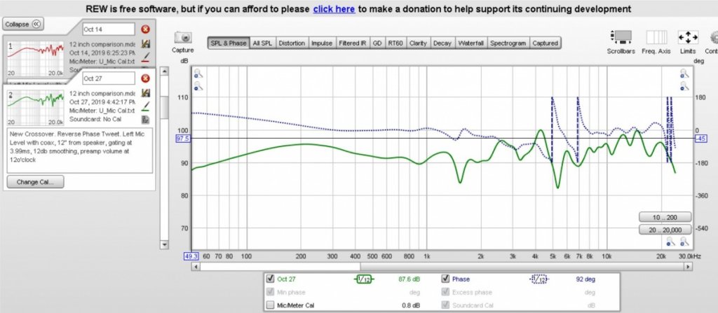

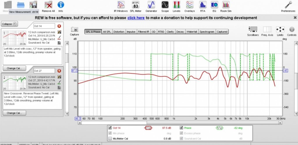

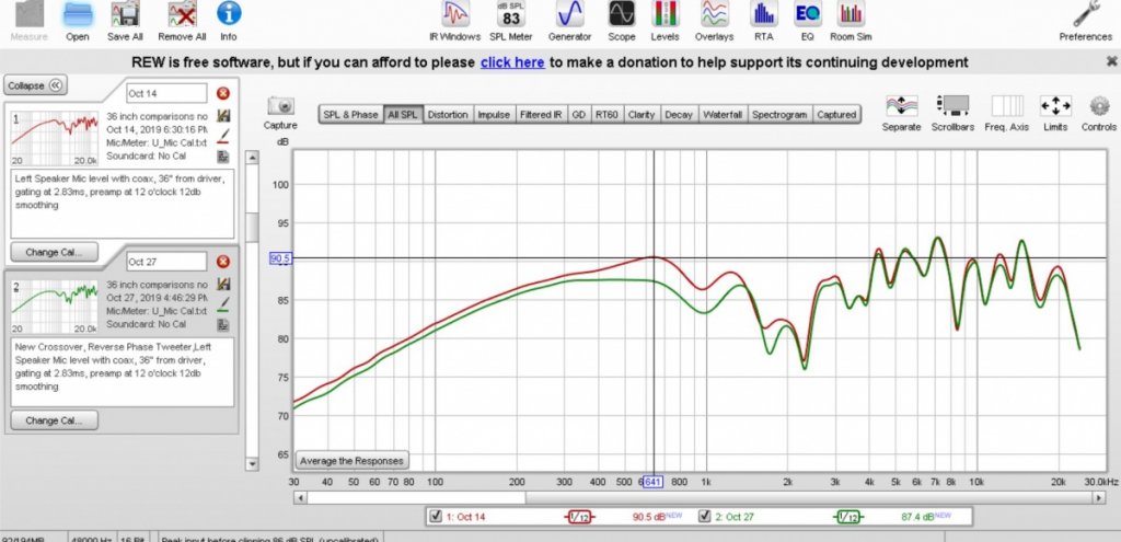

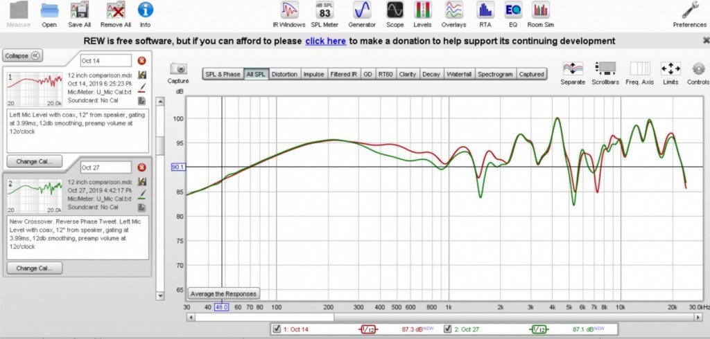

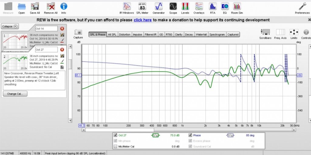

So here are some measurements I took before and after the crossover change. These were taken using REW at 1 foot from the speaker and three feet from the speaker in plane with the coaxial driver setup. The measurements shown are gated in order to cancel out room reflections. While this is probably far from perfect and I am no expert in this I wanted to have a baseline so I could tell what was occurring. The drop in the bass driver is evident in the measurements and the tweeter seems to be performing nearly identical to how it was performing before the mods. The interesting thing to me is the Phase changes. I know less than nothing about what this represents and would love to hear some analysis from the community. On the surface it looks cleaner than the original phase plot but based on how I measured it may be meaningless. I plan to do some research into the subject. The plots are pretty well labeled but if you have any questions id love to dialogue a bit about the results with anyone who cares to comment. The images in order are 12" measurement original xover, 12" measurement new xover, 12" measurements compared. Followed by 36" original. 36" new, 36" compared.
