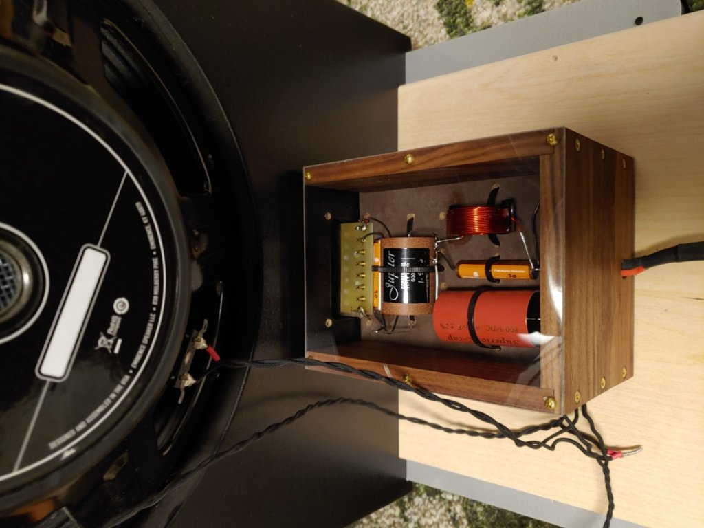

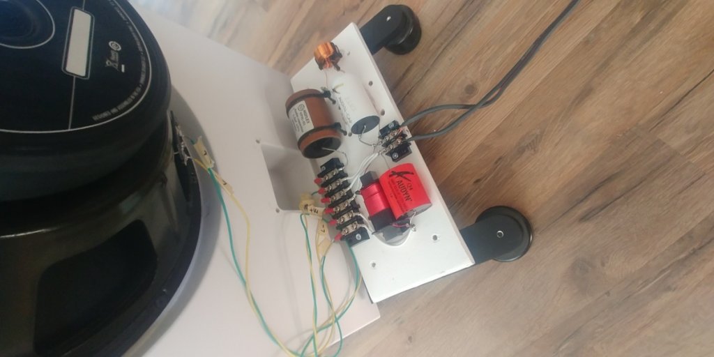

M4 Turbo S. Nothing elegant...just plugged it in to see if it works. Settling in as I type. I went with Miflex (the cheaper version) and an assortment of Intertechnik capacitors, kept everything else the same. Used terminal blocks for ease of future tweaks, if desired.

Very nice Dakotaconcrete. May I ask the Approximate Price for your Tweek / Upgrade? What if anything did you notice with the sound.

As I mentioned, I decided to rebuild the crossover entirely, so I purchased all 6 components (1 resistor, 2 inductors, and 3 capacitors). I think that each crossover cost around $100 each, this includes the board, rubber feet for the board, zip ties, etc. The 3 components I changed were the capacitors, in the 6.8 uf spot I used an Audyn Cap Plus, in the 1.5 uf spot I used a Miflex KPAL, and in the 33 uf spot I used an Audyn Q4. The size of the capacitors necessitated external placement.
In addition, I pulled the trigger on a pair of Path resistors last night, and they're around $23, each.
For sound, I probably have less than 10 hours on them, and from what I've read, they're likely not at equilibrium. Regardless, I am terrible at describing sound and don't really trust my memory with the original crossover sound. I generally approach these changes skeptically with the outlook that it could be an improvement. I can say that it hasn't hurt the sound in any way. Part of me does feel like the soundstage improved in the x and z axis, and vocals have greater presence.

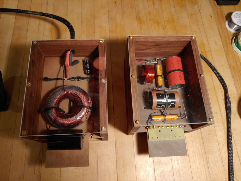

I have completed the rebuild of my crossover for my M3TM's. I may have gone a little overboard by replacing everything all at once but in the end I figured if I ever wanted to move up the Spatial Audio ladder I would want the original crossovers intact. The components are so tightly packed in there getting them out would really be a chore let alone the idea putting them all back in. The two components I did not upgrade but I did re purchase were the cap and resistor in the Zobel Network. Id like to share some picture first then ill share some measurements and impressions. Please note this is just a hobby of mine and like most of you out there the science behind it all escapes me. I welcome any and all input and observations.

My original idea was to have the crossovers sit in position like Dakotaconcrete did with his/her crossover hence the little tongue that comes out the front of the case. I even built a cork foam and wood platform for them to sit on. Even with the platform I noticed there was still quite a bit of vibration I could feel in the case. I'm still not 100 percent set on my speaker placement so I though the ability to move them around with the speaker would be nice. I have since move them onto the floor. Whether or not it makes any sonic difference I cannot tell you but the vibrations have been reduced dramatically. FYI I have also place my speakers on SVS isolation feet to help isolate them from my tubes.

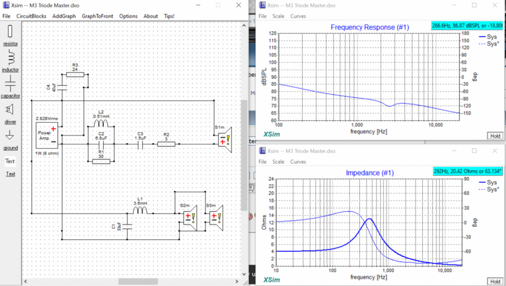

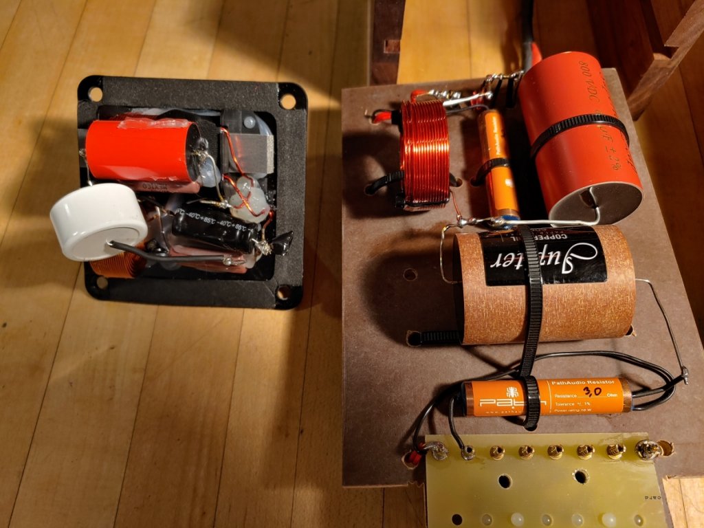

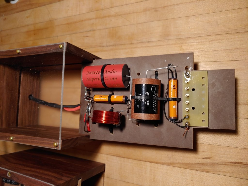

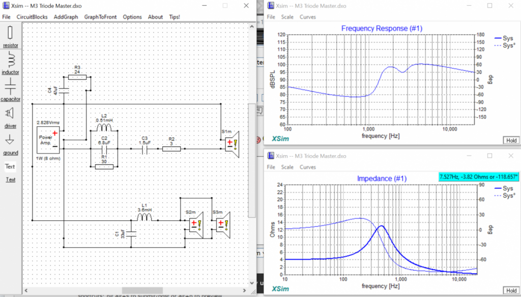

The first image shows the left crossover upside down showing the Bass section and the Zobel Network. The right image is right side up showing the crossover section for the tweeter.
I put most of my money into the components in the signal path. In the bass section I went with the Jantzen C-Coil on Clayton's suggestion. For the tweeter I replaced both the resistors in the signal path with Path Audio resistors. These are highly recommended by just about everyone as the resistor to use if you have them in your signal path. In my research the Path resistors appear to favored over even the Deulands. For the main capacitor in the high section I went with the Jupiter Copper Wax Paper. This was the one I hemmed and hawed the most over. In the end it came down to a matter of Sonicraft having them on sale bringing their price closer to the Milflex which was my runner up choice.
The tweeter has a parallel notch filter in the first stage of the crossover. After reading up on this I learned that it creates a dip in the frequency response over a targeted range. Using XSIM it appears to create a 10db dip centered around 2.5khz.
Some of you may have noticed that the tweeter is wired out of phase. This means that the positive terminal of the tweeter is wired to the negative output on your amp. According to Clayton this helps to time align the tweeter which is attached to the back of the woofer.  If you place the the woofer in phase in XSIM you get a very respectable looking plot. When you reverse the phase all hell breaks loose. Perhaps some of you out there with real knowledge can comment.

The parallel notch filter confuses me a bit as I cant find any info on what components are actually in the signal path. I understand what each component does but I figured the resistor was the component the signal carries through while the cap and coil shape it. The Path resistor seemed like the best choice based on this assumption. I went with a mid level but highly regarded cap here and a slightly larger ga./lower ESR coil than the original. Would be curious to hear how some of the more knowledgeable members of the community feel about the importance of quality components in these positions is.

I had made comments in the past on my crossover upgrade of the M3TS--all positive. Have you talked to Clayton about the dip? I would imagine he's the one to talk to.
